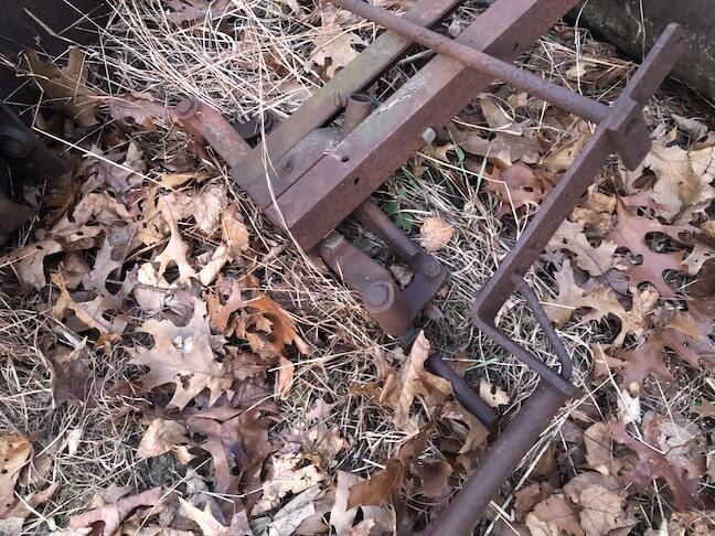

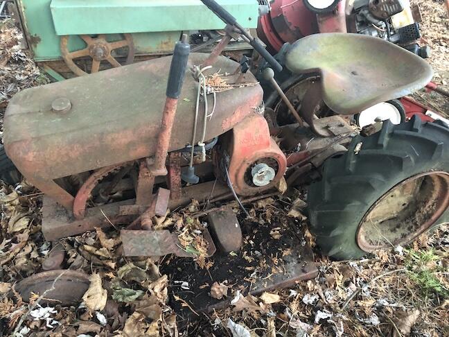

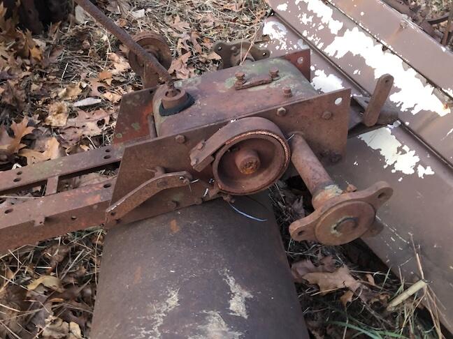

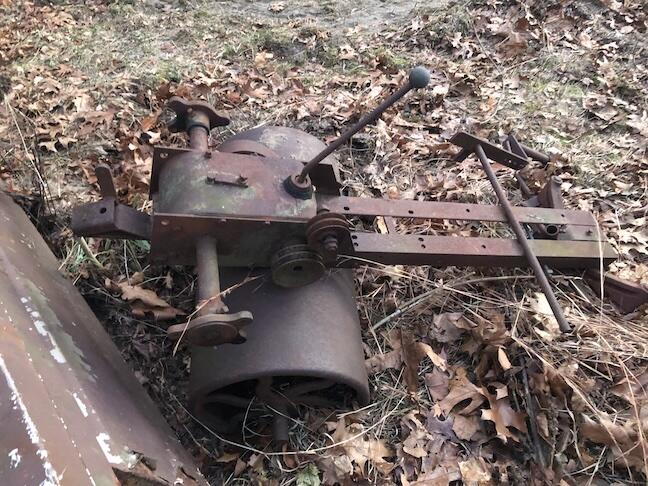

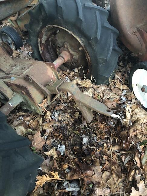

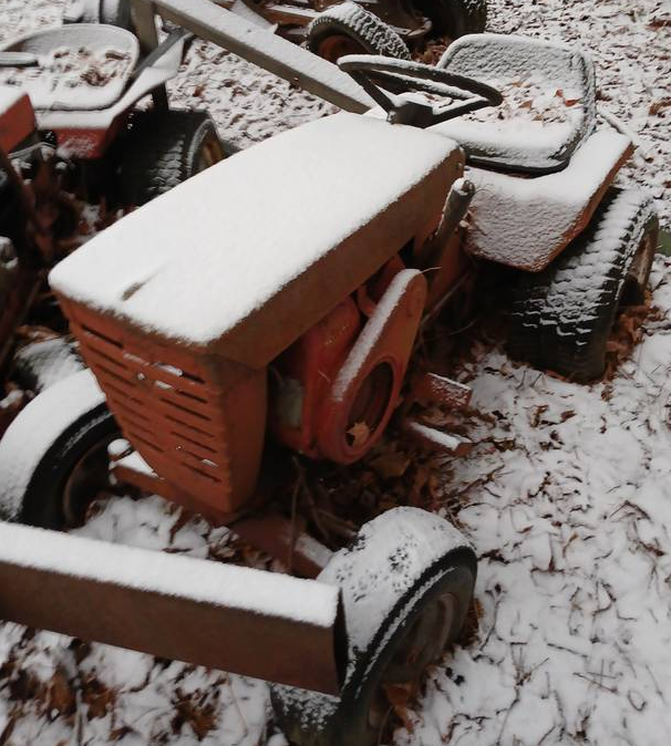

Handy Don 17,554 #1 Posted January 3, 2025 (edited) Last week I noticed a Craigslist ad for “old lawn and garden tractors”. The ad pictured a couple views of a boneyard but there were at least two Wheel Horses. Nothing that tickled my fancy and I’d just resolved not to start any new projects I’m unlikely to finish. (Someone else on the forum noticed the ad and posted it here but I think it got admin removed). Today, though, I got to thinking that maybe there was something there of value I could help someone else put to use so I decided to take one for the team and drive 45 minutes each way to look it over. I’m glad I did. The seller has been contracted to clear the lot over the next couple of weeks. Whatever doesn’t sell goes to scrap. According to him, he’s already taken two loads of push mowers with busted decks and seized engines as well as some trashed tillers. EVERYTHING here has been left outdoors for years. I’m not an expert, but this looks to be Suburban or 400? The tires are rotted out and all four rims are rusted through. The hood is in surprisingly good shape and it has the dual slots for throttle and choke as well as a tiny toggle switch. Gas tank is in place. I’m not sure this is an original seat, but it is in great condition. The engine won’t turn but it has a carb--some corrosion and rust but I’ve seen worse. The clutch mechanism is there as are both footrests. The frame seems complete, including front axle, tie rod, and steering but the steering wheel has some of its plastic missing. The gearshift is stuck and I didn’t want to force it. The rear wheels were too embedded in the ground to move to see if the rear axle would turn. There is a mower deck under there and the slot hitch has some sort of adaptor in it. Sorry, I forgot to get the transmission casting numbers. The other useful find was this frame. This time I DID get the casting numbers (below). This transaxle seems pretty good--shifter works and the diff works. I didn’t try to turn the input shaft because the brake seems rusted to the drum. Front axle is there with spindles, tie rod, and the steering socket but no other steering parts. Slot hitch is one of the welded style slots. Elsewhere were a C-111 and what looked like an S/G 8hp from 66-70--maybe an 856 or 857?. The C-111 is in poor condition overall but the B&S looked salvageable. The 8hp tractor is in slightly better shape, (3-speed, flip rear seat, hood latch near the steering wheel and chrome hood ornament). Both seem more or less complete and have flat tires with rot showing. I didn’t go over these closely. (Picture from the ad) The only other WH items were a 32” geared mower deck from a Lawn Ranger (or possibly for the frame-only Suburban, RJ, or 400?) and one 36” geared deck, probably from the 856/857. Neither was in good shape--maybe usable for parts. Also on the lot: a Bolens 850 tube frame, an Allis Chalmers B10 and its Simplicity twin, and part of an old Speedway (the hood, frame, and seat). As well, loads and loads of sad push mowers with B&S engines (most with the heads removed?) and boxes of plastic mower wheels. There was a 6’ ride-on disk harrow. Tires and rusty wheels. Sticking to my resolution, I didn’t bring my trailer and so I didn’t bring anything home! The seller made it very clear that he’d like to see things put to use so pretty much any offer reasonably more than scrap value he will take. He said he’d leave the WHs until last to give me time to share this and see If anyone wants to pursue this, I might be able to lend a hand. PM me, we’ll exchange numbers and speak. Edited January 3, 2025 by Handy Don 9 1 Share this post Link to post Share on other sites

WHX?? 58,297 #5 Posted January 4, 2025 Definitely a 400 first pic ... 23 hours ago, oliver2-44 said: solid seat pan, Suggests an early one. Even appears the ID plate between the levers is still there. The shape of anything does not matter ... Like Ollie said it's the parts there that does which can be used to save others. Truth be told the 400 looks very saveable. On the square hood Don I must chastise you for not snapping a pic of under the dash ... you know what is there! Your only viable excuse is you were too busy loading it up. Tranny casting numbers don't matter ... just shoot we'll check for horns later. On 1/2/2025 at 7:47 PM, Handy Don said: just resolved not to start any new projects I’m unlikely to finish. Understandable but some of the stuff there will help a bro here to finish one. Hear tell they don't make them three piece transmissions any more. Next time you run across things like this we want you to think about that poor soul out in his garage slumped over on a unfinished Tractor. Found with a self inflicted 7/16 to the jugular because he couldn't find that bull gear to finish up dear old grampa Alfred's beloved RJ. Just sayin ... On 1/2/2025 at 7:47 PM, Handy Don said: He said he’d leave the WHs until last to give me time to share this and see If anyone wants to pursue this, I might be able to lend a hand. PM me, we’ll exchange numbers and speak. might be your salvation. Now somebody go get that stuff. That wrench to the jugular just might be me it goes to scrap! 2 Share this post Link to post Share on other sites

Handy Don 17,554 #12 Posted January 7, 2025 I saw that the square hood was still at the yard yesterday pending a pickup. It is an 855. The stuff I rescued is now in this classified listing. The suburban, the frame, and one mower deck. 1 Share this post Link to post Share on other sites

Handy Don 17,554 #18 Posted January 10, 2025 As an aid to whoever gets this tractor, I went over it today and liberally dosed every joint and fastener that I could get at with one of my go-to penetrants, Liquid Wrench. Also, did some cleaning (a more thorough job will await non-freezing weather--maybe Monday.) Made some discoveries, too. The shifter loosened right up for fore-aft moment and, without forcing, a smidge into the four gear positions--promising! The input pulley still doesn’t turn. I’m thinking to find the plug, drain the transaxle, and then fill it with diesel or Mystery Oil to soak. One rear wheel’s hub is loose on the axle. There is small differential movement from one wheel to the other. After removing the remnants of the front tires, the front wheels spin easily and one tube seems usable! The rear AGs, after jacking the rear up to take the weight off them, actually started returning to shape! Then, with the caked on crud removed, I realized they are NOT rotten--there is some cracking in one sidewall, but I think on good rims with tubes, they are probably usable! The steering is stiff but moving down to the fan gear at the bottom. The steering collar, the tie rod linkages, and maybe the spindles will need some more soaking with penetrant. The mower deck is attached using the “stock” system of two long bolts through the frame. I plan to get this off so I can assess its condition. 4 Share this post Link to post Share on other sites
