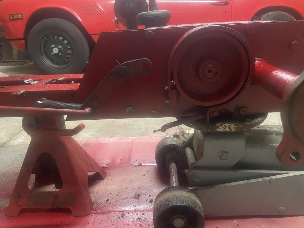

Achto 30,980 #2 Posted January 3, 2025 1 hour ago, Maynardb said: Hi im trying to reinstall the trans in my 401 and the brake adjustment arm doesn’t line up right. Here is a picture of the brake on my 401. 1 Share this post Link to post Share on other sites

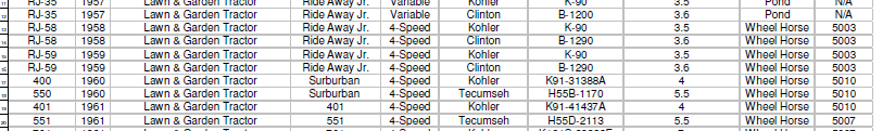

WHX?? 54,931 #3 Posted January 3, 2025 (edited) 6 minutes ago, Achto said: brake on my 401. Looks like he's got the 5003 tranny with the 90 brake tab. Not sure how the brake rod looks on those. I don't think you have the right one Maynard. Edited January 3, 2025 by WHX?? Share this post Link to post Share on other sites
Achto 30,980 #4 Posted January 3, 2025 14 minutes ago, WHX?? said: Not sure how the brake rod looks on those. Is that the same as an RJ58?? Got any pics of yours? Share this post Link to post Share on other sites
Achto 30,980 #5 Posted January 3, 2025 @Maynardb I think the rod from the peddle goes in the top hole and the rod to the band goes in the bottom hole. ?? Share this post Link to post Share on other sites

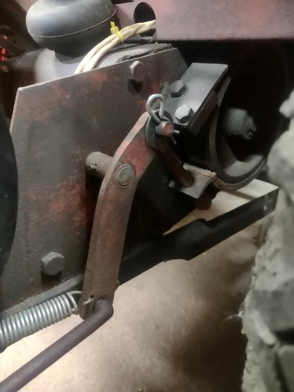

WHX?? 54,931 #6 Posted January 3, 2025 3 minutes ago, Achto said: Got any pics of yours? No all hidden by the tire or fender. I thought it had a 5010 tranny anyway... could be wrong Some one don't chime in I'll run down to the hauler and look. That's where it's winter quarters is. 1 Share this post Link to post Share on other sites
WHX?? 54,931 #7 Posted January 3, 2025 You sure that's a 401 @Maynardb ?? That tranny went out in '59. Share this post Link to post Share on other sites
Maynardb 19 #8 Posted January 3, 2025 (edited) I’m pretty sure it is. It has a Lauson H55 motor , but I figured it out anyway. Turns out the parts trans ( which this is mostly may be from an RJ 58 perhaps) does not have the same side cover. The location where the brake bolts to, is in a different click position than the original trans so I’ll have to switch side covers to set it up like original. thanks for checking in about it. Edited January 3, 2025 by Maynardb 2 Share this post Link to post Share on other sites

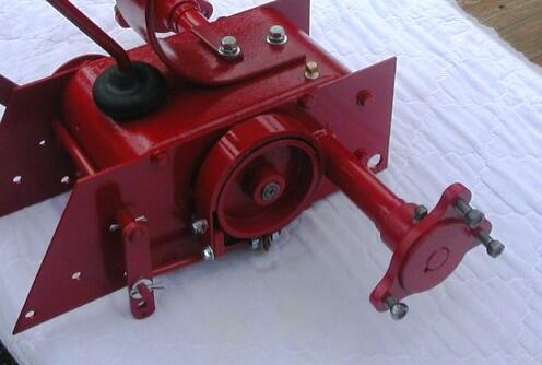

Racinbob 12,764 #9 Posted January 3, 2025 (edited) Definitely a 5010 linkage. Here's the 5003. Edited January 3, 2025 by Racinbob 1 Share this post Link to post Share on other sites
