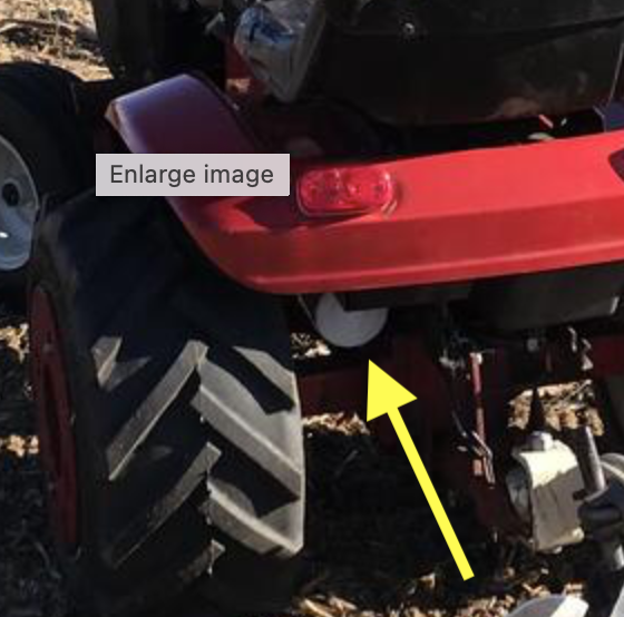

Handy Don 15,865 #13 Posted April 14, 2025 (edited) 6 hours ago, Andy T said: so I'm guessing its the 700 It is conceivable that the hydro is an 1100 even without a hydraulic lift. The less obvious determinants of a 700 are: - under the seat, peeking out of a hole in the fender pan, is the cap for the 700’s small, plastic oil reservoir (the 1100 uses the transaxle itself as its reservoir) - looking from the rear, there is NO cylindrical oil filter above the axle between the left rear tire and the transaxle (the 1100 has the oil filter). Arrow points to white filter here: Edited April 14, 2025 by Handy Don 1 Share this post Link to post Share on other sites
