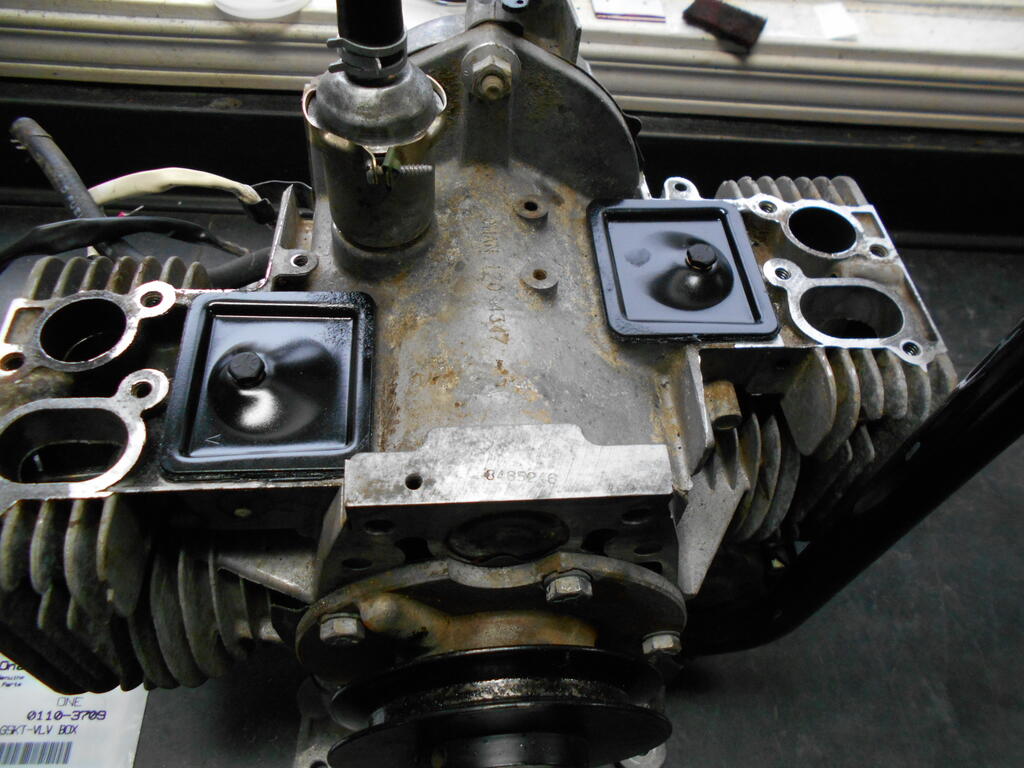

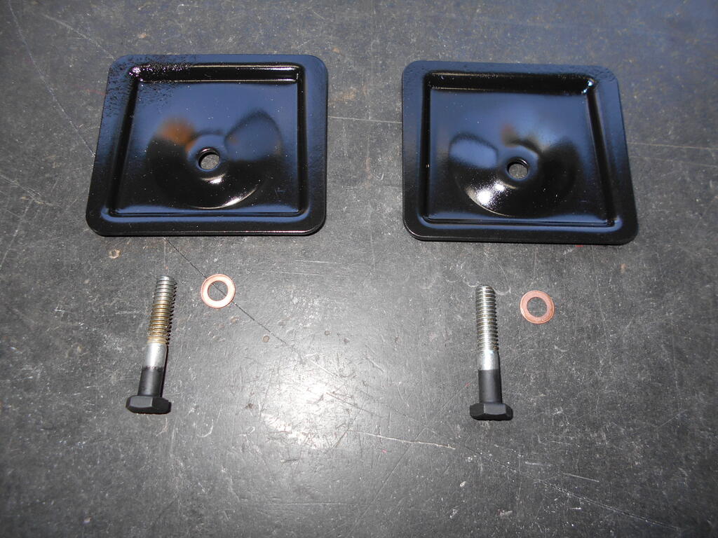

cleat 9,441 #101 Posted October 12, 2025 Valve covers and bolts bead blasted and painted. Sealing washers cleaned and sanded smooth. 3 Share this post Link to post Share on other sites

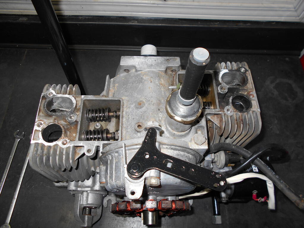

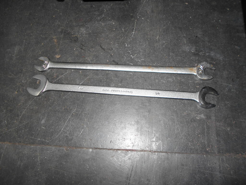

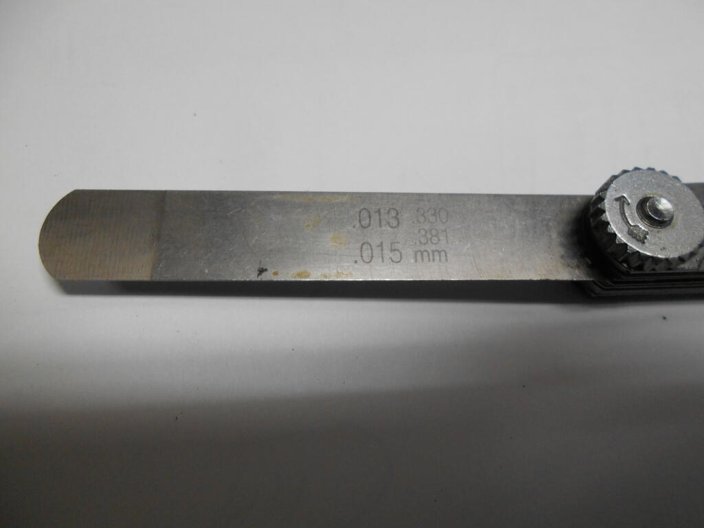

cleat 9,441 #102 Posted October 20, 2025 Valves were pulled and lapped until a nice contact pattern was established. Valve clearance set (0.005 intake, 0.013 exhaust) I used this stepped feeler gauge set that makes it so easy, just use the stepped down part to set gap and the thicker part should not fit in. I use these thin wrenches to adjust the tappets. 6 Share this post Link to post Share on other sites

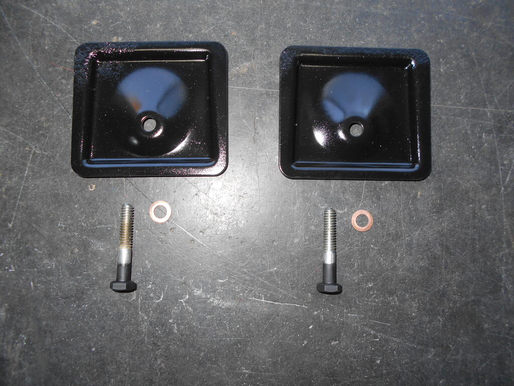

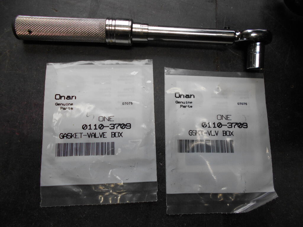

cleat 9,441 #103 Posted October 20, 2025 Valve covers installed and bolts torqued to 18 in/lb I used this 1/4" drive torque wrench and these gaskets. 5 Share this post Link to post Share on other sites

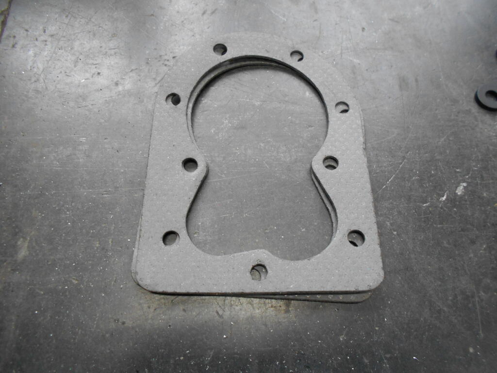

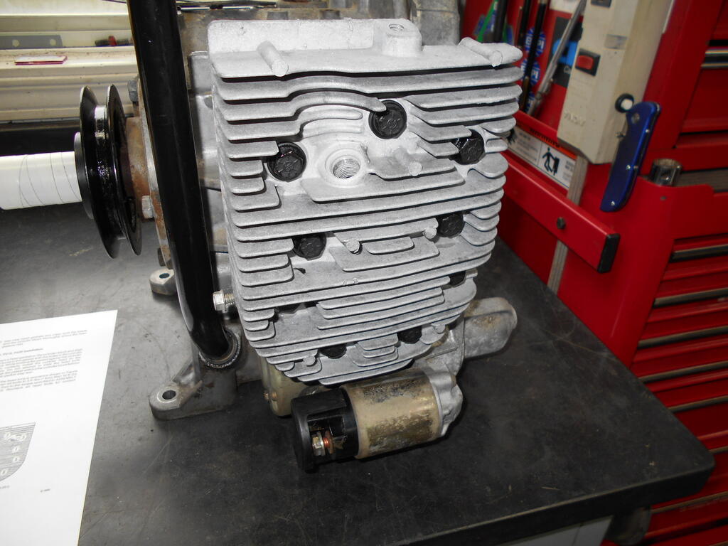

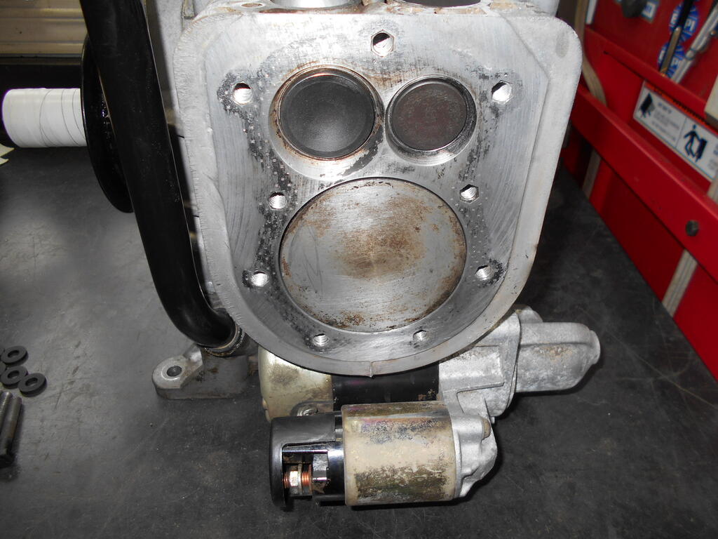

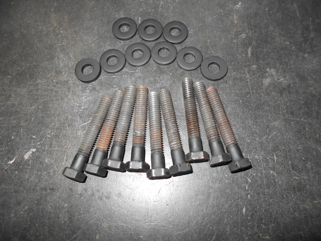

cleat 9,441 #104 Posted October 20, 2025 Block cleaned and degreased. I did not scrape too much as I was afraid of scratching it. Head bolt threads were chased with a tap to be sure they were clear for proper torque. Head bolts and gaskets ready. Head bolts were lightly oiled both on the threads and under the head then the head was loosely bolted on. Head was then torqued to 60 in/lb then 120 in/lb then to final torque of 160 in/lb following the sequence in the engine manual. 3 8 Share this post Link to post Share on other sites

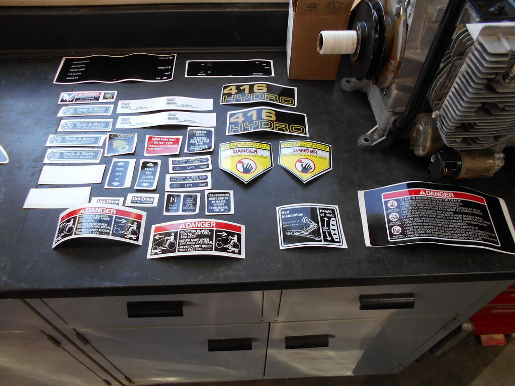

cleat 9,441 #105 Posted October 27, 2025 Terry's fantastic decals came in today for both this 416 and the 42"RD deck I refurbished this past summer. My tractors would be so incomplete looking without Terry's decals. Thanks again Terry. 8 Share this post Link to post Share on other sites

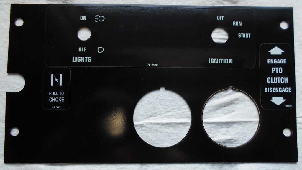

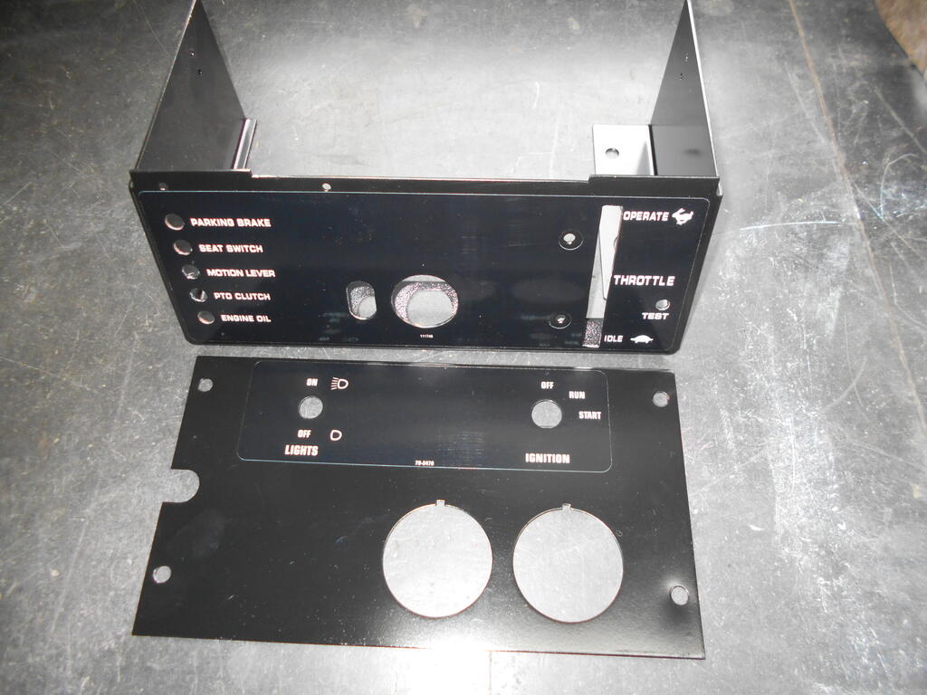

cleat 9,441 #108 Posted November 1, 2025 Hood-stand plate and console decals punched and applied. 2 3 Share this post Link to post Share on other sites

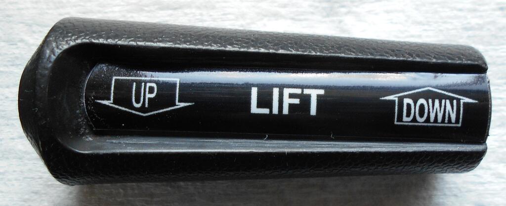

cleat 9,441 #109 Posted November 2, 2025 Hood-stand plate decals fully applied. Hydraulic control handle grip decal applied after filing the grip nice and smooth where the decal goes (it had slightly raised areas where the old lettering was). 4 3 Share this post Link to post Share on other sites

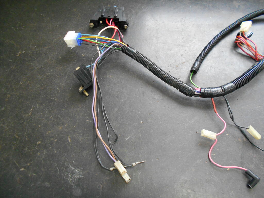

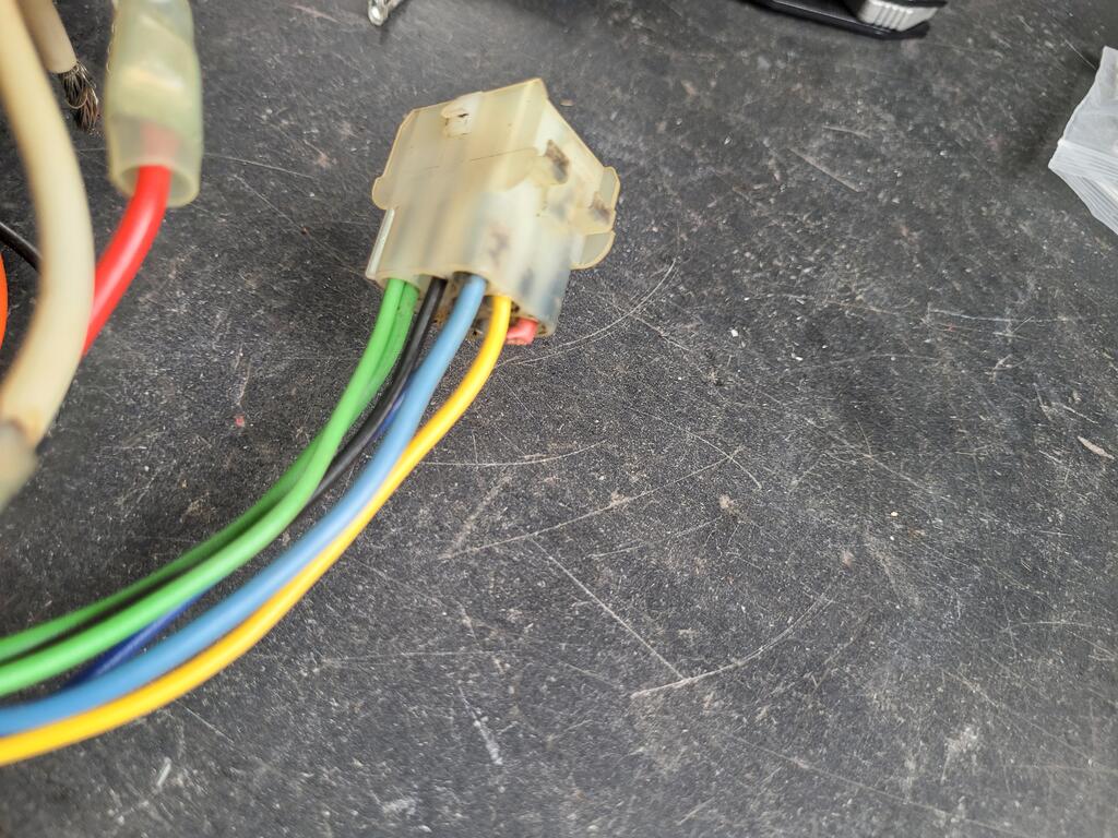

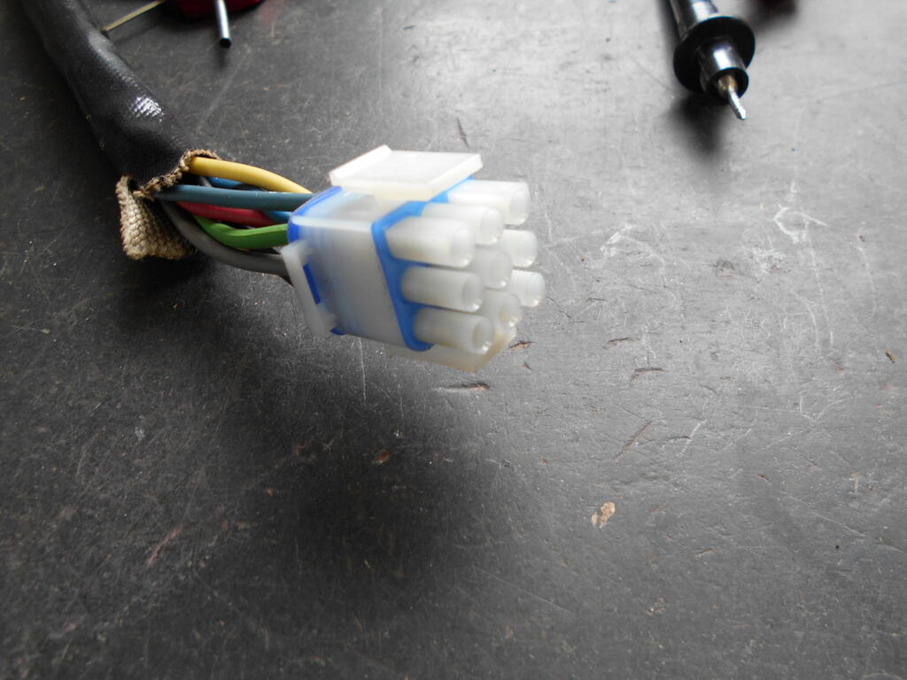

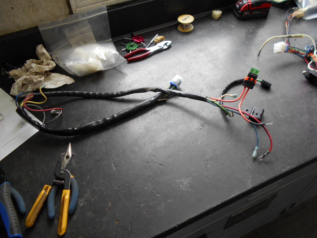

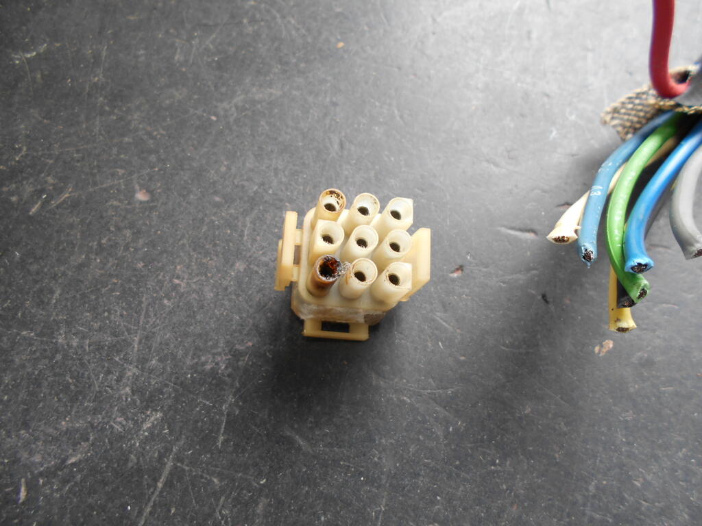

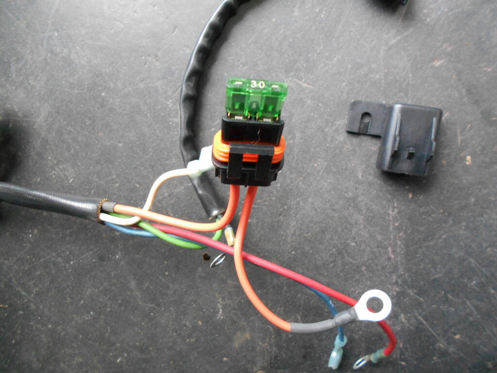

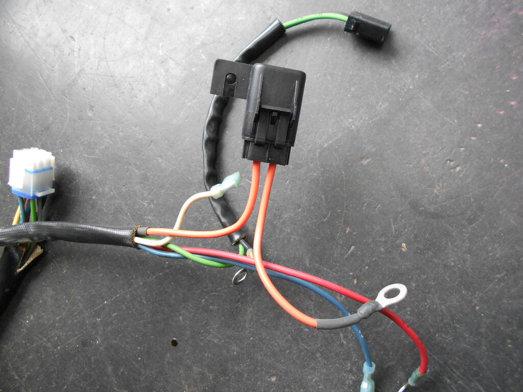

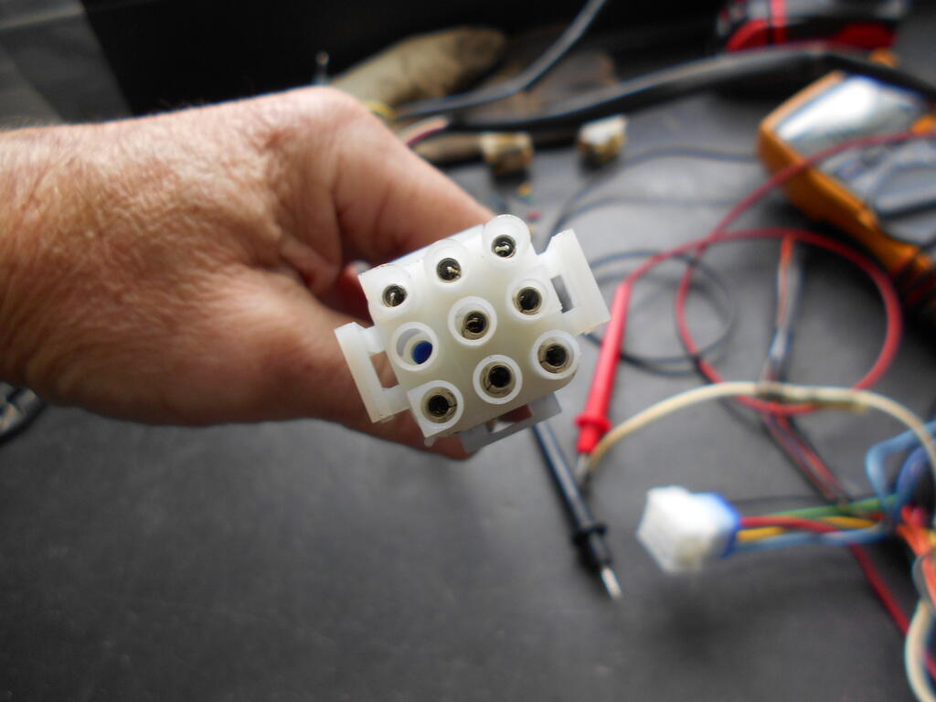

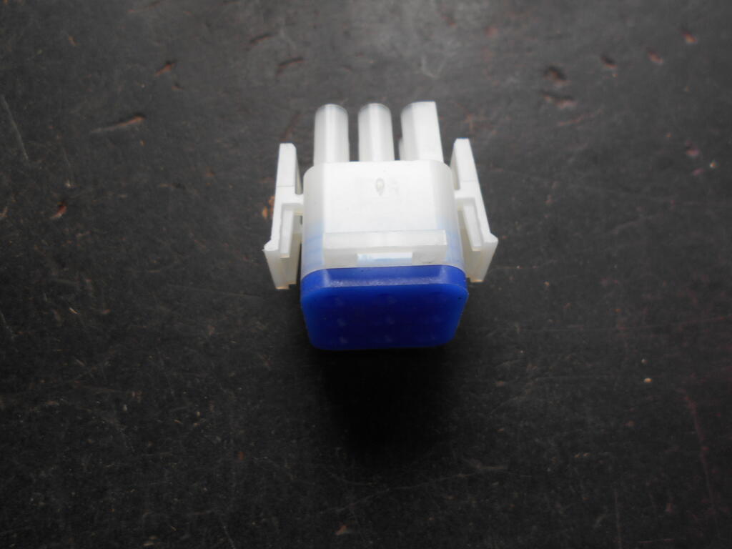

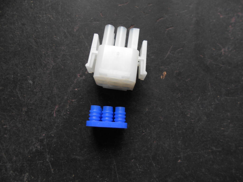

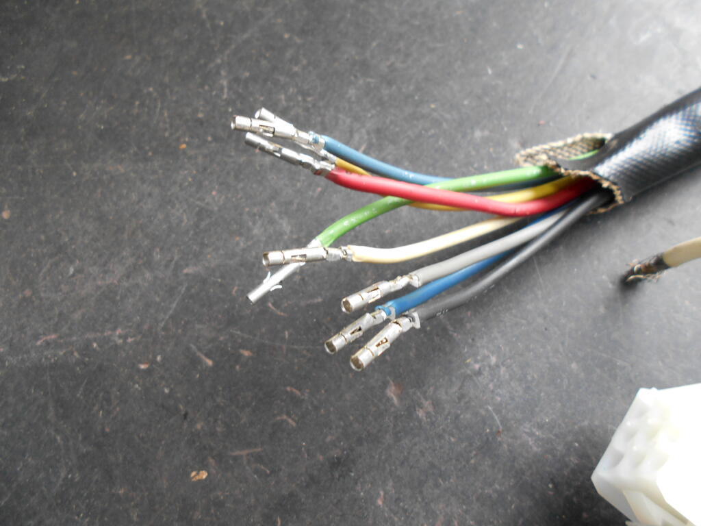

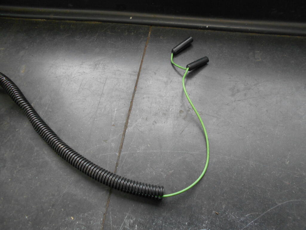

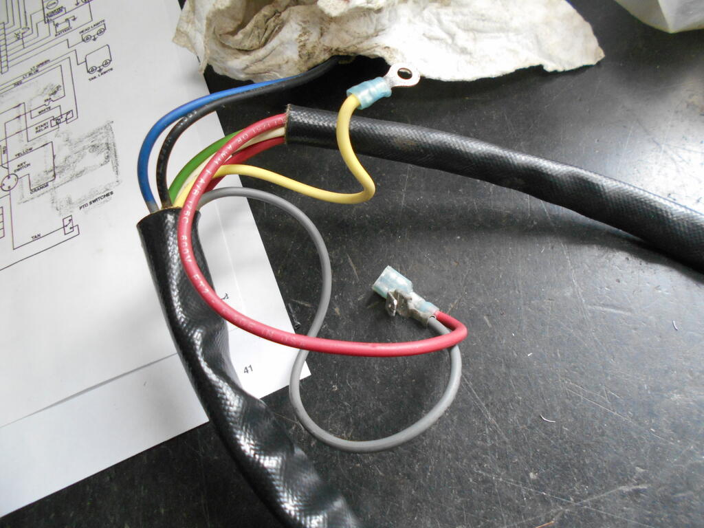

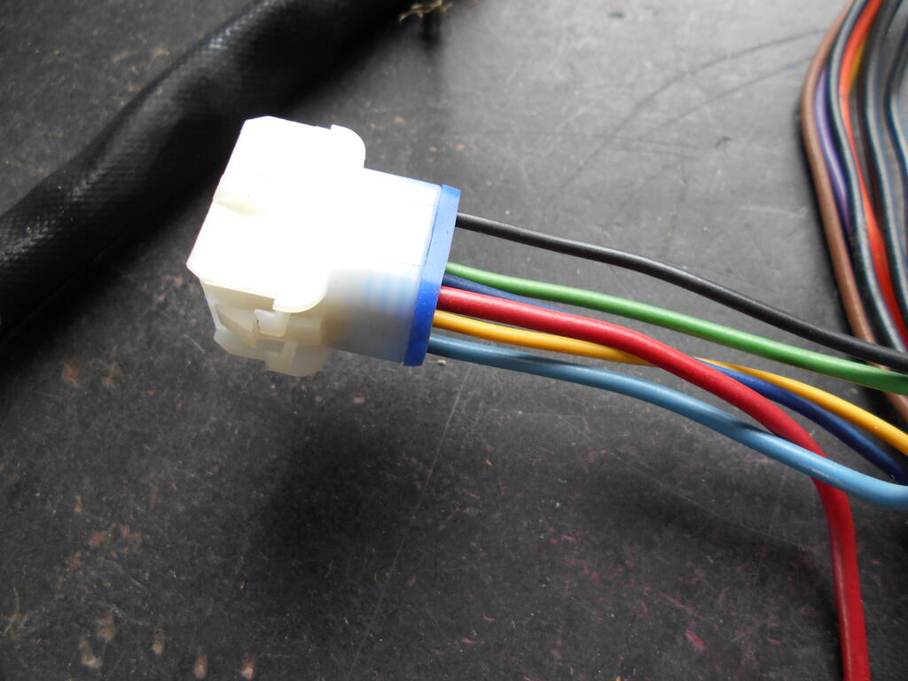

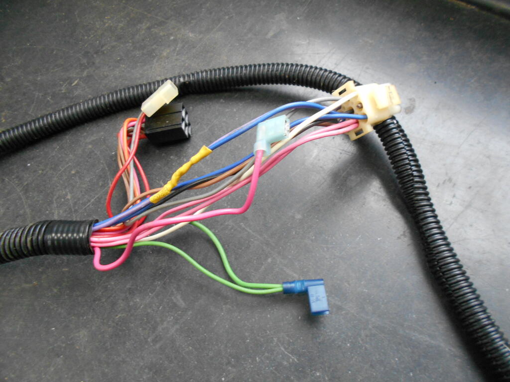

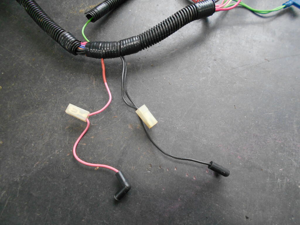

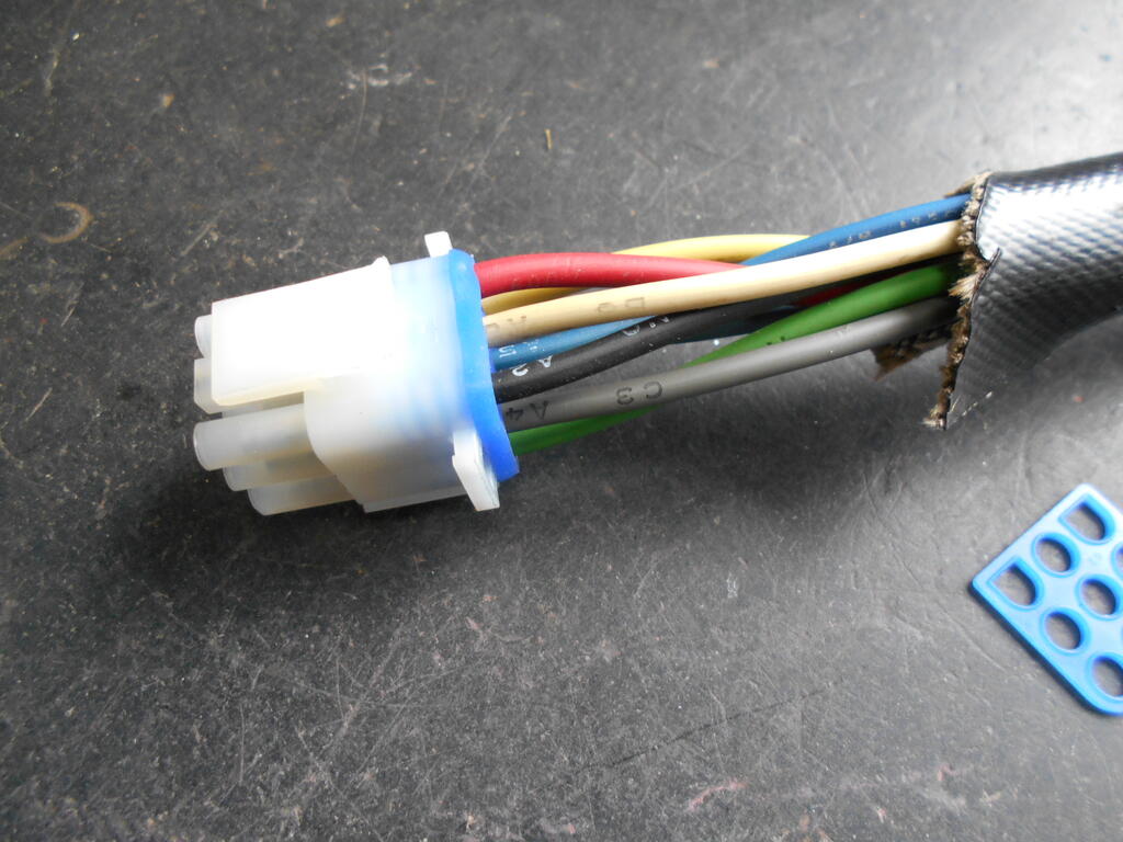

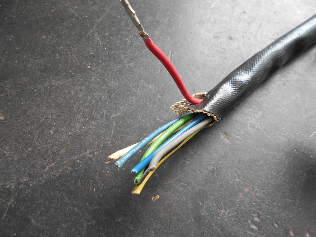

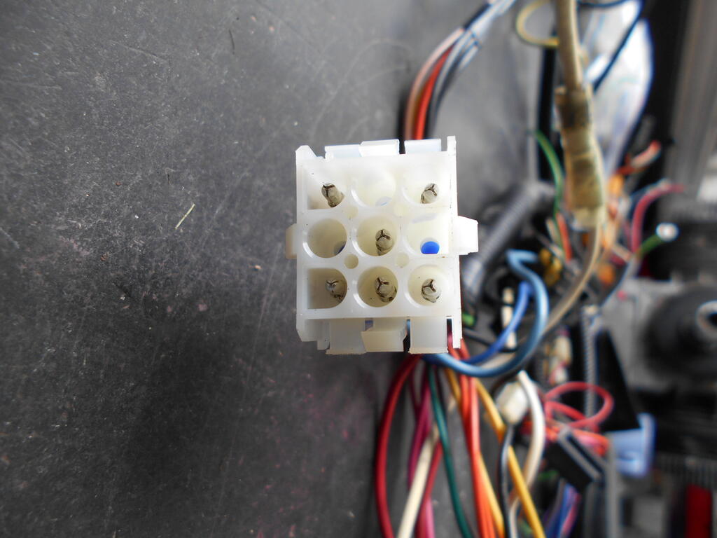

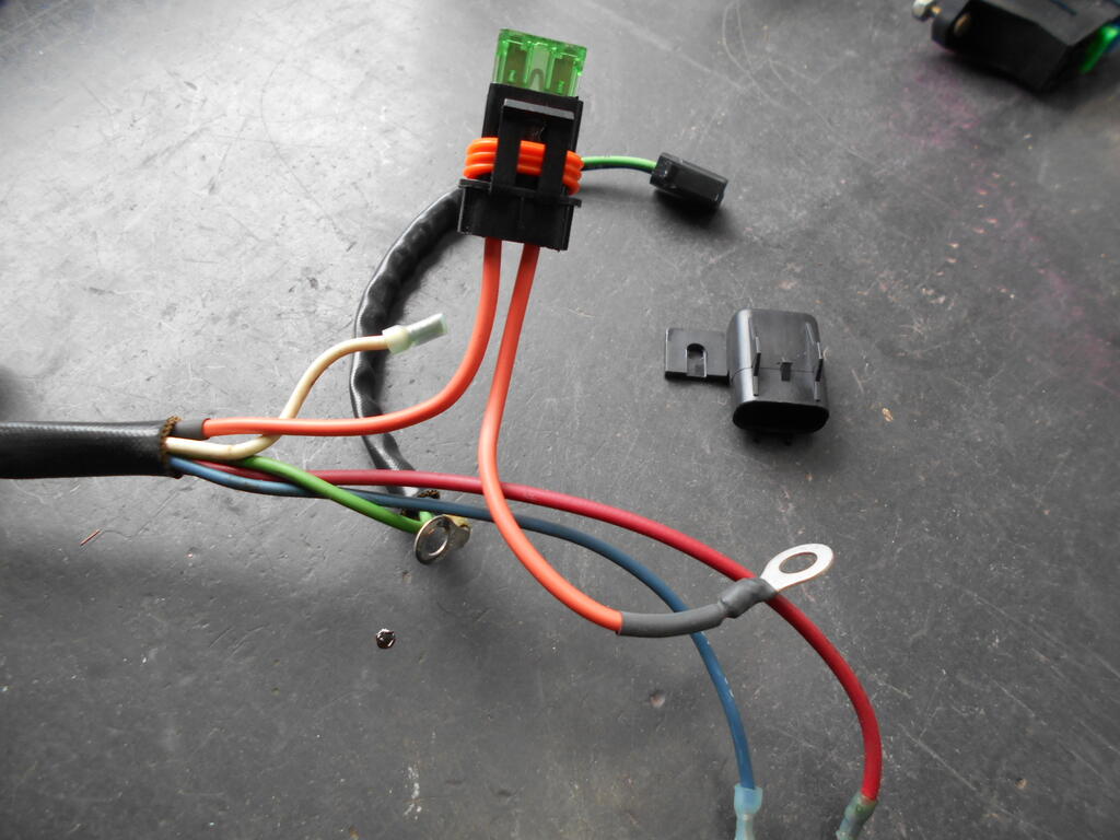

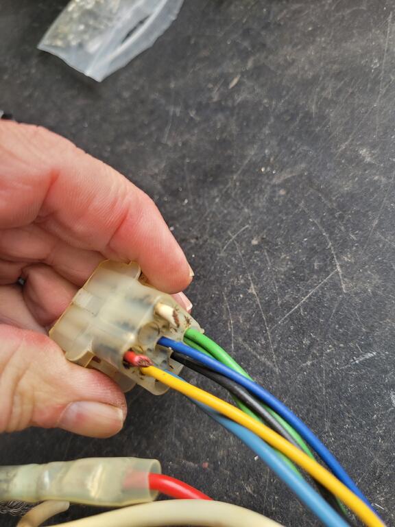

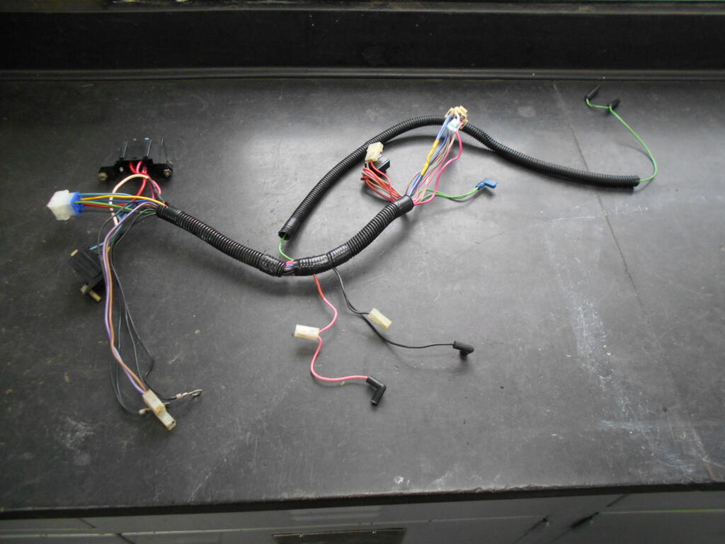

cleat 9,441 #113 Posted November 15, 2025 (edited) Today I thought I might as well fix up the wire harnesses for the tractor and engine. I use these sealed 9 pin connectors that I sourced on ebay. They are the same as the OEM connectors but use seals on the wires and a gasket between the connectors. 9 pin connector cut off of engine harness. One new terminal installed. All new terminals installed. 9 pin connector on engine harness complete. Of course I removed the charge wire from the 9 pin and routed it to the battery cable connection at the starter solenoid through a sealed 30A fuse. Now onto the tractor wire harness. here is the way the 9 pin looked when removed. 9 pin on tractor harness replaced. Now I modified the wire harness to suit me. Seat switch has been removed due to my getting my butt off of the seat on steep hills so I can't use it. Neutral switch has been removed because my foot control returns to neutral position automatically Parking brake switch has been eliminated because I can't push down the foot control pedal with it on anyways. Here is the harness complete and ready to be installed. Edited November 15, 2025 by cleat 1 9 Share this post Link to post Share on other sites

pfrederi 21,342 #115 Posted November 16, 2025 Nice work but too much electrical stuff for a garden tractor... 20 WHs no 520s 3 Share this post Link to post Share on other sites
cleat 9,441 #116 Posted November 16, 2025 47 minutes ago, pfrederi said: Nice work but too much electrical stuff for a garden tractor... 20 WHs no 520s This one is a 416 so definitely a simpler harness with only an hour meter and a volt gauge. I must admit that the GT1600 and 312 harnesses are simpler yet. The 520's are a bit more complex but I do like looking at all the gauges. 5 Share this post Link to post Share on other sites

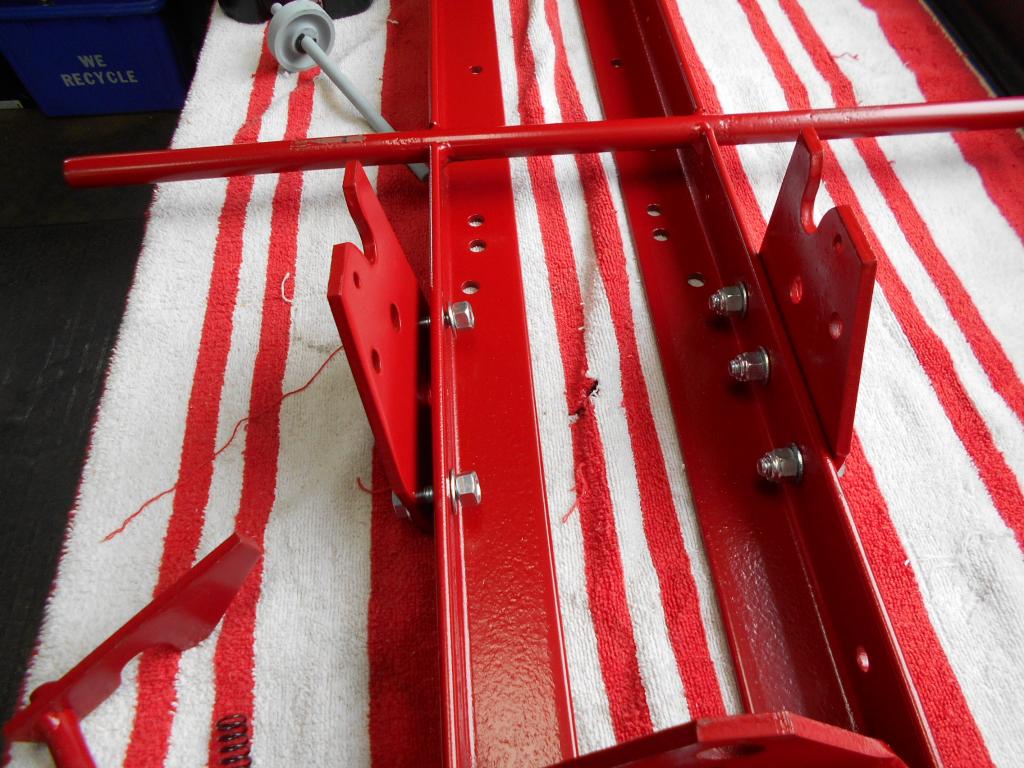

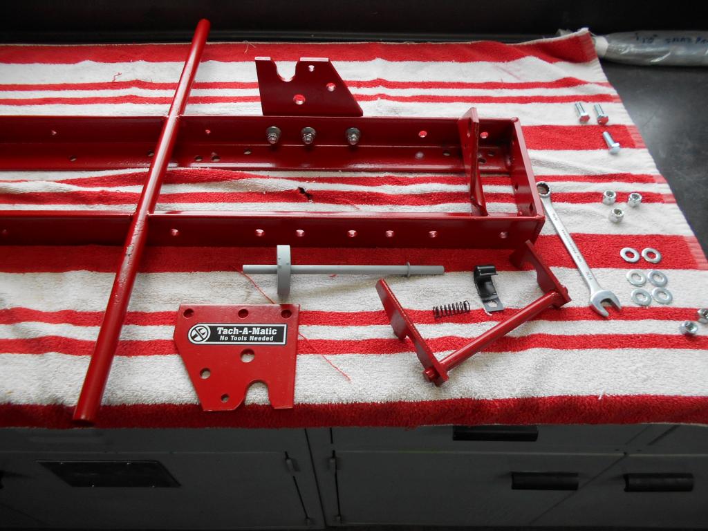

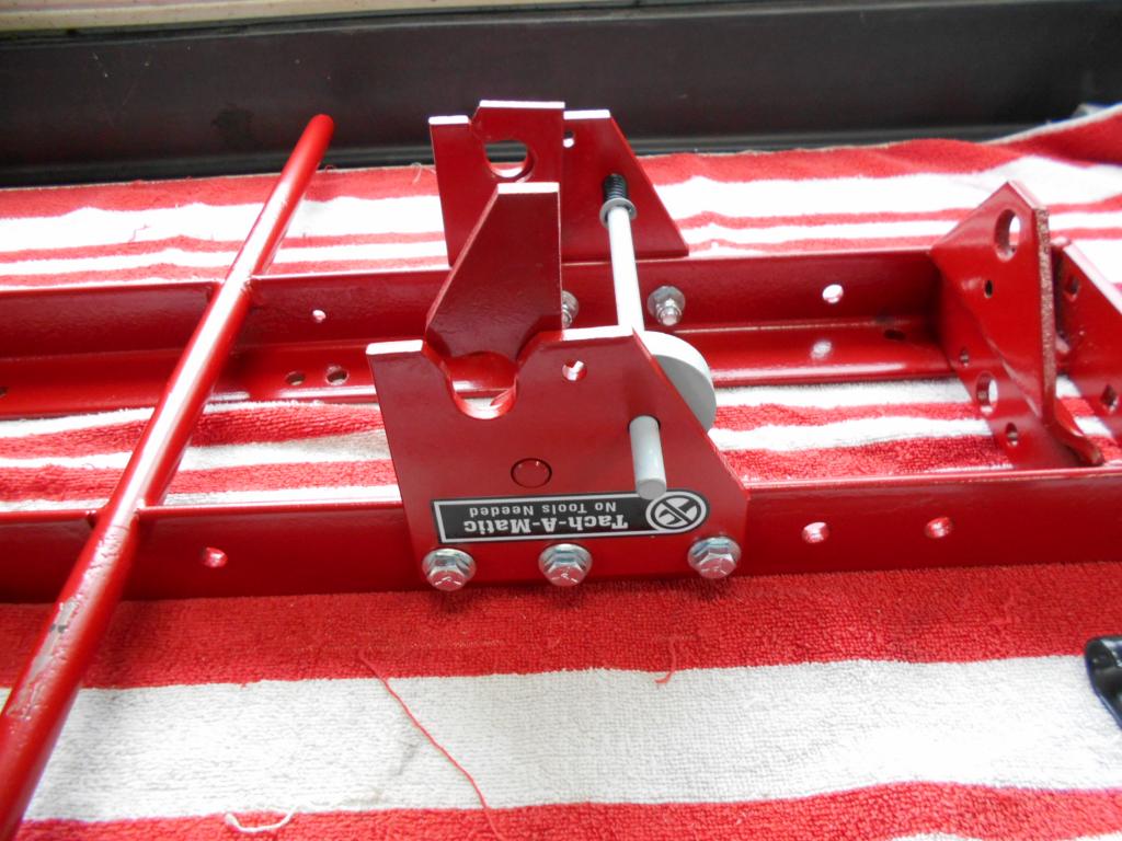

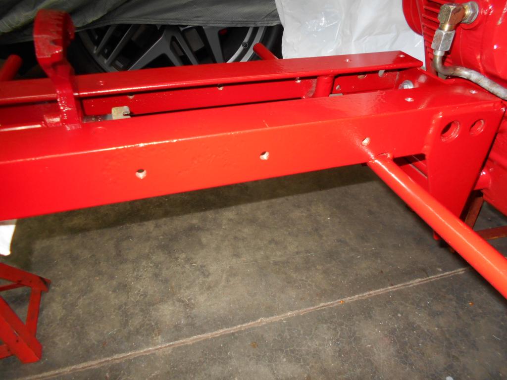

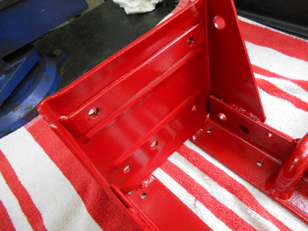

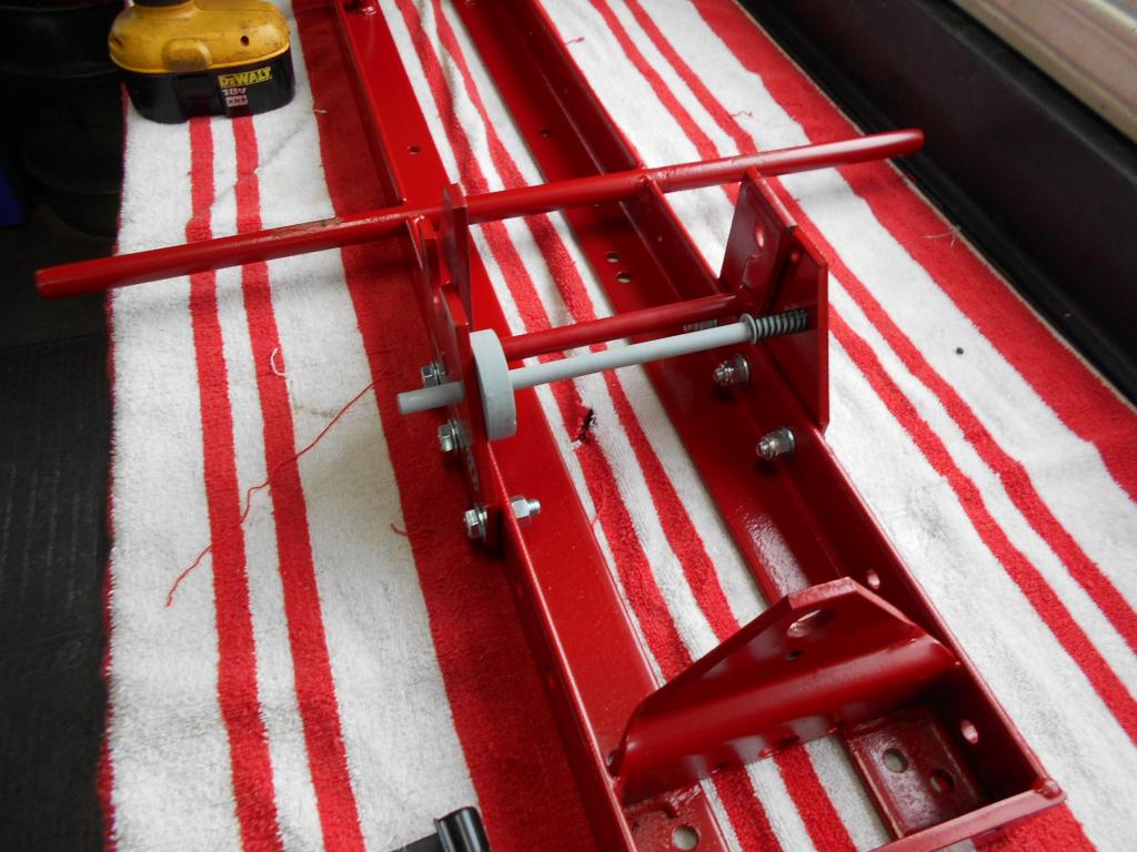

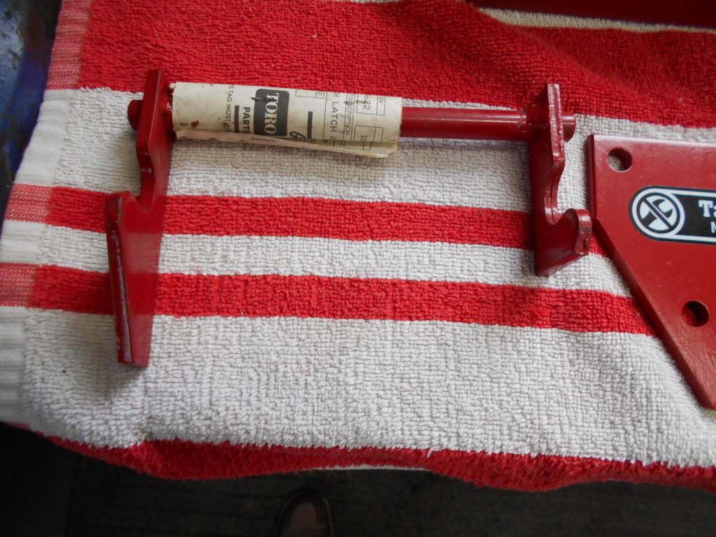

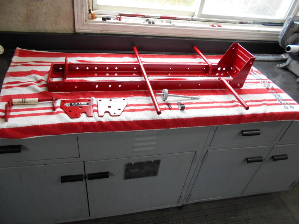

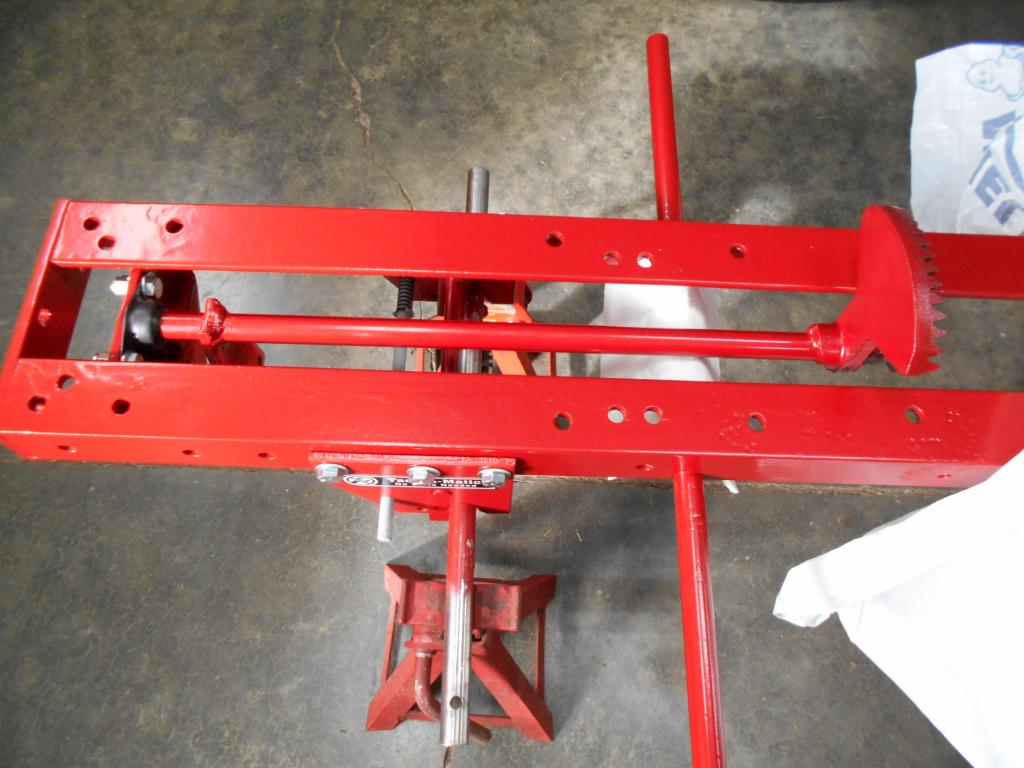

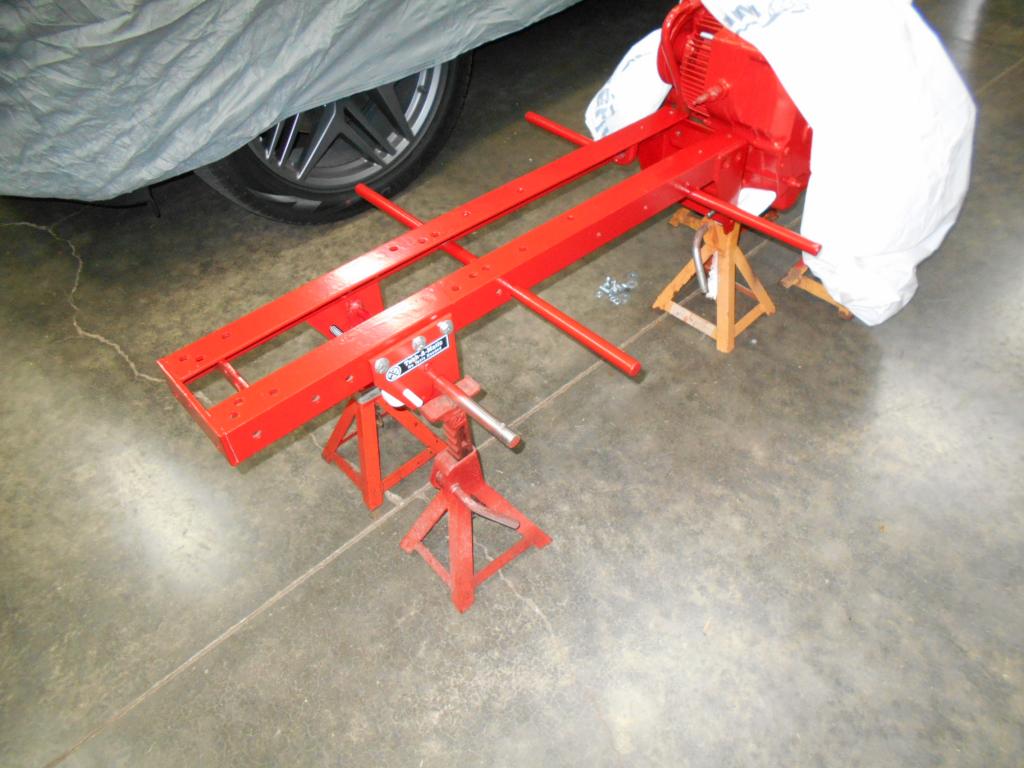

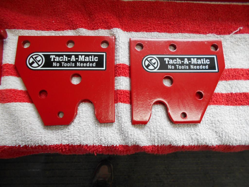

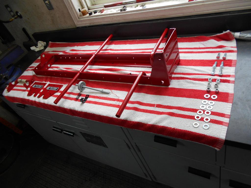

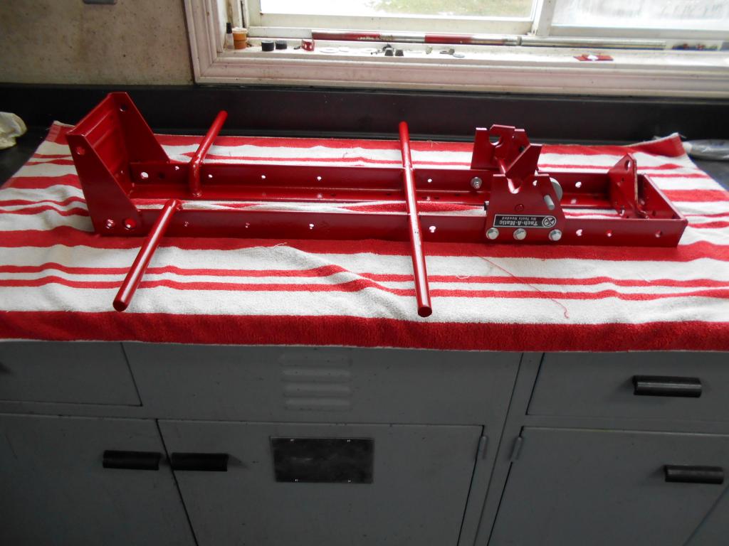

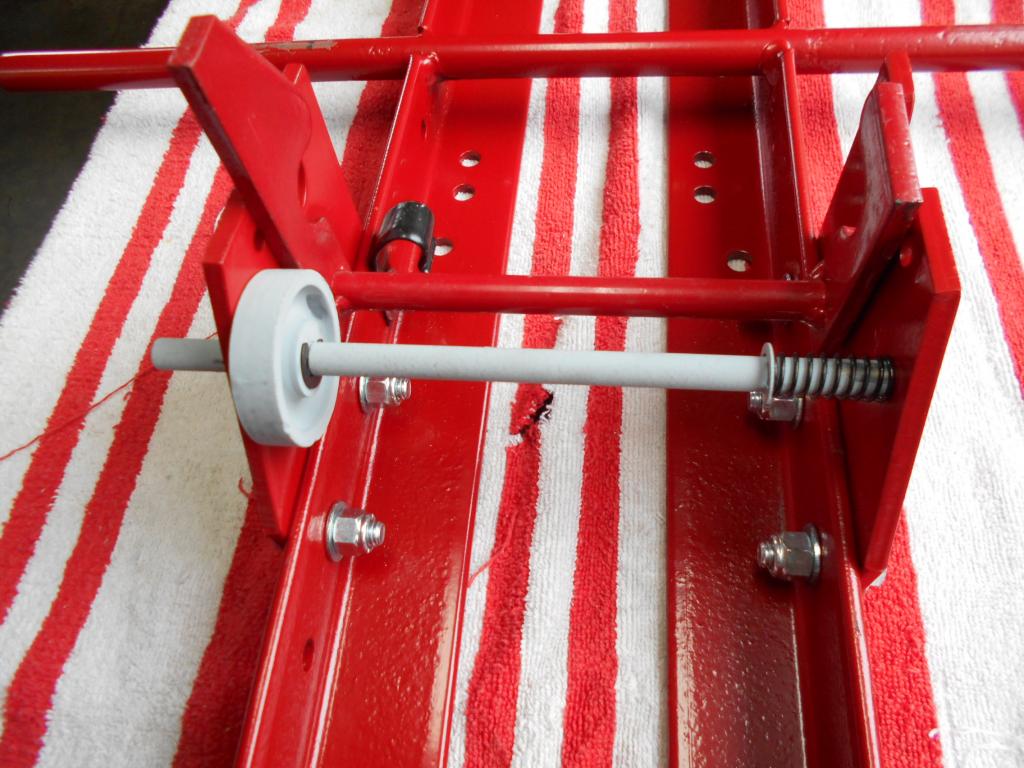

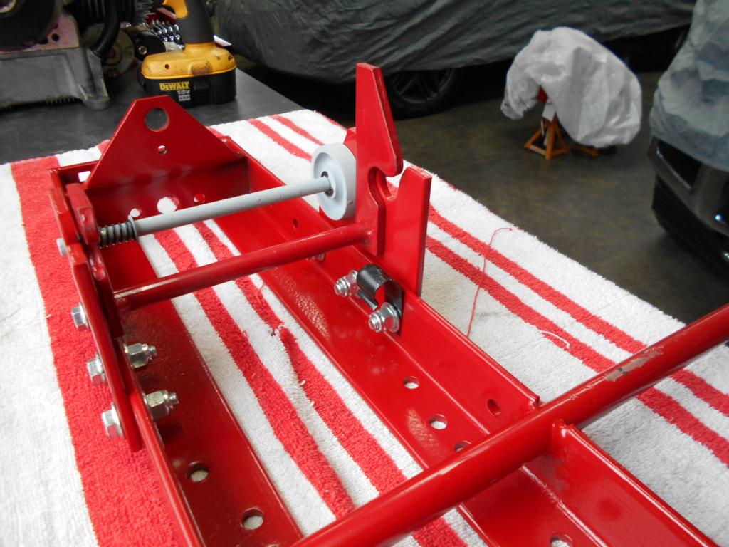

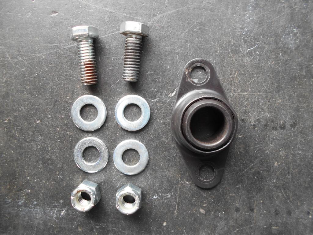

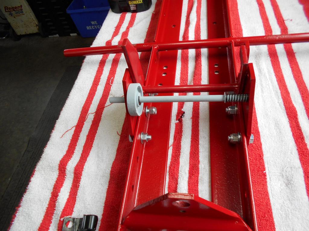

cleat 9,441 #117 Posted November 17, 2025 Mid Tach assembly ready to be installed. Mid Tach mounting hardware ready to be installed. Mid Tach lock assembly ready to be installed. Mid Tach plates ready to be installed. NOS mid Tach latch ready to be installed. Right side mid Tach plate installed and bolts tightened. Left side mid Tach plate loosely installed using standard non-locking nuts. Mid tach lock and latch installed then nuts spun in finger tight to hold everything properly together. Nuts switched to nyloc then all mounting hardware tightened. Note clip on Left rear bolt has been installed. This is to hold the battery tray drain tube. 1 4 Share this post Link to post Share on other sites

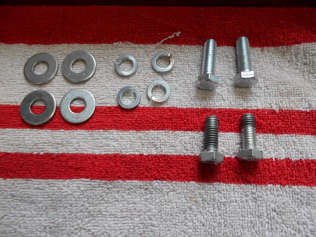

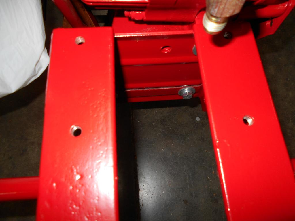

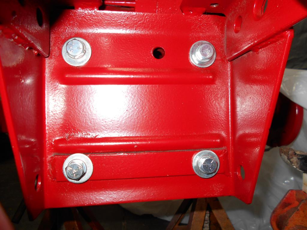

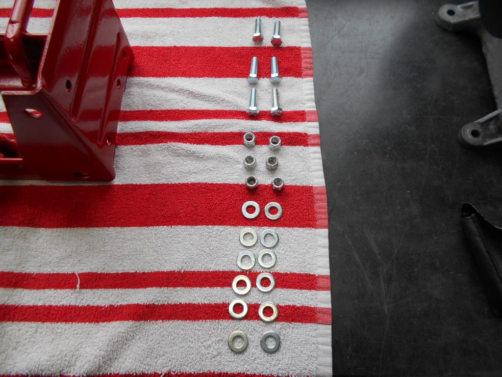

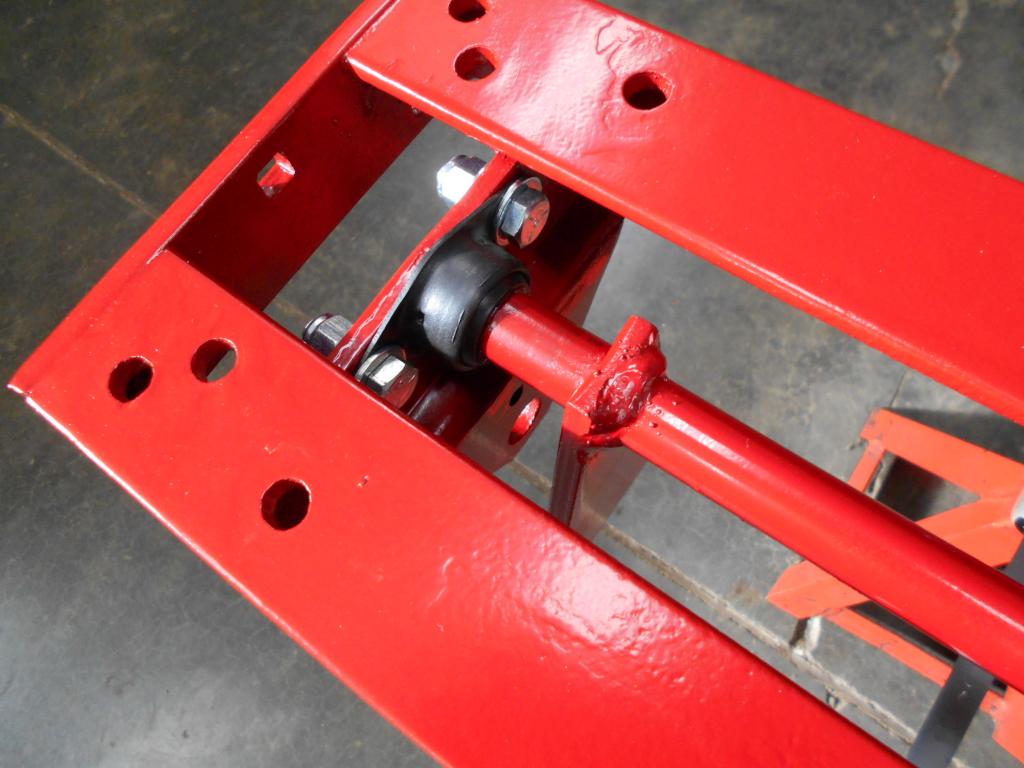

cleat 9,441 #118 Posted November 17, 2025 Frame to rear axle hardware ready to install. Not two bolts are 1" and two are 1-1/4" This is due to the re-enforcing plate on the bottom two mounting holes on the frame. 2 Share this post Link to post Share on other sites

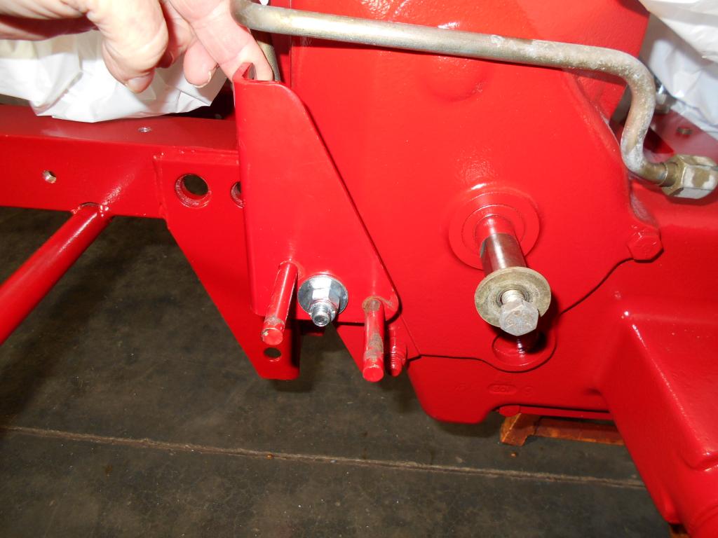

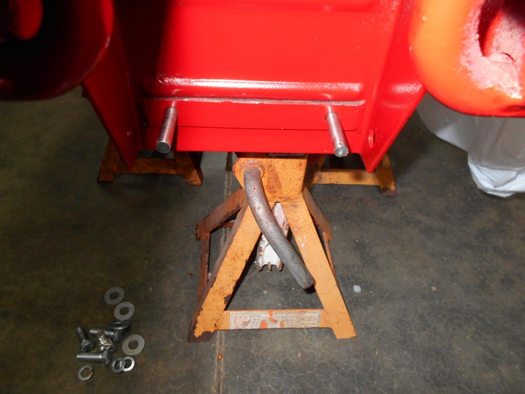

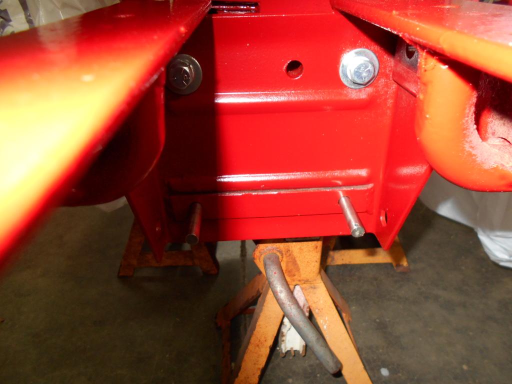

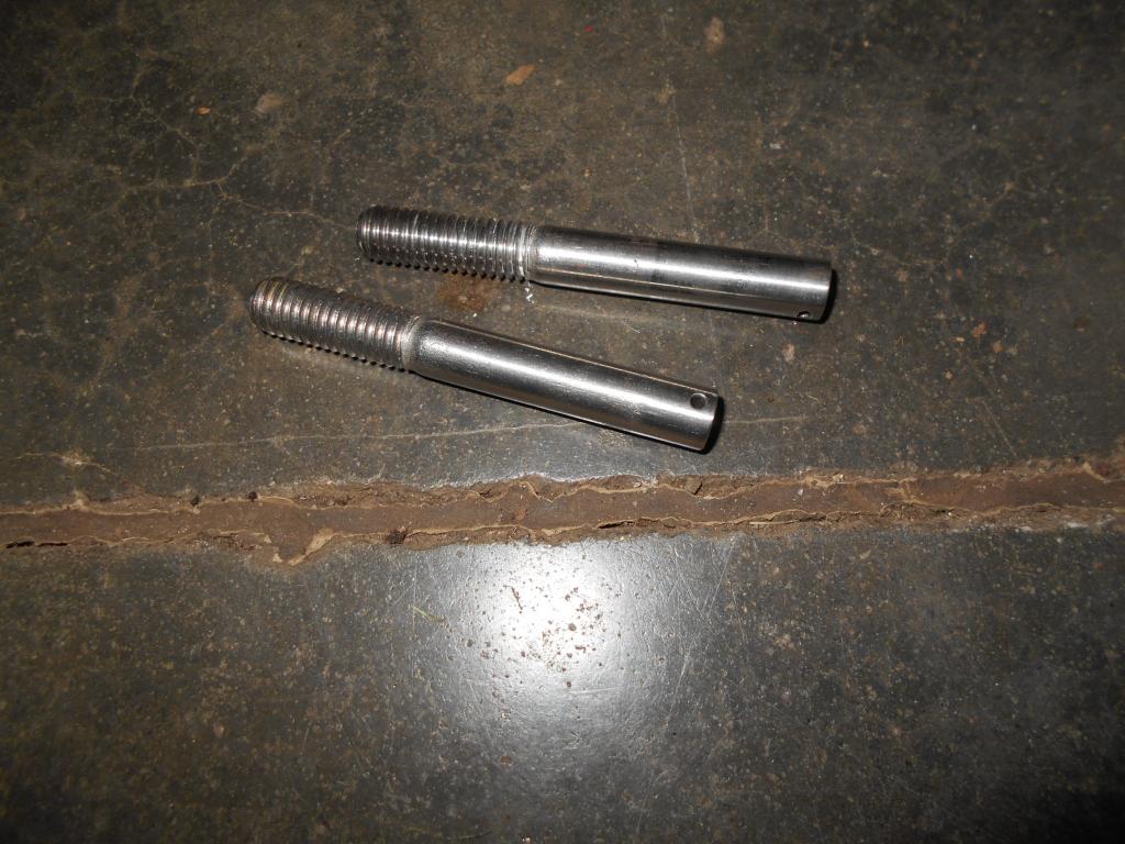

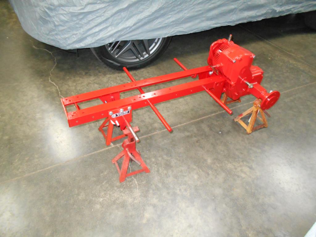

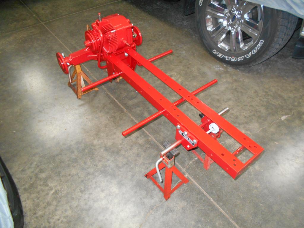

cleat 9,441 #119 Posted November 17, 2025 (edited) These two locating pins were screwed into the two lower threaded holes in the rear axle where the frame bolts on. Frame slid onto locating pins and held up by a 3/4" rod slid into the mid Tach and supported on jackstands. Jackstand height adjusted until frame and rear axle meet up nice and even. Top two bolts loosely installed. Locating pins removed then lower bolts installed. Frame fully bolted to rear axle. Bolts torqued to 26 ft/lb. Edited November 17, 2025 by cleat 5 Share this post Link to post Share on other sites

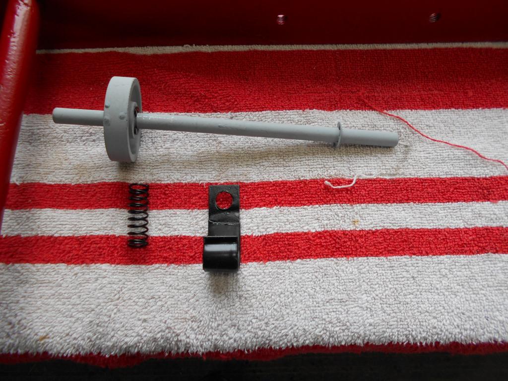

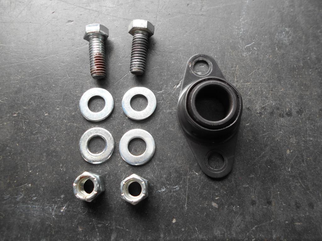

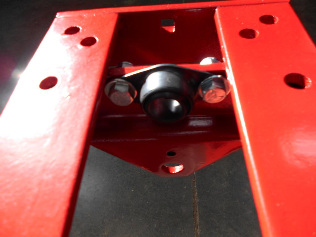

cleat 9,441 #120 Posted November 18, 2025 Lower steering shaft flanged bearing ready to be installed. Lower steering shaft flanged bearing installed. Lower steering shaft lightly greased then slid into flanged bearing. 3 Share this post Link to post Share on other sites

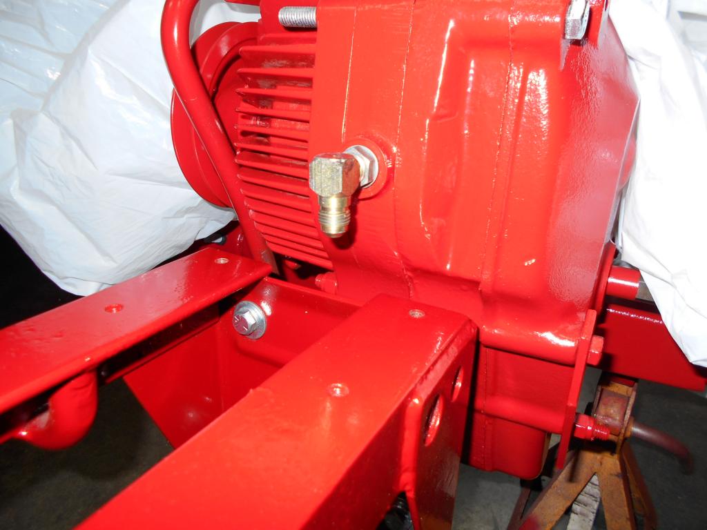

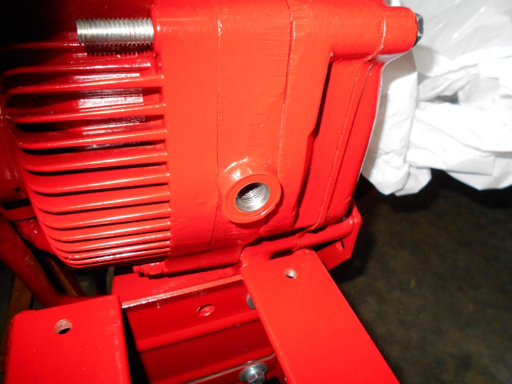

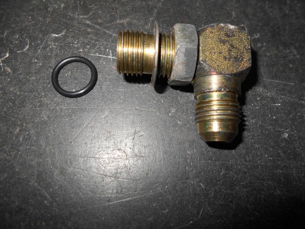

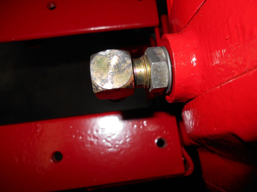

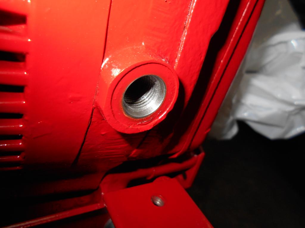

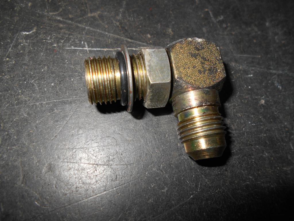

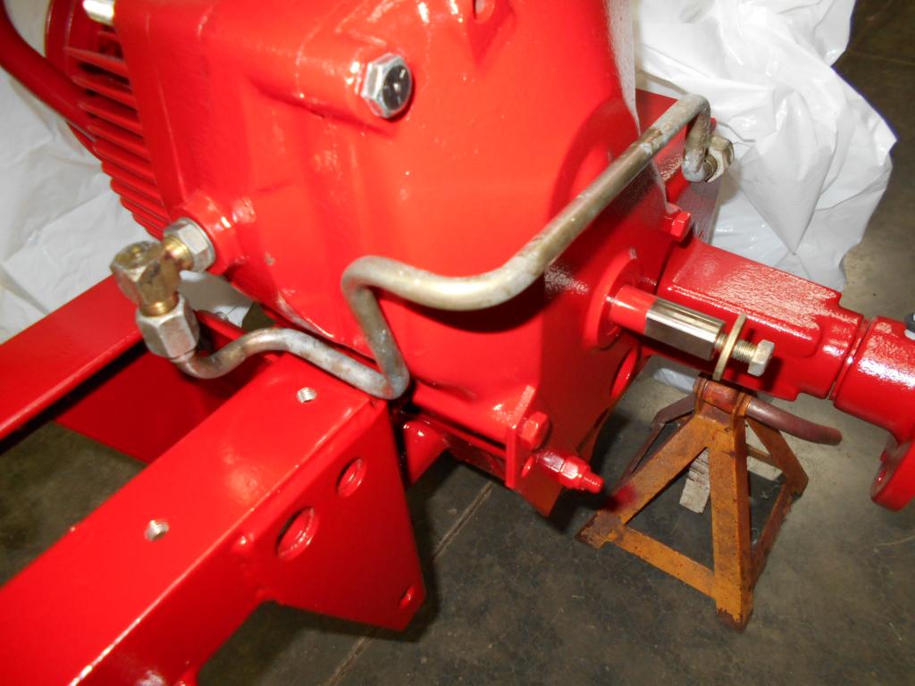

cleat 9,441 #122 Posted November 19, 2025 (edited) Rear axle ready for return line elbow. Return line elbow ready to receive new #906 Nitrile O ring. New O ring installed onto elbow. Elbow installed finger tight into rear axle. Edited November 19, 2025 by cleat 2 Share this post Link to post Share on other sites

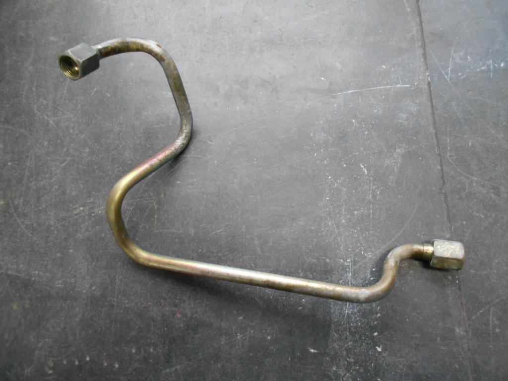

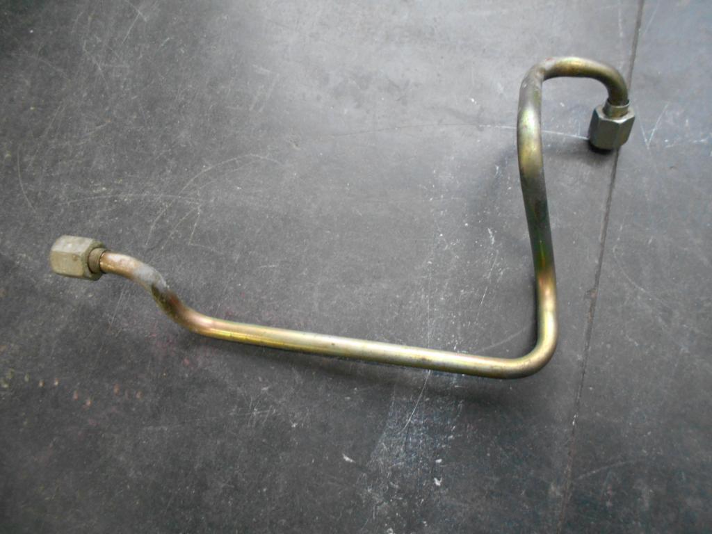

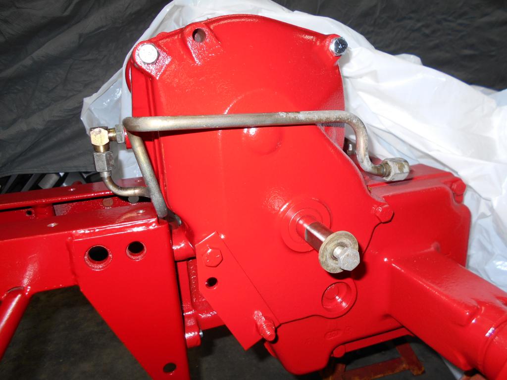

cleat 9,441 #123 Posted November 19, 2025 Frame threaded holes chased with tap. Return line ready to install. Return line installed finger tight. I will fully tighten all fittings later. 2 Share this post Link to post Share on other sites

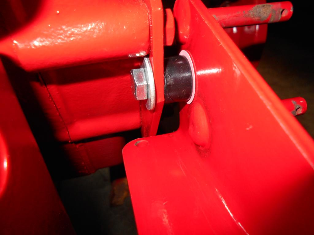

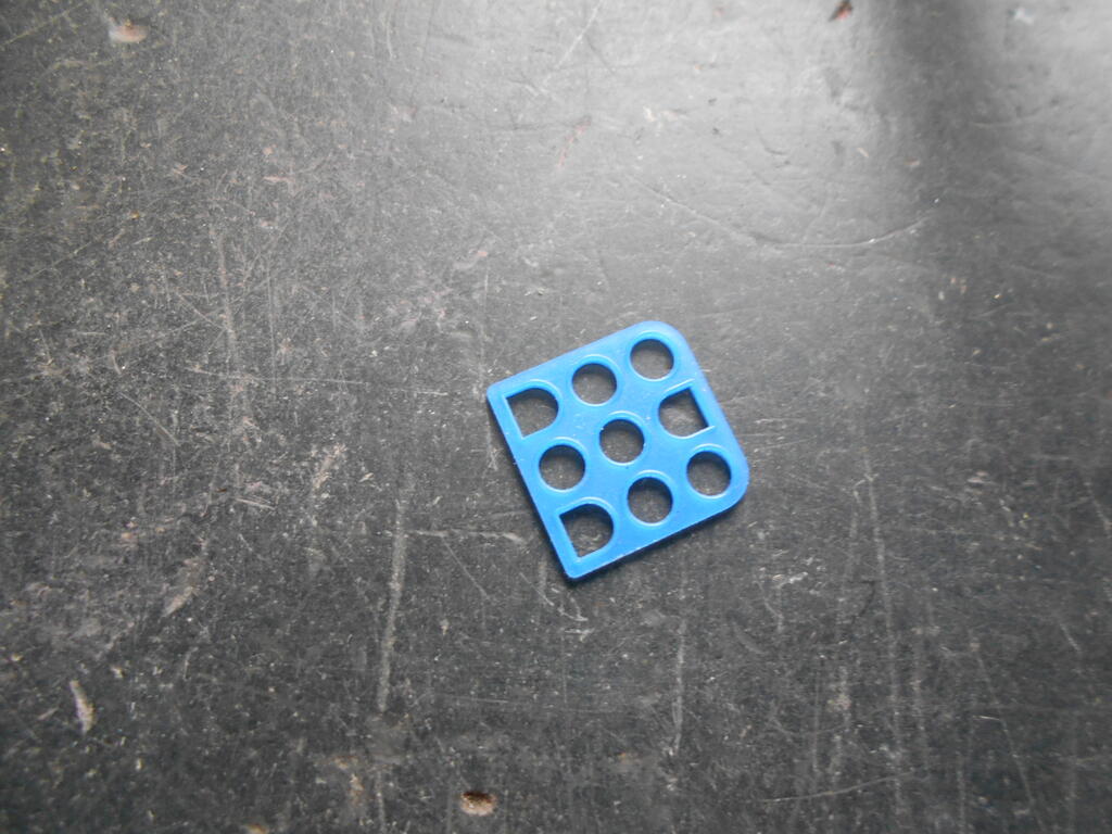

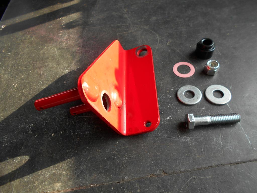

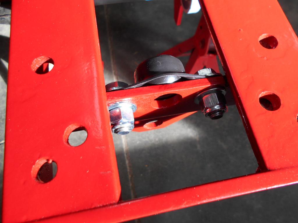

cleat 9,441 #125 Posted November 20, 2025 Brake pivot arm and bushing assembly ready to be installed. Note the pink spacer that I punched out of 0.015" plastic shim stock that slip onto bushing to remove play from the pivot arm but still allows for free movement. Brake pivot arm has not been repainted as it was in good enough shape as removed, bushing was bead blasted and painted. Brake pivot arm and bushing assembly installed. Brake pivot arm spacer installed. 3 Share this post Link to post Share on other sites
