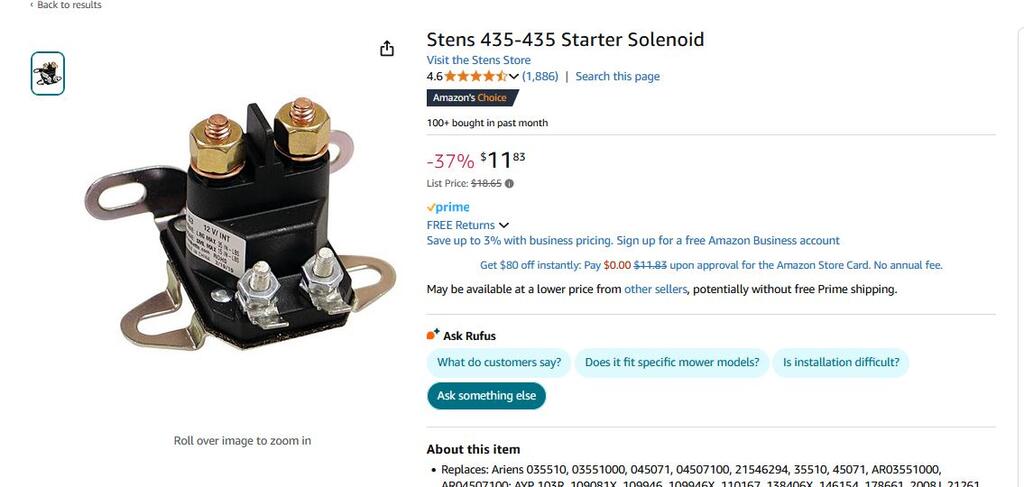

BdubRADR12 8 #28 Posted December 13, 2024 10 hours ago, 953 nut said: You will want to buy a five terminal ignition switch # 103-990, these are available at a variety o places for $ 20.00 or less. Many of us use a Ford starter solenoid in place of the standard lawnmower solenoid, they are much better and cost the same or less. The Kohler part number 41 403 06 voltage regulator is the one you should use, The new number for this is 25 403 22 and is a good source. Most good auto parts stores will have a selection of battery cables in various lengths, a #6 AWG will be good. Ok thanks, do you have a part # or link for the solenoid ? That would be helpful. Share this post Link to post Share on other sites
pfrederi 21,342 #29 Posted December 13, 2024 These are available and cheap... will they last 25 years??? i have couple that have lasted 5-10 years,.. Share this post Link to post Share on other sites
953 nut 70,661 #30 Posted December 13, 2024 Here is a search for the Ford Solenoid, take your pick. The Ford solenoid has two small posts, the "I" post will not be used, the "S" post will go to the ignition switch "S" terminal. https://www.google.com/search?q=ford+solenoid&rlz=1C1JZAP_enUS981US981&oq=&gs_lcrp=EgZjaHJvbWUqCQgAECMYJxjqAjIJCAAQIxgnGOoCMgkIARAjGCcY6gIyCQgCECMYJxjqAjIJCAMQIxgnGOoCMgkIBBAjGCcY6gIyCQgFECMYJxjqAjIJCAYQIxgnGOoCMgkIBxAjGCcY6gLSAQkyNDYxNmowajeoAgiwAgE&sourceid=chrome&ie=UTF-8 Here is the lowest price Ebay voltage regulator link I found. https://www.ebay.com/itm/356251053268?_skw=Kohler+4140306+voltage+regulator&itmmeta=01JEYPCQQ5F0Q5FPBDBV42N8WZ&hash=item52f237acd4:g:5okAAOSwC51nGgVo&itmprp=enc%3AAQAJAAAA4HoV3kP08IDx%2BKZ9MfhVJKlW7FnhQMt%2BJtj0Joh3nBZu0K4voYjkUVZldvpQ%2BfSk1Ko31EVs%2B74br3ugUTIxCb2905CO%2BWxTEWcsN1AbK6u%2BxUnxKdv1IV2m3Ege7Jy25wbwzX9ga92hMeJUWG09VCbyQL2uUl53vI5T0RrPlJBKCg5mt5%2FJtVC%2BjoCzU3479AHinG5FAAUy%2BBj7hS3vlKBBTZYdE%2BohUD%2Bht6UdClrXahVeEy6fhFL6ZA%2BNaBVacDWqbAzdwEJOTExsumMBZiqKqkHX%2FFe5SVD9OV9oHEL1|tkp%3ABk9SR9j7stb3ZA Share this post Link to post Share on other sites
BdubRADR12 8 #31 Posted December 13, 2024 17 minutes ago, 953 nut said: Here is a search for the Ford Solenoid, take your pick. The Ford solenoid has two small posts, the "I" post will not be used, the "S" post will go to the ignition switch "S" terminal. https://www.google.com/search?q=ford+solenoid&rlz=1C1JZAP_enUS981US981&oq=&gs_lcrp=EgZjaHJvbWUqCQgAECMYJxjqAjIJCAAQIxgnGOoCMgkIARAjGCcY6gIyCQgCECMYJxjqAjIJCAMQIxgnGOoCMgkIBBAjGCcY6gIyCQgFECMYJxjqAjIJCAYQIxgnGOoCMgkIBxAjGCcY6gLSAQkyNDYxNmowajeoAgiwAgE&sourceid=chrome&ie=UTF-8 Here is the lowest price Ebay voltage regulator link I found. https://www.ebay.com/itm/356251053268?_skw=Kohler+4140306+voltage+regulator&itmmeta=01JEYPCQQ5F0Q5FPBDBV42N8WZ&hash=item52f237acd4:g:5okAAOSwC51nGgVo&itmprp=enc%3AAQAJAAAA4HoV3kP08IDx%2BKZ9MfhVJKlW7FnhQMt%2BJtj0Joh3nBZu0K4voYjkUVZldvpQ%2BfSk1Ko31EVs%2B74br3ugUTIxCb2905CO%2BWxTEWcsN1AbK6u%2BxUnxKdv1IV2m3Ege7Jy25wbwzX9ga92hMeJUWG09VCbyQL2uUl53vI5T0RrPlJBKCg5mt5%2FJtVC%2BjoCzU3479AHinG5FAAUy%2BBj7hS3vlKBBTZYdE%2BohUD%2Bht6UdClrXahVeEy6fhFL6ZA%2BNaBVacDWqbAzdwEJOTExsumMBZiqKqkHX%2FFe5SVD9OV9oHEL1|tkp%3ABk9SR9j7stb3ZA That helps alot. I may aswell just redo all that. just keep factory starter and the coil. 1 Share this post Link to post Share on other sites
