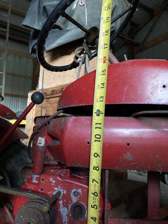

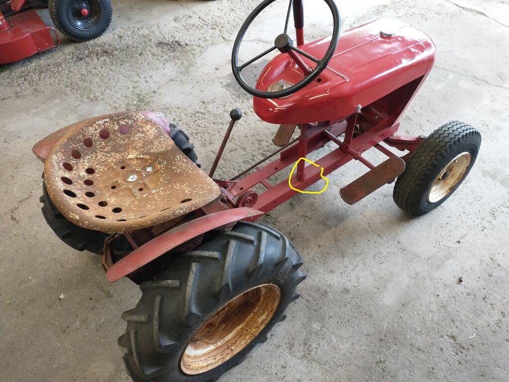

wh500special 2,390 #1 Posted December 7, 2024 (edited) I don’t have one to measure: Will a Kohler k181 or a Magnum 8 fit under the hood of a Suburban 400/401/550/551 without cutting the hood? there’s 12.5 inches between the hood and frame. I don’t mind if the hood support bracketry has to be excised, but don’t want to cut into a good hood. I suppose the hood could be shimmed up a bit without too much drama from the steering shaft. An alternate route is to use a Honda GX 8 hp. I think that would make it due to the slant cylinder arrangement. I know several have swapped in a Harbor Freight clone of a Honda, so the geometry ought to be about the same. Thanks, Steve Edited December 7, 2024 by wh500special Added picture. Share this post Link to post Share on other sites
kpinnc 17,596 #2 Posted December 7, 2024 (edited) Steve the K181 on my son’s Ranger is 12.5 inches at the top of the sheet metal to the frame. Of course the spark plug will be higher, but should fit under the hood itself. You might also be able to get a shallow pan for even more room. The one below is a deep pan as used on most Wheel Horses. Edited December 7, 2024 by kpinnc 1 Share this post Link to post Share on other sites
