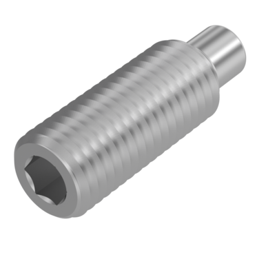

rmaynard 16,885 #15 Posted December 10, 2024 (edited) The dog-point set screws should look like this. The end should not be blunt. The ball at the end of the shifter has a roll pin holding it on. That pin is driven in so that it's flush with the back of the ball, and deep enough on the front to allow the point of the dog-point to enter. Also, you mentioned that the level of the oil was at the filler plug. If this is an 8-speed, Uni Drive transmissions, it hold two quarts of oil. If the level is only at the plug, you are about 8 ounces too low. If this transmission has a dip stick, add and measure there. Edited December 10, 2024 by rmaynard Share this post Link to post Share on other sites

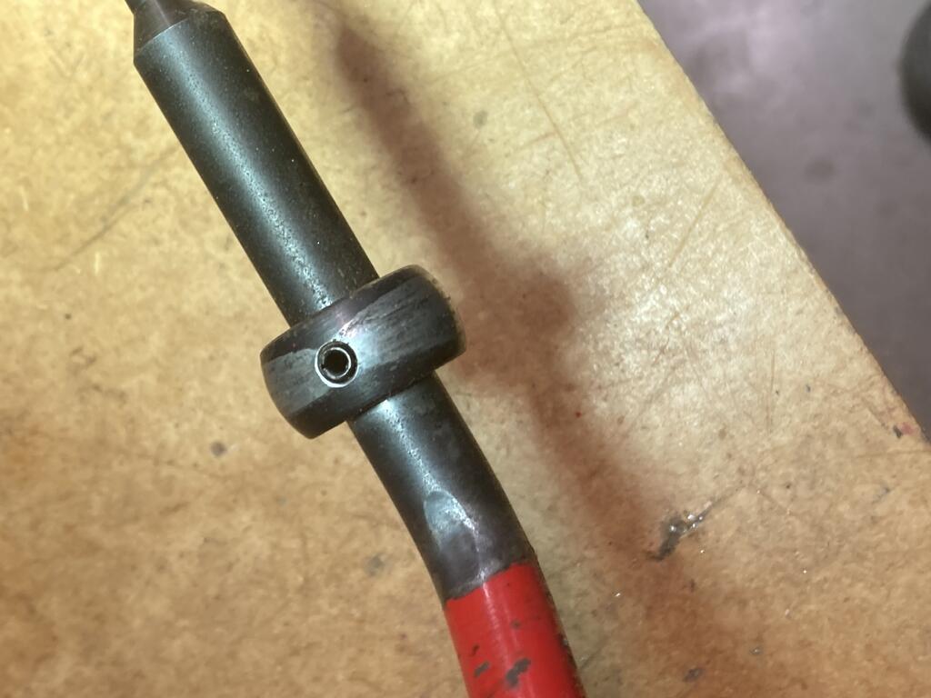

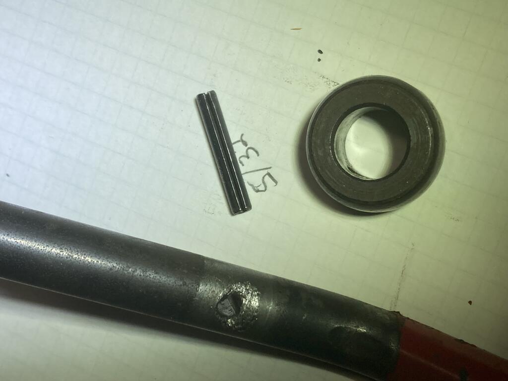

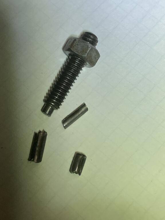

John A 30 #18 Posted December 15, 2024 I was able to repair the transmission problem on my 1986, Model 308-8, Wheel Horse with a $0.69, 5/32 x 1" tension spring (roll pin) from my local Hardware Store. The tractor is now drive able and all 8 gears can be selected on the Wheel Horse tractor Ater removing the gear shifter, donut, broken tension spring and set screw, the only thing needed was a new tension spring or roll pin. A 1/8'" diameter roll tension was too small. It wouldn't secure the donut snuggly to the sifter rod. Initially, I thought a new set screw was needed, but after cleaning, it looked great, so it was reinstalled. I did order one, which is expected it any day. Below are three pictures you may find of interest. 1409 - shifter with donut and 5/32" tension spring 1412 - the original broken tension spring and the set screw 1414 - the shifter rod with the donut held in place with the 5/32" tension spring I really appreciate all the feedback and suggestions on how to repair my Tractor. Hopefully my experience can help another member. These are great machines. John Crestwood, KY 1 4 Share this post Link to post Share on other sites
