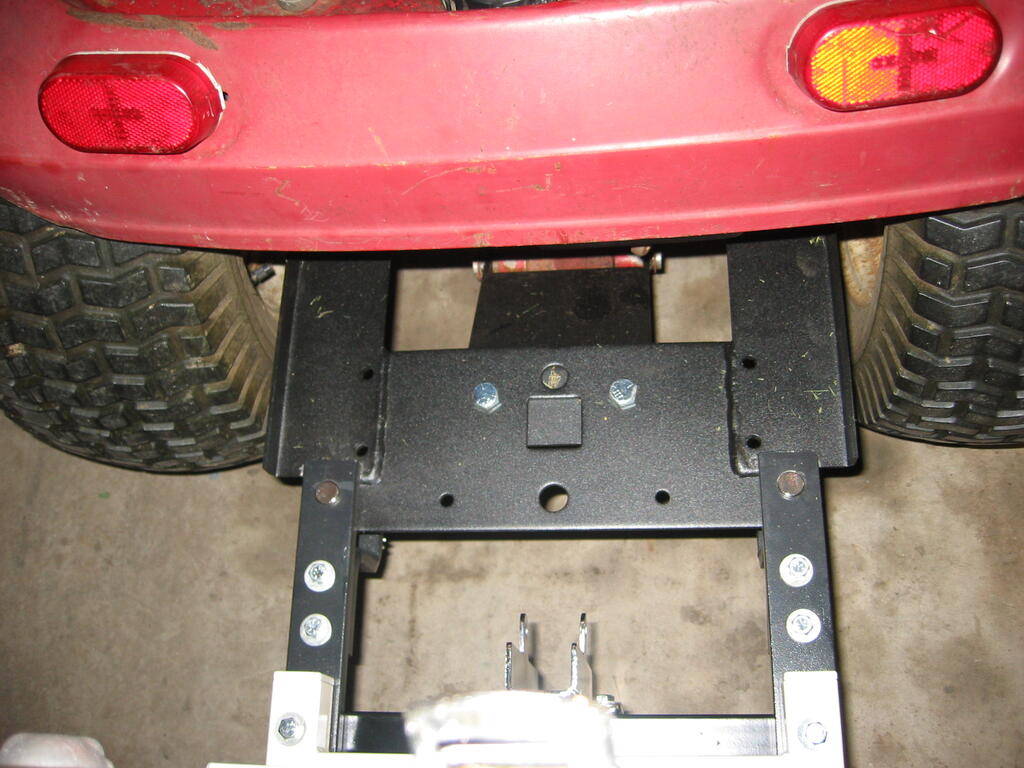

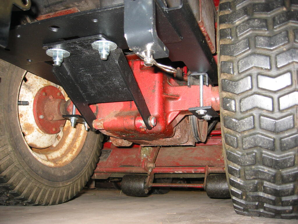

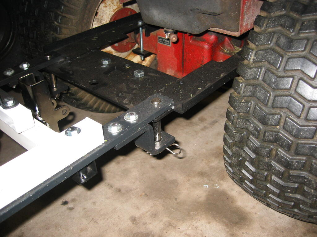

F. Marra 17 111 #32 Posted September 5, 2025 Good morning red square I just scored an older commercial cyclone vac for free in real good shape. barely used tecumseh 6 started right up. I was wondering if there was something avaiable to connect the dual point hitch thats on the vac to my 414, or do i have to make something to connect to the transmisson brackets? any advice, thoughts or ideas appreciated. If this is posted in the wrong section i apologize. 2 Share this post Link to post Share on other sites
pfrederi 20,992 #33 Posted September 5, 2025 1 hour ago, F. Marra 17 said: Good morning red square I just scored an older commercial cyclone vac for free in real good shape. barely used tecumseh 6 started right up. I was wondering if there was something avaiable to connect the dual point hitch thats on the vac to my 414, or do i have to make something to connect to the transmisson brackets? any advice, thoughts or ideas appreciated. If this is posted in the wrong section i apologize. Cyclo-vac makes a hitch for Wheel Horses 6 4 1 Share this post Link to post Share on other sites

F. Marra 17 111 #35 Posted September 5, 2025 Thank you for the pictures. I figured they made somthing. I've heard great things about their customer service, but yesterday the gentlemen I spoke too seemed like he didnt even know what tractor is. I look forward to using this, as the cleanup bill from my landscaper last year almost gave me heart attack 1 Share this post Link to post Share on other sites
pfrederi 20,992 #36 Posted September 5, 2025 48 minutes ago, F. Marra 17 said: Thank you for the pictures. I figured they made somthing. I've heard great things about their customer service, but yesterday the gentlemen I spoke too seemed like he didnt even know what tractor is. I look forward to using this, as the cleanup bill from my landscaper last year almost gave me heart attack Sorry to hear that ..i got mine a few years ago so i don't know what part number the hitch was. the lady back then was very helpful... This is their busy season and they probably have some temporary help. Share this post Link to post Share on other sites

Bar Nuthin 2,926 #40 Posted September 5, 2025 11 hours ago, F. Marra 17 said: Good morning red square I just scored an older commercial cyclone vac for free in real good shape. barely used tecumseh 6 started right up. I was wondering if there was something avaiable to connect the dual point hitch thats on the vac to my 414, or do i have to make something to connect to the transmisson brackets? any advice, thoughts or ideas appreciated. If this is posted in the wrong section i apologize. I made one from some scrap. I also added a 2" receiver. Probably should have extended out a few more inches for clearance, but it works great. 5 4 Share this post Link to post Share on other sites

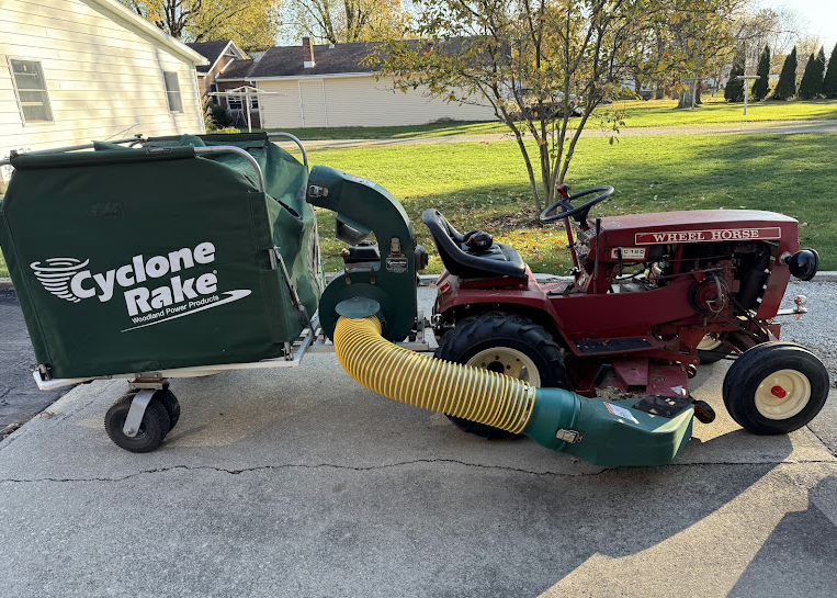

F. Marra 17 111 #42 Posted September 8, 2025 When my father bought the tractornew in the mid late 80's he also bought the PTO driven TRAC VAC. Unfortuntlay over 30 years i do not have all the parts to make that work again. I do have the PTO vac, but no hoses, trailer, canopy, belts, etc. The reason i really need this cyclone vac and what made me pull the trigger on this one is the hand held hose accesory. My yard has multiples levels, retaining walls and landscaping that i cannot drive my tractor over or near. I am hoping that between my back pack blowe and this cyclone vac I can cut cleanup time in half. 4 Share this post Link to post Share on other sites
pfrederi 20,992 #43 Posted September 8, 2025 1 hour ago, F. Marra 17 said: When my father bought the tractornew in the mid late 80's he also bought the PTO driven TRAC VAC. Unfortuntlay over 30 years i do not have all the parts to make that work again. I do have the PTO vac, but no hoses, trailer, canopy, belts, etc. The reason i really need this cyclone vac and what made me pull the trigger on this one is the hand held hose accesory. My yard has multiples levels, retaining walls and landscaping that i cannot drive my tractor over or near. I am hoping that between my back pack blowe and this cyclone vac I can cut cleanup time in half. Good Luck with the hand held hose. I bought one used it twice and hung it up. It is heavy very stiff and hard to use. Also it is fairly short so you have to keep stopping to move the tractor. Might work better if you had someone to drive the tractor while you vacuum. 2 Share this post Link to post Share on other sites

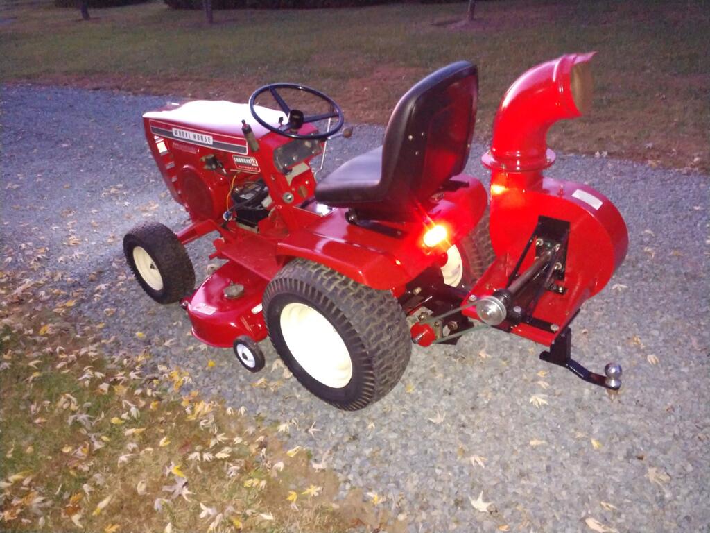

Lee1977 7,744 #44 Posted September 8, 2025 Here is the one I built. With gator blades and the vacuum it pack the leafs so tight I just dump the box. 2 8 Share this post Link to post Share on other sites
Bar Nuthin 2,926 #45 Posted September 9, 2025 (edited) On 9/8/2025 at 8:07 AM, pfrederi said: Good Luck with the hand held hose. I bought one used it twice and hung it up. It is heavy very stiff and hard to use. Also it is fairly short so you have to keep stopping to move the tractor. Might work better if you had someone to drive the tractor while you vacuum. My hand held is about 15' long and fairly flexible for a 6" hose. Even so, it can be cumbersome. I often lay it on the ground and use my blower to push leaves out of hedges, corners, and fence lines - to the open end laying on the ground and watch it suck them up. But if I had it to do over, I probably wouldn't have purchased it. I've also used it (along with an "unloader" hose) to spray leaves from the collection bag into the garden for tilling. Worked better once I had a helper to aim the hose. Edited September 9, 2025 by Bar Nuthin 3 Share this post Link to post Share on other sites

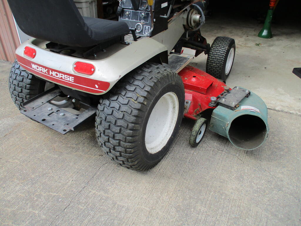

pfrederi 20,992 #47 Posted September 15, 2025 Put the Cyclo-vac hitch and collector on the Workhorse 1848. Used to run on a C-175-8 but I wanted more speed choices... Note the hitch requires minor mods to fit on a Hydro... Guess it was designed for 8 speed... 2 Share this post Link to post Share on other sites
Lee1977 7,744 #48 Posted September 15, 2025 (edited) Hydro have to have around 12" clear to fit Edited September 15, 2025 by Lee1977 Share this post Link to post Share on other sites
pfrederi 20,992 #49 Posted September 15, 2025 The issue was the bracket part that clamps over the axle housing. The cutout in it isn't big enough for the hydro axle . had to grind it out some... 3 Share this post Link to post Share on other sites
