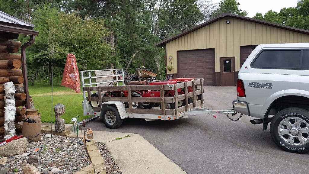

Keaton 466 #40 Posted November 21, 2024 we have always had a 24 foot car trailer to haul stuff we have bought, a few years back we bought a 24-foot full tiltbed trailer and we attached a winch, I got a allis Chalmers a few weeks back and it did not roll so we just hooked it up and drug it right up, but that's a real fancy setup that we just have had, we need a smaller trailer for me to get all my things, we will get one sometime 1 Share this post Link to post Share on other sites

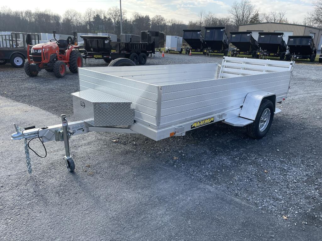

OoPEZoO 609 #43 Posted November 22, 2024 I've had a 5x8 aluminum utility trailer with wood stake sides for quite a few years. Fantastic small trailer that is easy to haul and is small enough for my tractors to haul around the yard no problem. It has served me (and many other friends/family) very well, but it had a few downsides.....I never had a proper set of ramps that worked with it well, and it was a little "short" for my last tractor pickup After a few conversations with my old man, he decided that we both "needed" access to a larger trailer with proper ramps. So, an agreement was made. I passed my trusty old trailer on to him, and we worked a deal out for this beautiful specimen a 5'8"x12' all aluminum with 24" sides and a bifold ramp. Just brought it home yesterday. Its so nice, I kinda don't want to haul anything in it...LOL. But at least I won't be scaring the hell out of myself driving my zero turn up/down a set of 2x10s again 6 4 Share this post Link to post Share on other sites
