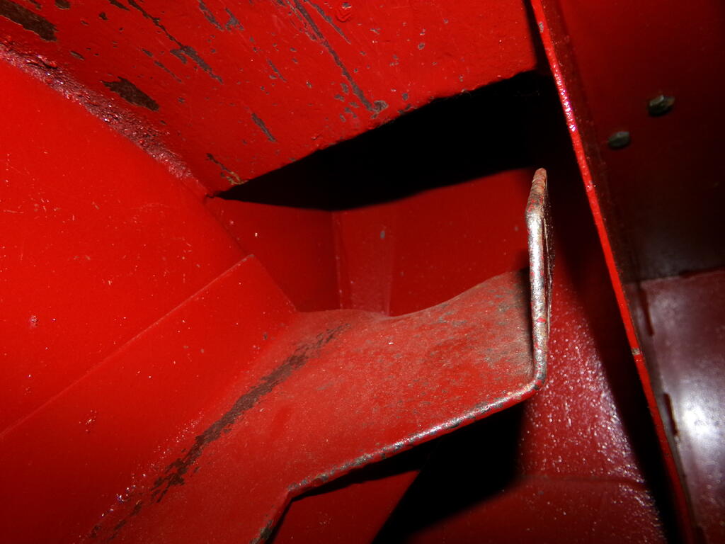

OoPEZoO 575 #12 Posted November 21, 2024 papadave hit me up to take a measurement of my impeller spacing via private message, but I wanted to put it out here as well in case anyone else ever needs it. The face of my impeller is exactly 1/2" from the rear wall of the chute housing. I'm assuming thats how it was initially assembled, as my tractor only has a little over 200 hrs on it and works well. Share this post Link to post Share on other sites
Ed Kennell 42,474 #13 Posted November 23, 2024 For any centrifugal impeller, water pump, hydro turbine, or snow thrower, To operate most efficiently, the rotating crown or back plate should be aligned with the stationary discharge pipe or chute. Any misalignment will cause a loss in efficiency. On my Ber Vac, there is no rotating back plate, but the impeller must be close to the back wall to align the buckets with the chute opening. Pretty difficult to get a good picture of this area. 1 Share this post Link to post Share on other sites
