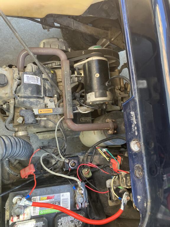

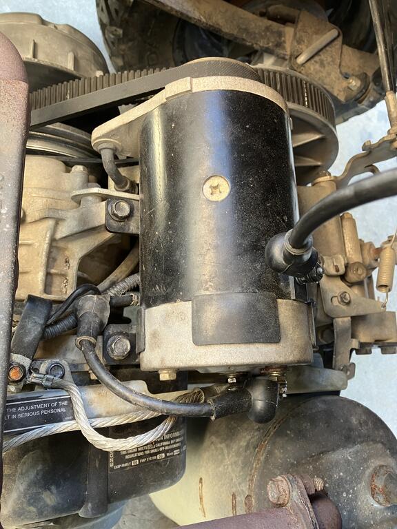

oliver2-44 11,065 #5 Posted November 12, 2024 Here’s some pictures. I thing I’m going to go pull the starter and check it out better Share this post Link to post Share on other sites
WHX?? 53,355 #6 Posted November 13, 2024 Ahh ok I see Ollie. Used on later stationary stuff, soft start gennys and of course golf carts. Real common on carts that are step on pedal and go. The one and only time I golfed they had them. Now golf is a stupid game but I had to see how that cart started so quick and quiet and had to look. The course maintenance guy busted me looking under the seats. I told him I had just have mechanical interests. He asked me if I wanted a job... Should be parts available no problem. Do believe I ran across replacenents while researching the sixties styles 1 Share this post Link to post Share on other sites

oliver2-44 11,065 #8 Posted March 4 After going through all the electrical, no change I finally figured out the erratic starting . If the engine was near the top of the compression stroke, the starter couldn’t get it over the hump. If it was just past the compression stroke it had a little room toget up to speed and would start. So I pulled the starter and took it to the local electric motor shop. He had an identical one on the counter from the EZGO dealer to repair $175 later it starts great. He replaced the start field coil, bearings, etc. He said the original coil was weak due to the insulation breaking down, but not bad enough to go to ground. 1 3 Share this post Link to post Share on other sites
