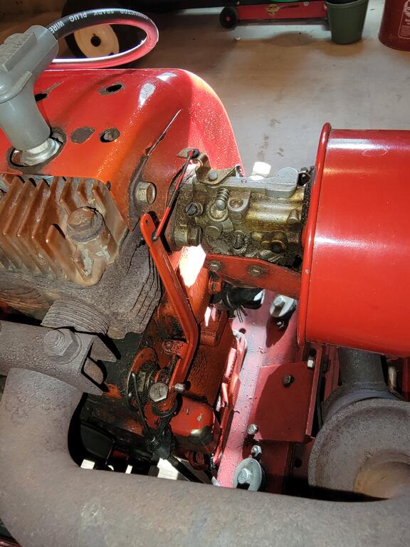

kpinnc 17,150 #3 Posted November 9, 2024 (edited) This is always helpful as well even if your throttle link is the ball joint type. Very important if it’s not. If you add a light spring between the governor arm and throttle tab (most Kohlers are pre-drilled for this), your governor response will be much better. The old solid links tend to wear just enough to create a little slop. Edited November 9, 2024 by kpinnc 1 2 Share this post Link to post Share on other sites
