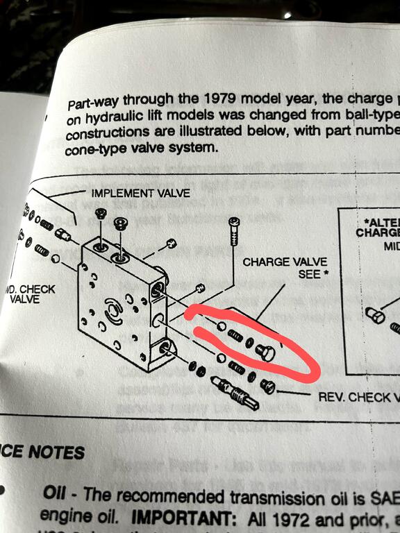

tmix61 95 #1 Posted November 4, 2024 I have a 1977 d200. I took the bolt out and there is no ball in spring behind there. Is there supposed to be if so does anybody have these parts Share this post Link to post Share on other sites

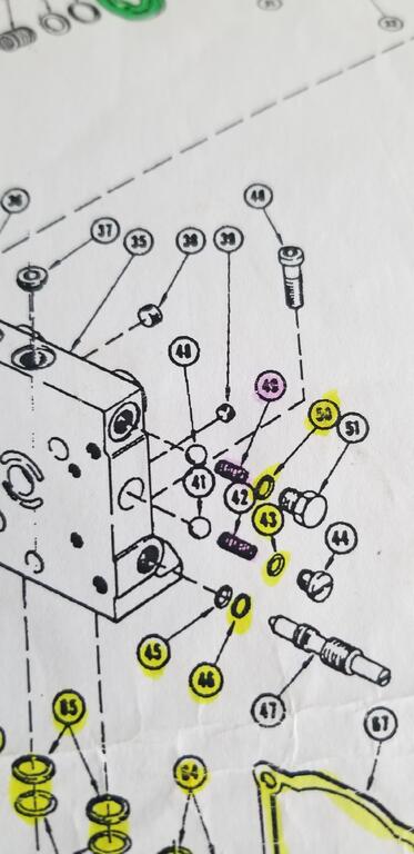

pfrederi 19,940 #2 Posted November 4, 2024 Are sure the ball isn't stuck in the housing? It is just a plain ball. The reverse check valve (directly below) uses the same one you could measure it and get a ball from McMaster or where ever. WH part number is 103216 1 Share this post Link to post Share on other sites

gt14rider 1,051 #5 Posted November 4, 2024 Looked this up couple years ago, got some crossover #s . SEPW. (small engine parts warehouse ) item # 48, ball 25-2490 and #49 spring 25-2480. Got got some more crossover #s let me know. LJ at (LJ fluid power) helped with a lot of parts. 2 1 Share this post Link to post Share on other sites
