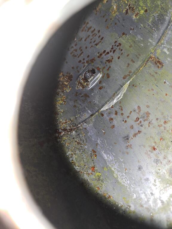

dmoore 1,042 #26 Posted November 5, 2024 I've got it full of concentrated 5% for overnight. I'll add some fasterners tommorow and give it a little shake. Thanks! Share this post Link to post Share on other sites
wallfish 20,744 #27 Posted November 5, 2024 (edited) 20 minutes ago, dmoore said: I've got it full of concentrated 5% for overnight. I'll add some fasterners tommorow and give it a little shake. Thanks! Fasteners aren't necessary if it isn't bad.The vinegar will still work. Best to do the fastener thing first when it's dry to get the bigger stuff and most of the rust off and out. Length of time for the soaking depends upon how bad it is. The beauty is there aren't any toxic chemicals to discard either. Use it for weed killer if you add a little salt to it. After the final rinse and dry I typically put a little gas mixed with 2 stoke oil. Shake around and get everything covered. The oil will help coat the metal, then just add gas to it whenever you're ready. The little bit of oil in the gas won't hurt anything in the engine Edited November 5, 2024 by wallfish 1 1 Share this post Link to post Share on other sites
Handy Don 17,735 #28 Posted November 5, 2024 14 hours ago, wallfish said: Put a handful or 2 of screws or nuts or both in the tank and shake them around If you plan on using the screws after this, they’ll need a bath to remove the acid and coat them against rust. Otherwise they’ll flash rust pretty easily! Share this post Link to post Share on other sites
dmoore 1,042 #29 Posted November 5, 2024 (edited) Vinegar didn't phase it. I went the Evapo Rust route. I had forgot about it. Used it years ago and had great results. As thin has that little tank is I didn't want to take a chance on puncturing it or making any pin holes. Edited November 5, 2024 by dmoore Share this post Link to post Share on other sites

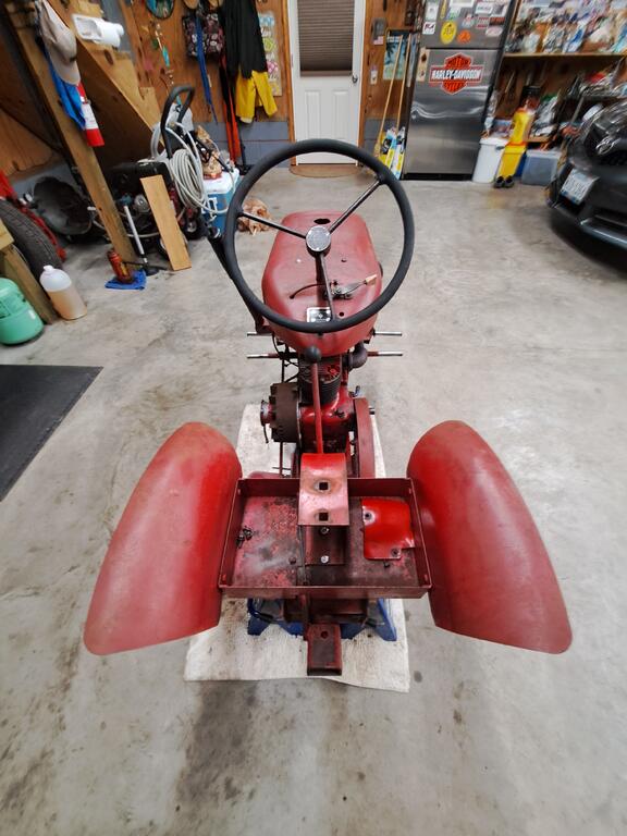

dmoore 1,042 #36 Posted November 9, 2024 Well the Evap O Rust lived up to its name. Tank is squeaky clean and ready to mount. I don't think spot welding two straps to that thin hood and securing the tank with full tank of fuel was exactly the best way but hey, I guess at the time it seemed ok. Share this post Link to post Share on other sites

dmoore 1,042 #38 Posted November 9, 2024 The rubber on the steering wheel is in amazing condition. Not one crack! 1 Share this post Link to post Share on other sites

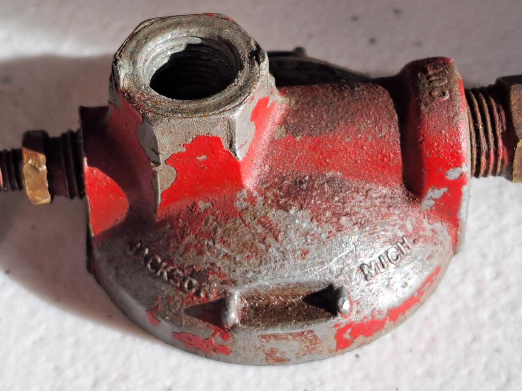

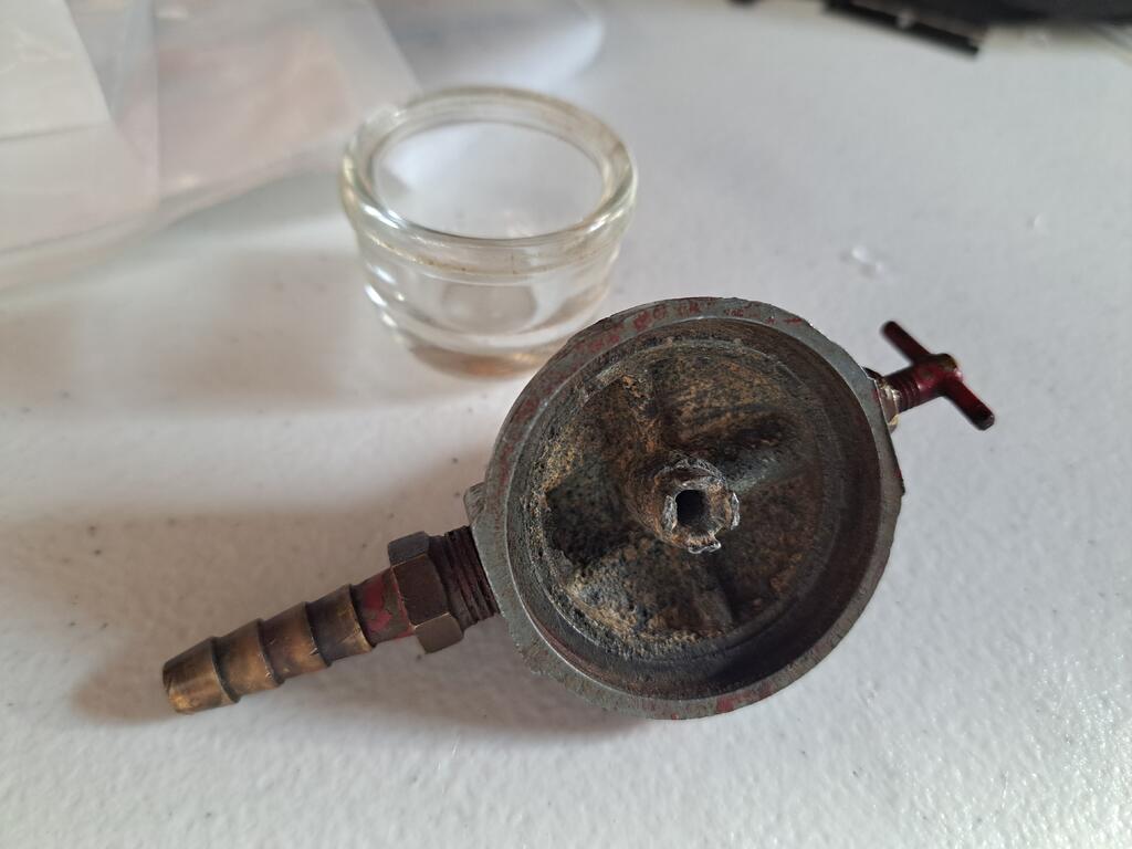

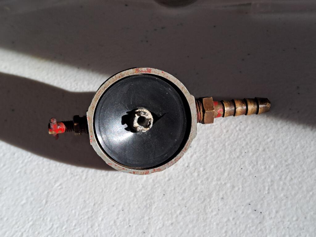

dmoore 1,042 #39 Posted November 9, 2024 Isn't there supposed to be a fine mesh screen in this fuel tank shutoff? Share this post Link to post Share on other sites
dmoore 1,042 #40 Posted November 9, 2024 There was a black neoprene gasket when I opened it up. I've seen round screens in these years ago. From what I have gathered, there was no Inline filter on these tractors? Share this post Link to post Share on other sites

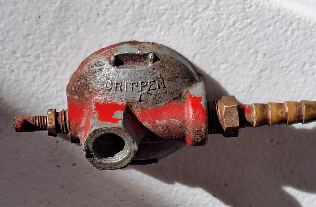

dmoore 1,042 #41 Posted November 9, 2024 Also am I to guess this one is original to a 58/59 RJ? Share this post Link to post Share on other sites
wallfish 20,744 #42 Posted November 9, 2024 Yes, there should be a screen. You can get the whole assembly new https://isavetractors.com/glass-sediment-bowl-fuel-filter/ Share this post Link to post Share on other sites
dmoore 1,042 #43 Posted November 9, 2024 Do you know if that screen is sold separately? I am really intent on keeping this guy as original as possible. Share this post Link to post Share on other sites
Handy Don 17,735 #44 Posted November 9, 2024 39 minutes ago, dmoore said: Do you know if that screen is sold separately? Really? https://www.mcmaster.com/products/wire-mesh/stainless-steel-wire-cloth-discs/ Share this post Link to post Share on other sites
wallfish 20,744 #45 Posted November 9, 2024 44 minutes ago, dmoore said: Do you know if that screen is sold separately? I am really intent on keeping this guy as original as possible. You would also need a new O ring for that shut off screw and a new gasket for the glass bowl. Maybe cut that piece you have for one. Use a fine mesh screen to filter the larger debris out. You can cut the circles https://www.amazon.com/Stainless-Micron-Filtration-Screen-3-94inch/dp/B07L8YN8DS/ref=sr_1_15?crid=14J8JPKGPRTQB&dib=eyJ2IjoiMSJ9.lV_qCGErgVpfAGD-WQslagV1Gm8oqD_6T75uQgcwqvVSqYqMojfXGtWOMpCXFeOwsurb_K_7WU2wjnCcMILK312YvePDzAVCRST47l5qJjVwXmm6EB4XI0fLes3j2X4TohOGxhkrtRBvYaHJdusuHKTgf6BHpSOtIocLqStb-JsHLBjXDYPSX_cvceU5_qDXRIIPCW9hdSfIgDbNT0GMGNQ5jozbWj7AW-5x3GaLrNk.fmfSWgTCWvWe4rCX4ecuoRmVi7LWCs39bPJXFb-uxnU&dib_tag=se&keywords=fine+mesh+brass+screen&qid=1731190895&sprefix=fine+mesh+brass+screen%2Caps%2C102&sr=8-15 1 Share this post Link to post Share on other sites

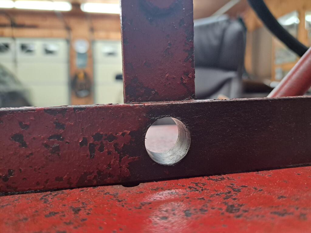

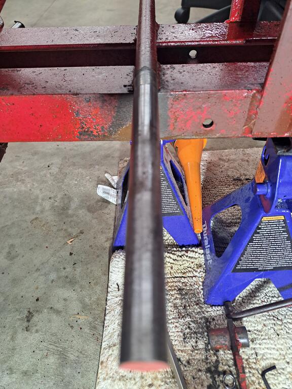

dmoore 1,042 #48 Posted November 11, 2024 Lift arm has more play than I'd like. Anyone have luck installing a bronze bushing there? The welded round stock to frame (foot rest) as almost no signs of wear. Guess it's harder than the lift arm. Share this post Link to post Share on other sites

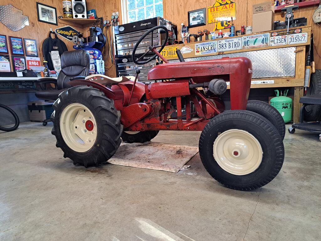

dmoore 1,042 #49 Posted December 6, 2024 Seat and wheels restored. The rest of the tractor has been wiped down with boiled linseed oil. 4 Share this post Link to post Share on other sites
c-series don 12,752 #50 Posted December 6, 2024 Looks like you could drill out the lift arm and put a bushing in there relatively easy. It’s looking good Dave! 1 Share this post Link to post Share on other sites
