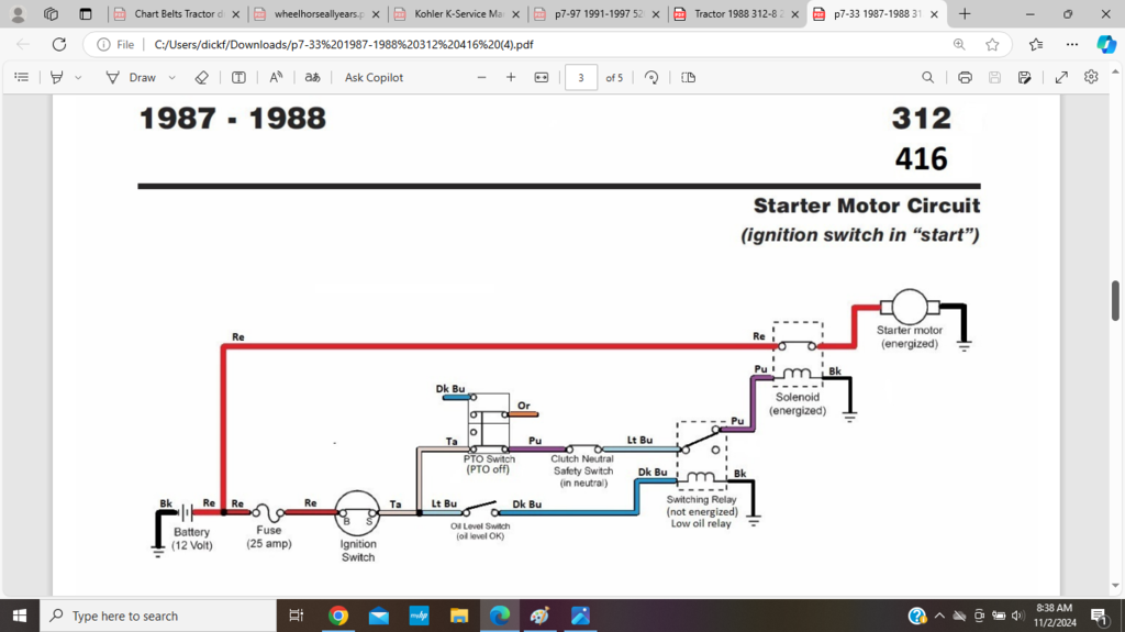

JP56 42 #1 Posted November 2, 2024 Have been scouring the site trying to find the cause of my No Start with Ignition Key condition. Ran fine, used it, put it away & a week later ---No Start, but would work if I jumped the 2 main studs on the Solenoid. I figured bad solenoid. Replaced it, same problem! Started looking at ignition switch & wiring. Found a 3" piece of wire with a connector on the end of it laying inside the housing. It went to the red wire that goes up to that annoying circuit board with the idiot lights, but could not tell where the other end snapped off from. Then I noticed the 5 hole connector on the back of the ignition switch had a melted bubble on it, so unplugged it & took switch out. As far as I can tell the switch was the original one, & a couple of the connector tangs were loosened up from age so I decided to put in a new switch while I had everything apart. I noticed that 1 of the 5 wire connections in the 5 lug connector for the switch had 2 wires in it going to one of the tangs on the switch, & I think I found a second one that should have had 2 wires in the connector going to another tang on the switch, so I figured that had to be the one where the broken wire came off of. Anyway, repaired everything, & replaced the burnt 5 prong housing, put it all back together & now still will not start with key, but solenoid can be jumped out & starts up. I have some wiring diagrams from here butt almost none of the wires in my tractor match what colors are spec'd out in the diagrams! My wires are ALL Black, with Tracer lines on them & they all appear to be original wires. They are also very stiff & brittle, so I was looking for a replacement harness for it. I found one, but I have no idea if it will fit my tractor so I am hoping someone here would know, since I cannot find an IPL that gives the actual Harness Part Number for my tractor. 2112K805 29480 Replacement Wiring Harness - Found this, New Old Stock Wheel Horse Wiring Harness # 108817, but the seller does not know which tractor models it fits. Can anyone here point me in the right direction on this? Share this post Link to post Share on other sites

JP56 42 #5 Posted November 2, 2024 Thanks 935 & Ed! I had already decided to replace the 2 fuse holders with the rubber ones with the snap caps on them but just hadn't gotten around to it yet. A note about the fuses, everything I read says the 312-6 should have a 15amp for the lights & a 25 amp for the starting circuit, but mine has a 15 amp and a 30 amp in it. Mine also has NO Seat switch & No Park Brake switch in it, and I have no idea if the Oil Switch has been disconnected or not, but will check that now that it was pointed out to me as a possible cause of my "No Start From Key" situation. The orange & white wires going to the parking brake switch were cut off 1" from the micro switch, the white one from the test panel to the switch was just cut & left hanging there, & I never noticed if the orange one from the panel to the switch is even still there or not. But since the day I bought it from the seller, that Test Panel only lit up the "TEST" light when you pressed the toggle switch down. Not sure if that little circuit board w the lights & wires connected to it have anything to do with my problem or not, since it always started & ran fine since the day I got it until last week, one week after it was last used. Share this post Link to post Share on other sites
953 nut 64,636 #6 Posted November 3, 2024 15 amp for the lights/hour meter etc. and 25 or 30 amp from the battery to ignition switch. Idiot lights have nothing to do with starting wires. 1 Share this post Link to post Share on other sites
