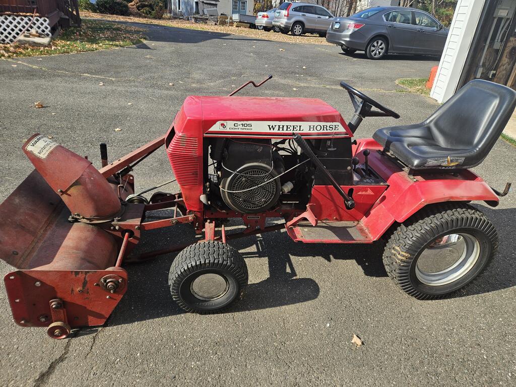

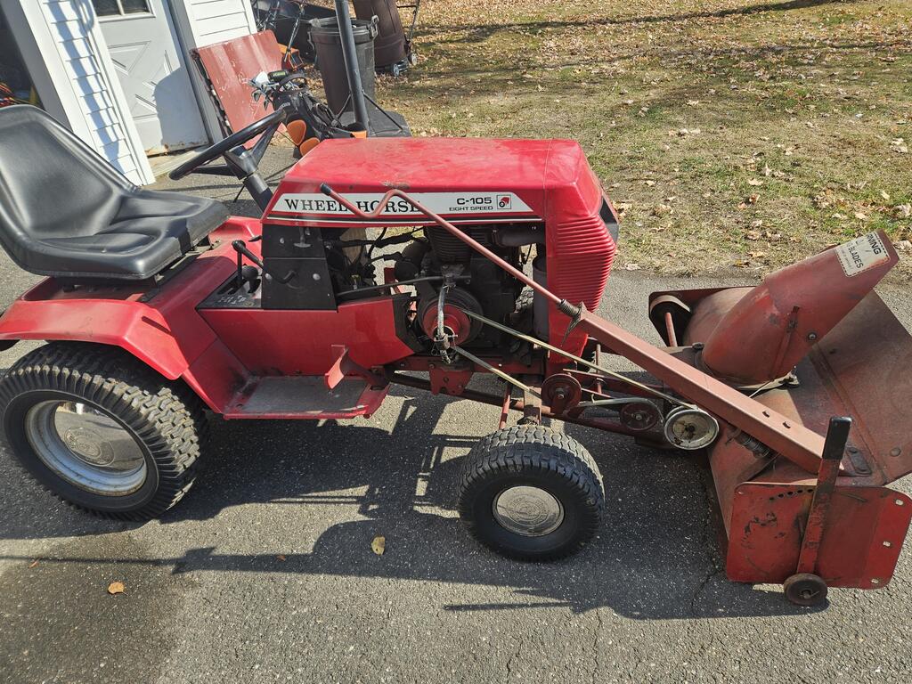

bwheels46 0 #1 Posted October 30, 2024 (edited) My father passed and I took ownership of a C-105 Wheel horse with a 42" snowblower attachment - however neither have the metal tags with s/n or other information. I need a belt to run the snowblower and don't know where to start - any help would be appreciated. Can send pics if needed Edited October 30, 2024 by bwheels46 adding pics 3 Share this post Link to post Share on other sites
WHX?? 51,675 #2 Posted October 30, 2024 Sorry to hear about your dad. Pics would help. Look under the dash for a tag. Others will be along to welcome and help out. 2 Share this post Link to post Share on other sites
gwest_ca-(File Mod) 11,433 #3 Posted October 30, 2024 Welcome to Red Square Not necessarily the snowthrower you have but the belt will be the same. Click on the picture 2 1 Share this post Link to post Share on other sites

Ed Kennell 41,761 #9 Posted October 30, 2024 (edited) to the 5/8 X 69" wrapped belt is what you need. I buy all my belts locally at TSC. If for any reason they do not fit, they can be returned for full refund. The belt should be installed on the outside (smaller) pulley on the PTO. The rear idler pulley goes above the lower belt loop and the front idler goes below the belt. There were different mounting kits for these snow blowers. Some mount to the front attach-a-matic and some mount to the frame with a long 3/8" bolt. Any questions, fell free to ask. Edited October 30, 2024 by Ed Kennell Share this post Link to post Share on other sites

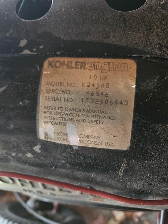

kpinnc 14,548 #11 Posted October 31, 2024 (edited) I’m sorry for your loss. You have an earlier model (85-86?) of the 310-8. Definitely had the hood decals replaced. If there isn’t a decal under the seat (with something like 21-10K803 part number) then a clear picture of the dash panel might help narrow the year model down. Edited October 31, 2024 by kpinnc Share this post Link to post Share on other sites
