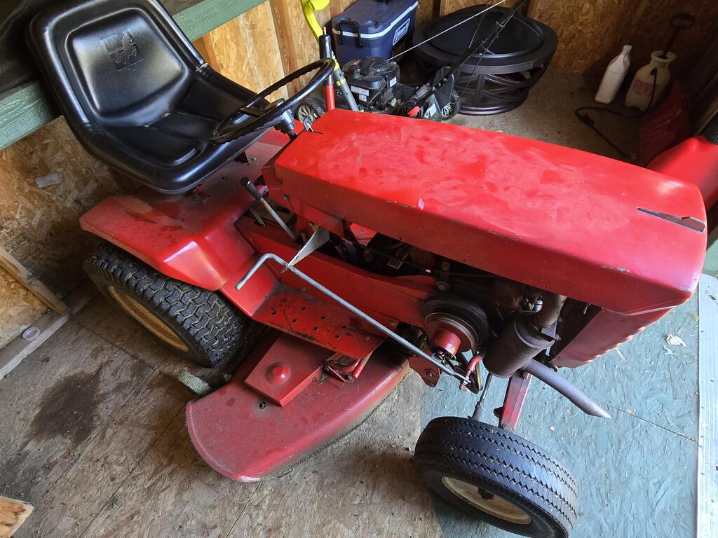

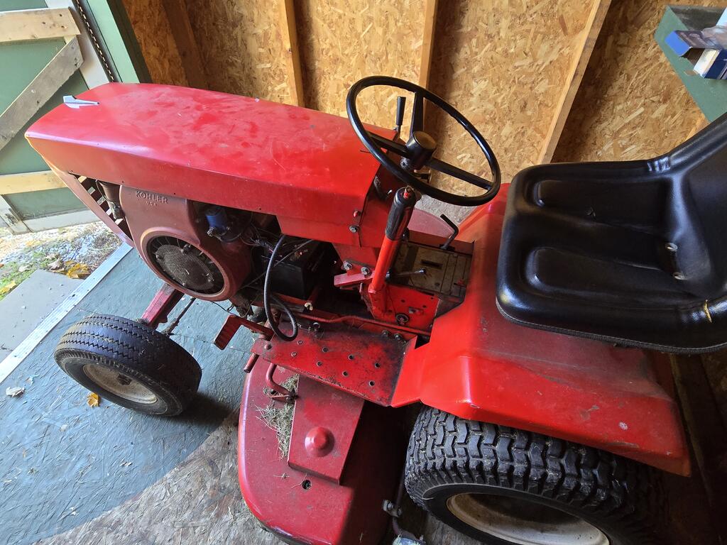

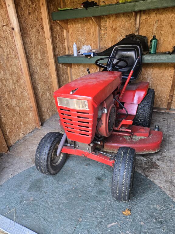

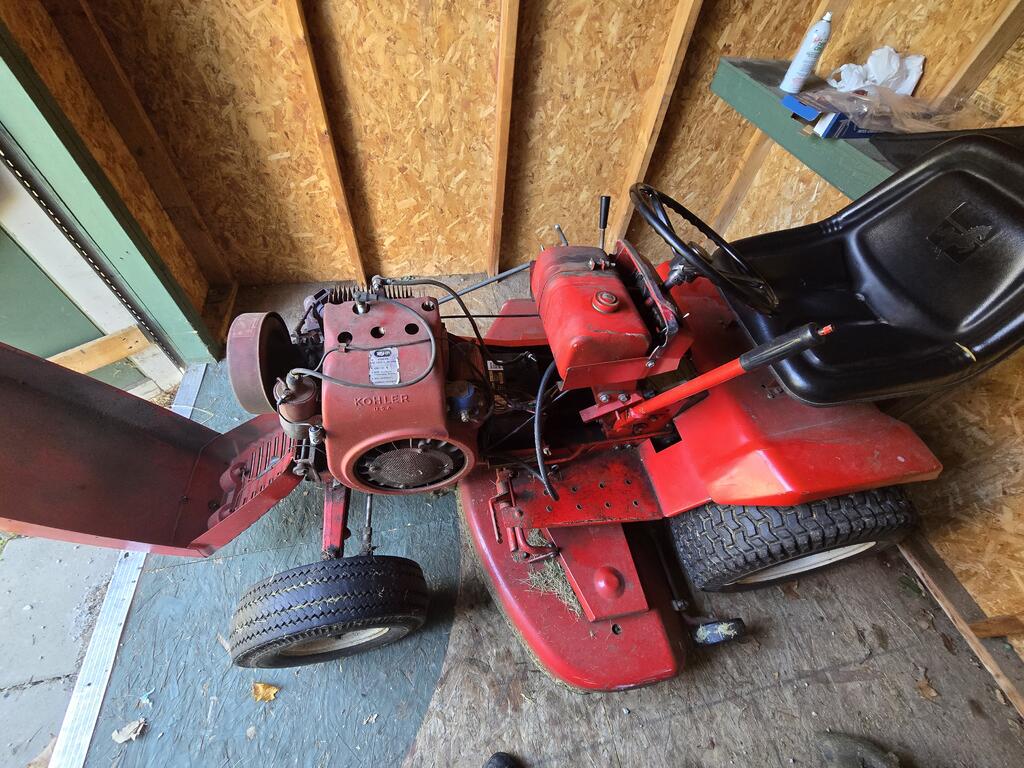

PeytonR 7 #8 Posted October 27, 2024 3 hours ago, ZXT said: Any photos of the tractor? Shes a little dirty but other than that she worked like a champ until she didn't 2 3 Share this post Link to post Share on other sites
Ed Kennell 43,338 #9 Posted October 27, 2024 If you should ever need them, I have parts for the deck side drive system. Other than needing a drive belt and a knob for the PTO lever, any other problems? 2 Share this post Link to post Share on other sites

kpinnc 15,947 #11 Posted October 27, 2024 That machine is quite capable, and has great potential. Whether you restore it or just work and maintain it, it’s a great machine. Well done! 1 1 Share this post Link to post Share on other sites
clueless 3,325 #12 Posted October 28, 2024 Welcome to the (addiction) and the site, nice tractor the only suggestion I have is to find the proper flywheel screen. 3 Share this post Link to post Share on other sites

953 nut 62,580 #16 Posted October 29, 2024 23 hours ago, PeytonR said: Is there a place i can order online or do i have to Frankensteins monster it? Fortunately for you the Tecumseh engine has been replaced by a Kohler so what yo need to search for is a Kohler Flywheel screen. It appears that the engine is a 10 HP K-241 or 12 HP K-301. The engine tag should have a "Spec. Number" on it, this number will identify the correct parts for the engine including the screen. You should also measure the opening in the flywheel cove to be sure you are buying the correct part. Call Lincoln at A-Z Tractor https://www.a-ztractor.com/ or do a search on but remember there are several sizes and configurations of flywheel screens so check the measurements and Spec Numbers. 1 Share this post Link to post Share on other sites
