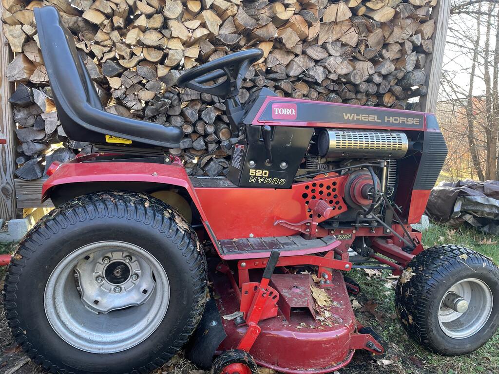

WHX?? 54,963 #5 Posted October 23, 2024 53 minutes ago, Junkyard_sal said: 255 hour machine! Really... any pics? 1 Share this post Link to post Share on other sites

Junkyard_sal 13 #7 Posted October 23, 2024 1 hour ago, WHX?? said: Really... any pics? Will get some tomorrow 2 Share this post Link to post Share on other sites

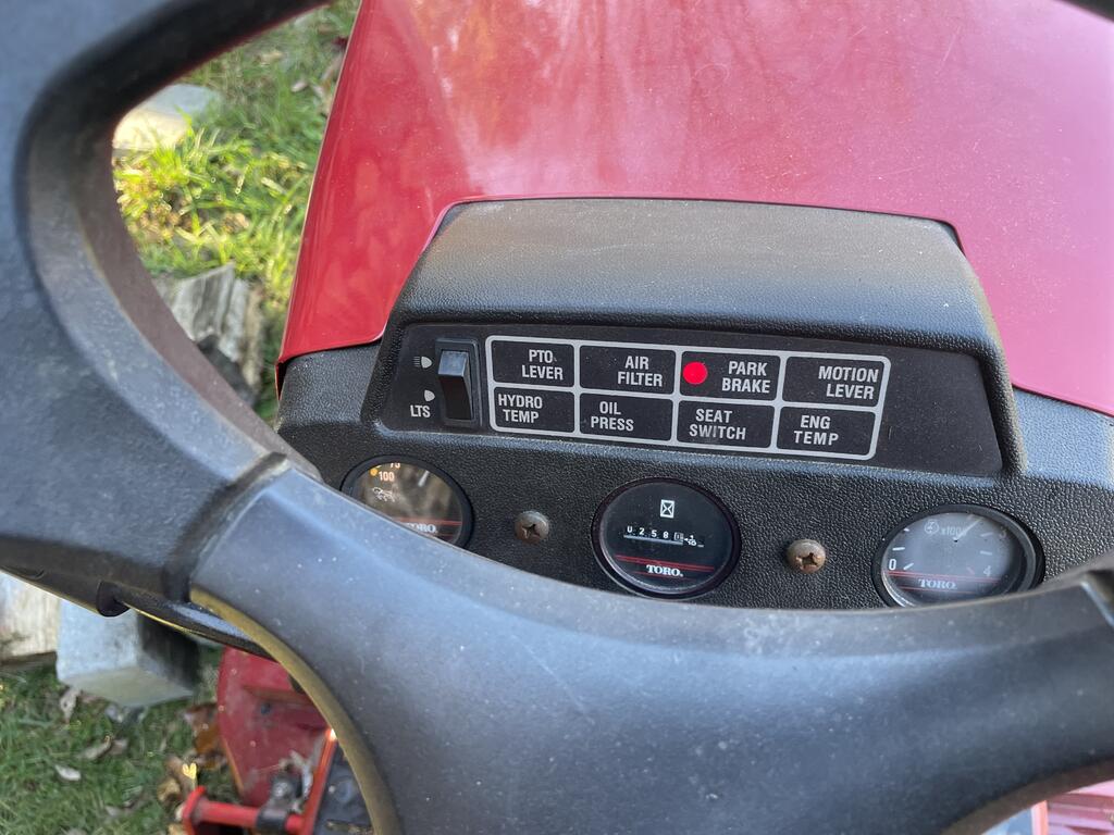

Handy Don 15,934 #9 Posted October 23, 2024 (edited) On 10/22/2024 at 8:20 PM, Junkyard_sal said: this is a 255 hour machine! Primer bulbs were not a factory option, so someone has been in there & probably replaced the lines when the bulb got added. Hours on the machine is essential for mechanical parts, but AGE is a big factor for other stuff like fuel lines and fuel pump diaphrams & check valves. Onan’s can be cranky, especially if their maintenance is ignored and they are stored unprotected. You may need a thorough carb cleaning (I recommend an ultrasonic bath with the proper solution). With no fire on carb cleaner, though, I’d start with checking for power at the ignition coil and for spark. This could be a simple wiring problem. Edited October 25, 2024 by Handy Don 2 Share this post Link to post Share on other sites
Junkyard_sal 13 #10 Posted October 25, 2024 On 10/22/2024 at 9:14 PM, WHX?? said: Really... any pics? 1 Share this post Link to post Share on other sites
Junkyard_sal 13 #11 Posted October 25, 2024 (edited) So I solved the hard starting issue but the tractor hunts on start-up until it gets fully hot. i wonder if I have a leak in the vacuum hose to the fuel pump or in another vacuum hose. I should clean the carb as that upper needle is probably part of the problem for a tractor that has mostly sat for 20+ years anyone else have a 520H that hunts on startup until fully warm? she looks good though doesn’t she Edited October 25, 2024 by Junkyard_sal 1 Share this post Link to post Share on other sites

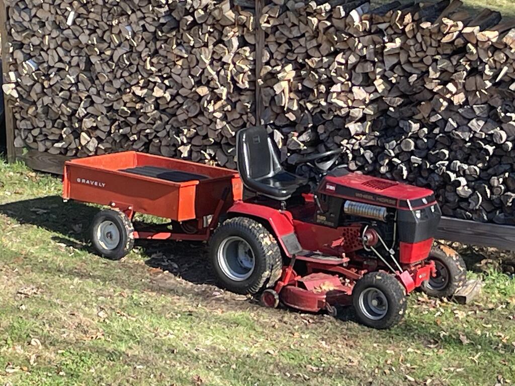

Junkyard_sal 13 #16 Posted October 25, 2024 4 hours ago, lynnmor said: The line to the fuel pump is a pulse hose from the crankcase so not a vacuum problem. Check the intake manifold gaskets at each end and under the carburetor, spraying carb cleaner at those while running might help find a leak but it is a fire hazard. Sometime around the time yours was made carburetors with an accelerator pump were installed so that the mixture could be leaner for emissions purposes, that pump can fail. onanparts.com had those pumps. pump I will start the diagnosis of the intake and the carb. she is doing work now but will be better soon. mixing two great makers. That gravely cart is pretty handy! 2 Share this post Link to post Share on other sites
