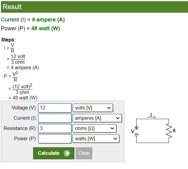

WHX?? 55,696 #9 Posted October 17, 2024 (edited) 15 hours ago, wallfish said: They can also get hot enough to burst. Oil will be all over And you know this because?!?!?! Pics??? A quick 953 nut's law... He came up with this while serving & make believing he was a ET on a tin can in the South Pacific during WW II ... I don't know if I believe it or not ... Me thinks he had bad (coffee??) grounds ... claims he invented radar too ... Edited October 17, 2024 by WHX?? 1 Share this post Link to post Share on other sites
