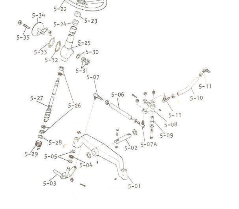

pfrederi 20,878 #26 Posted October 28, 2024 (edited) Jack front end up. Do the wheels turn left and right then? Check the bell crank 5-08 make sure it isn't cracked. also that the two tie rods 5=06 and 5-10 are inplace and move freely. if they are OK problem may be in the steering column itself.. It is a Ross steering column used by other manufactures also (Many John Deeres) and the repair kits are available Edited October 28, 2024 by pfrederi 1 Share this post Link to post Share on other sites
