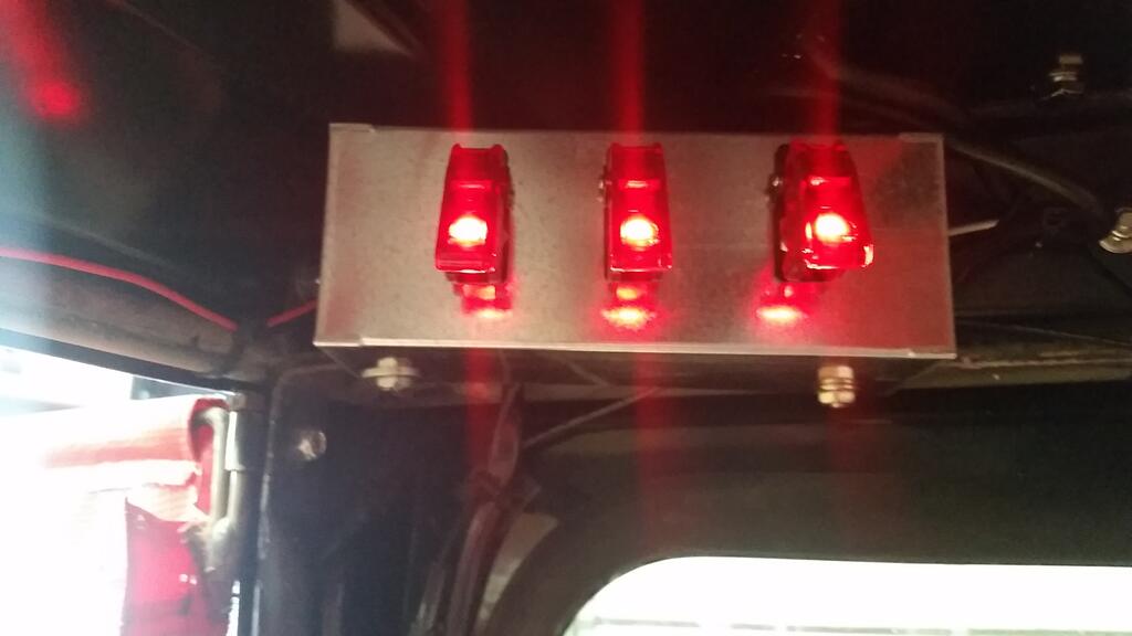

WHX?? 58,388 #101 Posted December 15, 2024 I like that power outlet havta look for those. Just don't t try battery tending through it tho ... don't ask me how I know... 54 minutes ago, Bar Nuthin said: lighted toggle switch Yah I got abit carried away too... In the cab of a 520 with light bars ... 3 Share this post Link to post Share on other sites
kpinnc 19,107 #102 Posted December 15, 2024 4 minutes ago, WHX?? said: Yah I got abit carried away too... In the cab of a 520 with light bars ... Necessities are never too much! 2 1 Share this post Link to post Share on other sites

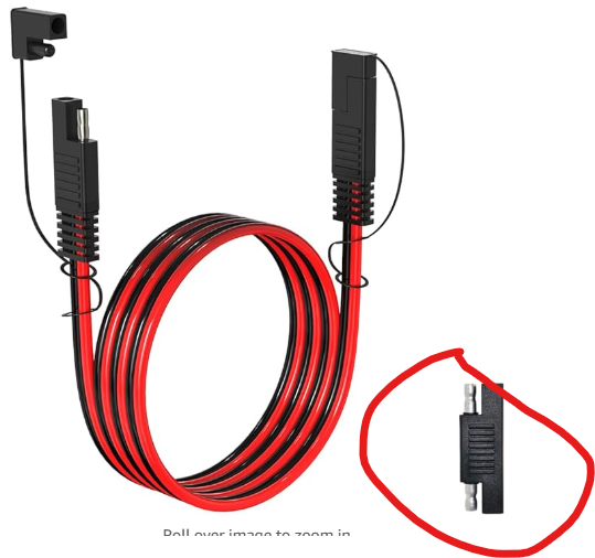

Bar Nuthin 3,645 #103 Posted December 15, 2024 (edited) 18 minutes ago, WHX?? said: Just don't t try battery tending through it tho ... don't ask me how I know... Sorry, but I gotta ask. I haven't had any issues (yet) - but I sure would like to avoid any in the future!! Amazon.com: ELFCULB 2FT 10AWG SAE Power Socket Sidewall Port to O Ring Connecters Extension Cord Cable with 10A 15A 20A 25A 30A Fuse Compatible with Solar Generator Battery Charger,for Solar Accessories : Patio, Lawn & Garden Edited December 15, 2024 by Bar Nuthin added link Share this post Link to post Share on other sites

Bar Nuthin 3,645 #105 Posted December 15, 2024 (edited) 7 minutes ago, ebinmaine said: Neat idea. Can you share more info or links? here's the one I used Amazon.com: ELFCULB 2FT 10AWG SAE Power Socket Sidewall Port to O Ring Connecters Extension Cord Cable with 10A 15A 20A 25A 30A Fuse Compatible with Solar Generator Battery Charger,for Solar Accessories : Patio, Lawn & Garden Direct connection from battery - through toggle switch - to receptacle. I used my own fuses - some wuhan stuff I just don't trust. Wired a 12AWG cord to my weed sprayer. Amazon.com: ELFCULB 12AWG 6FT SAE Extension Cable 3 6 10 20 35 50FT SAE to SAE Quick Disconnect Wire Harness SAE Connector SAE Plug for Automotive RV Battery Solar Panel (6FT) : Patio, Lawn & Garden Edited December 15, 2024 by Bar Nuthin 1 Share this post Link to post Share on other sites
WHX?? 58,388 #106 Posted December 15, 2024 Howd you know I was gonna look in the jungle.?!?! When the power outlet is connected as a outlet the pins are reversed for use with a tender with the same two prong plug that many have. I connected one to tend the battery on the camper. Not thinkin and forgot it was a innie NOT an outie at a show I plugged the 12v camp smoker in ... and promptly burned out the buck & a quarter control module that was not polarity protected. Next show @Achto made me check it first and told me I should have just plugged it in a horse cigar lighter! 3 Share this post Link to post Share on other sites

Bar Nuthin 3,645 #108 Posted December 15, 2024 11 hours ago, WHX?? said: When the power outlet is connected as a outlet the pins are reversed for use with a tender with the same two prong plug that many have. Hmmm. The polarity on mine are correct - but that probably explains why they include a crossover with the cable I bought. Problem is, you'd have to remember to use it. I've been told that as I get older, that memory is the second thing to go. I can't remember what the first thing was. 3 Share this post Link to post Share on other sites
WHX?? 58,388 #109 Posted December 16, 2024 (edited) 14 hours ago, ebinmaine said: AND the wire color is visible so they can't be reversed. They can't be reversed but you can have the other end connected to the battery reversed. I was wondering what that gizmo was for Nuthin. I thought it was to connect two extensions together. I would ring that out before I used it to reverse polarity. Never have to I would have it long lost or forgot where i put it when I needed it... Edited December 16, 2024 by WHX?? 1 Share this post Link to post Share on other sites
