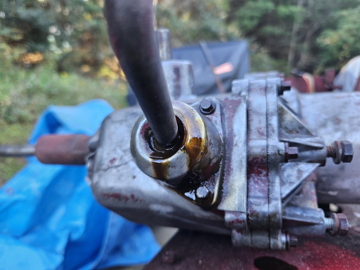

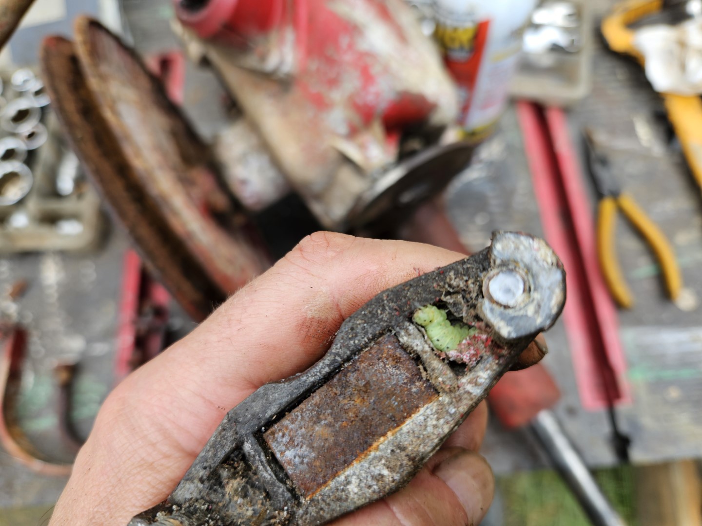

shaggydoink 83 #29 Posted October 1, 2024 I can't say that I am surprised, but the more I dig in, the more I realize that I need to dig in more. While the transmission shifts freely, I discovered the brake was frozen and the main top pulley was in pretty bad shape so out it came. I stripped my first rusted bolt while removing the caliper (documentation is pretty fuzzy so not 100% sure that's what it's called), probably won't be the last. To my surprise I found a worm in it! LOL! I have no clue how the brake works, and found some replacement pads at A-Z Tractor but can't figure out if they'll work... part of tomorrow's learning. Current state for the poor old guy, hoping I can save him! 2 2 Share this post Link to post Share on other sites
ebinmaine 80,087 #30 Posted October 1, 2024 1 hour ago, shaggydoink said: Current state for the poor old guy, hoping I can save him! You're doing great! No worries. 1 hour ago, shaggydoink said: found some replacement pads at A-Z Tractor but can't figure out if they'll work... part of tomorrow's learning. CALL 📞 ☎️ Lincoln at A to Z. He's pretty knowledgeable about tractor-ology in general. Good guy. He may even have some additional insights for your model. 3 Share this post Link to post Share on other sites

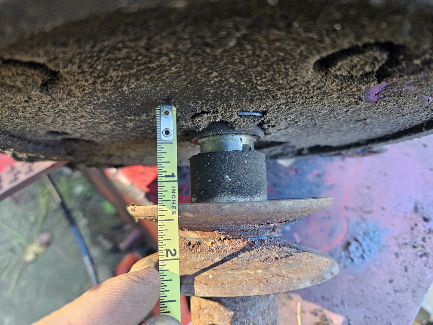

shaggydoink 83 #31 Posted October 3, 2024 On 9/30/2024 at 7:16 PM, Wayne0 said: As long as you can line up the belt and it fits under the hood, anything is possible. We'll help you as needed. OK... it's needed. LOL! I found a few possible replacement engines, ones I've zeroed in on are a Briggs and Stratton 28D707 and a Kawasaki FB460V. Here is where I'm stumped. Both have a 1" x 3.15" long shaft according to my research. The Tecumseh that came with the machine has a shaft length of approximately 4.5", but the pulley that I really care about (the top one) has a 1.75" drop (picture posted earlier). Could a pulley be installed at specific height on a new engine or do I need to be looking for an engine that has a shaft length of 4.5" so I can remove the pulley pair from the Tecumseh (upper belt and lower belt) and install it on a new engine? Hope that makes sense, thanks in advance! Jonathan 1 Share this post Link to post Share on other sites
kpinnc 18,857 #32 Posted October 4, 2024 (edited) 3 hours ago, shaggydoink said: Hope that makes sense, thanks in advance! You’ll be hard pressed to find an engine shaft 4 inches long nowadays. Just over 3 is more common. But, you can use spacers to set the pulley that goes to the transmission on the 3 inch shaft. Also- vertical engines often use a welded collar with both pulleys that is held in place by a bolt into the end of the engine shaft. Finding a comparable replacement shouldn’t be impossible. Edited October 4, 2024 by kpinnc 3 Share this post Link to post Share on other sites
953 nut 68,162 #33 Posted October 4, 2024 If you don't plan to use the mower deck the lower pulley can hang below the end of the crankshaft without any problem. 2 Share this post Link to post Share on other sites

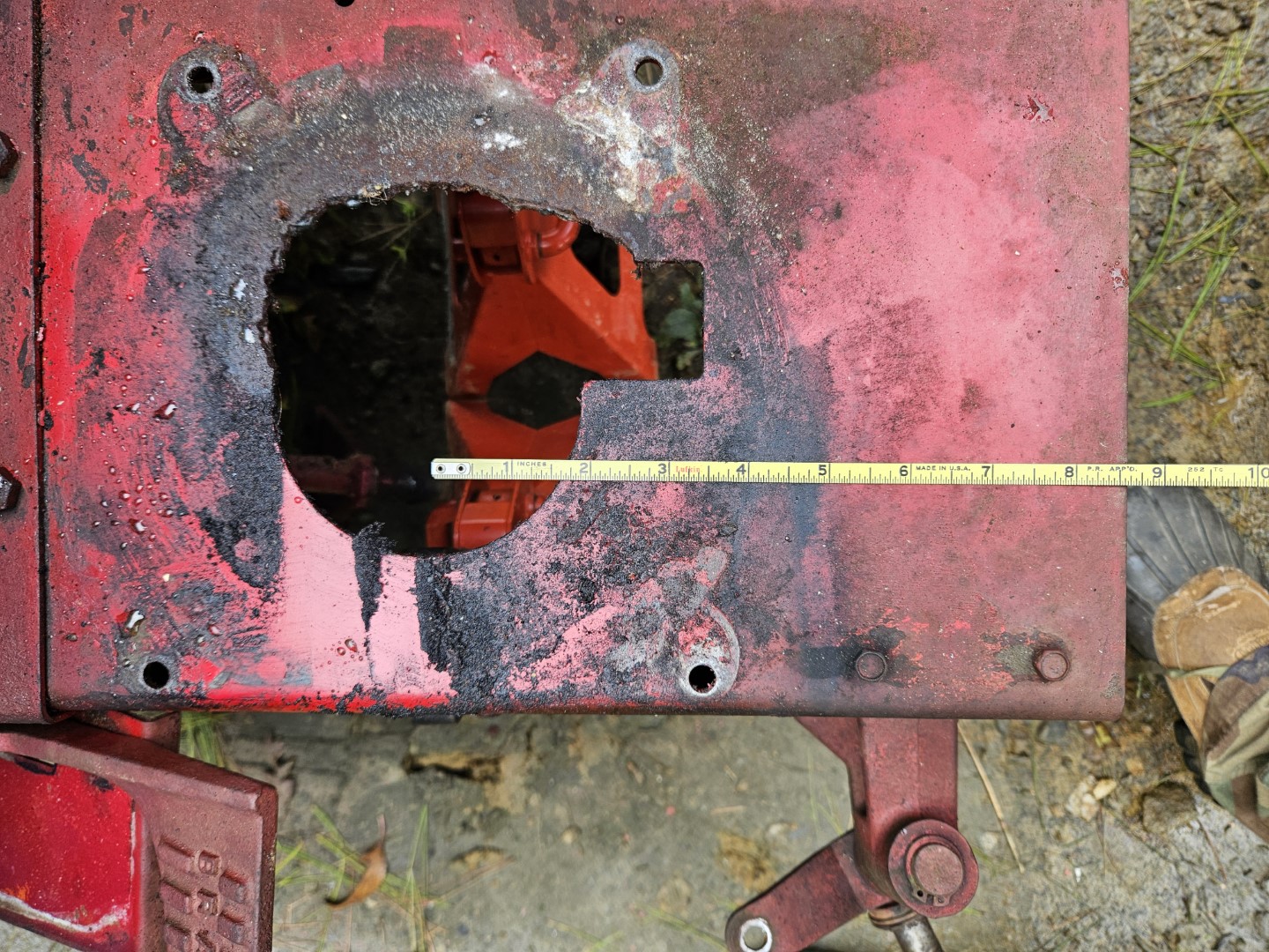

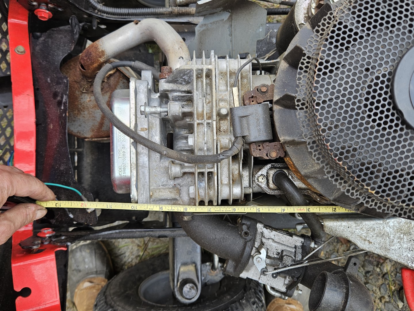

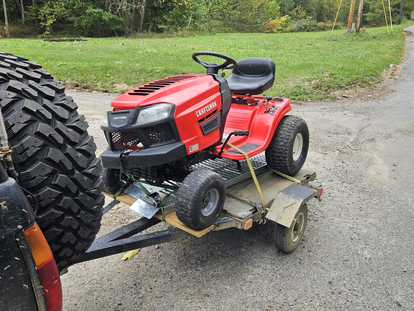

shaggydoink 83 #36 Posted October 4, 2024 Well, I knew this was going to be a learning experience... it didn't even occur to me to check the dimensions of the engine on the T100, turns out it measures 11.5" from the shaft center to the front edge, whereas the A-100 only has room for 8.5" (maybe 9" max). Oops! I'm not overly concerned, my wife actually took a liking to it when she saw it so maybe it too will get some life breathed back into it one day. Back to Facebook Marketplace I go, this time a smidge wiser. Jonathan 2 Share this post Link to post Share on other sites
Wayne0 1,611 #37 Posted October 4, 2024 Hey, the tires are worth more than that! 3 Share this post Link to post Share on other sites

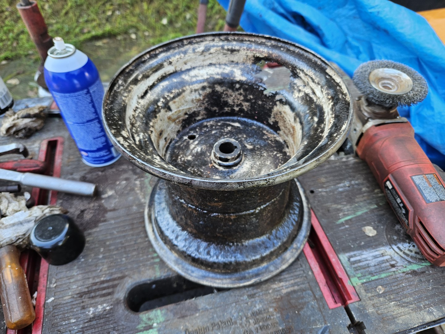

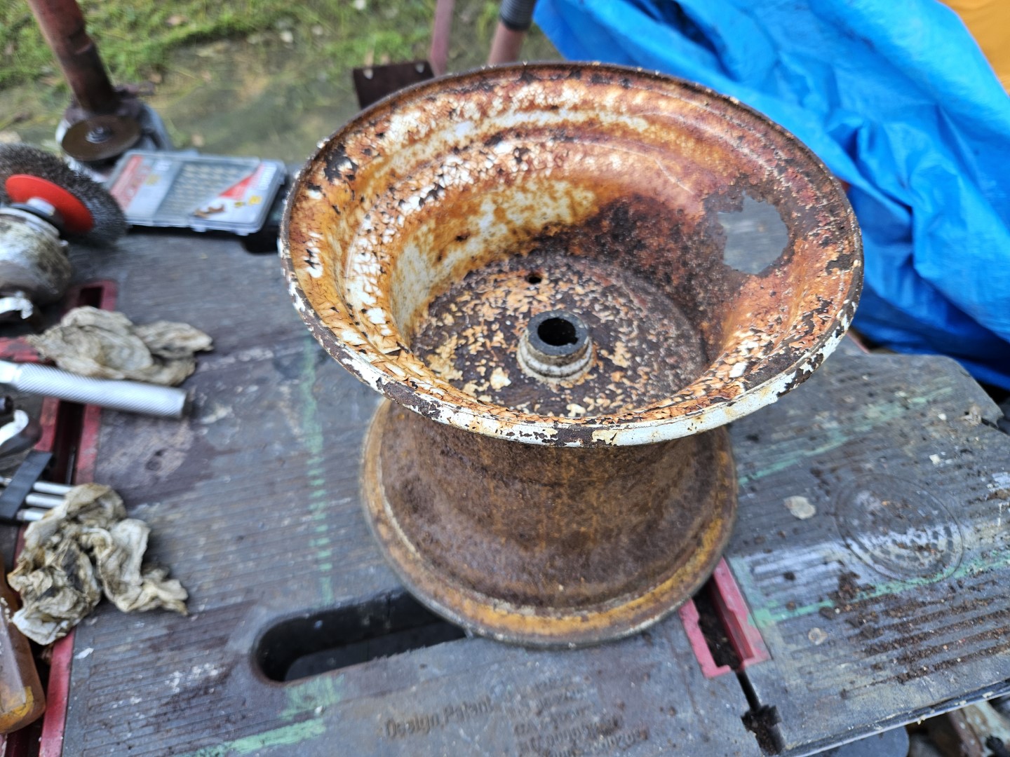

Sailman 1,307 #38 Posted October 5, 2024 Just a thought on the rims. I had some front rims with holes and pin holes, rotted tires setting outside... I cleaned the rims as best I could with wire wheel and die grinder (get rid of any sharp edges). Used epoxy and fiberglass over the larger holes and coated thickened epoxy over pin holes. Painted them and put tires with tubes on them and have had great success keeping them in service. 4 Share this post Link to post Share on other sites

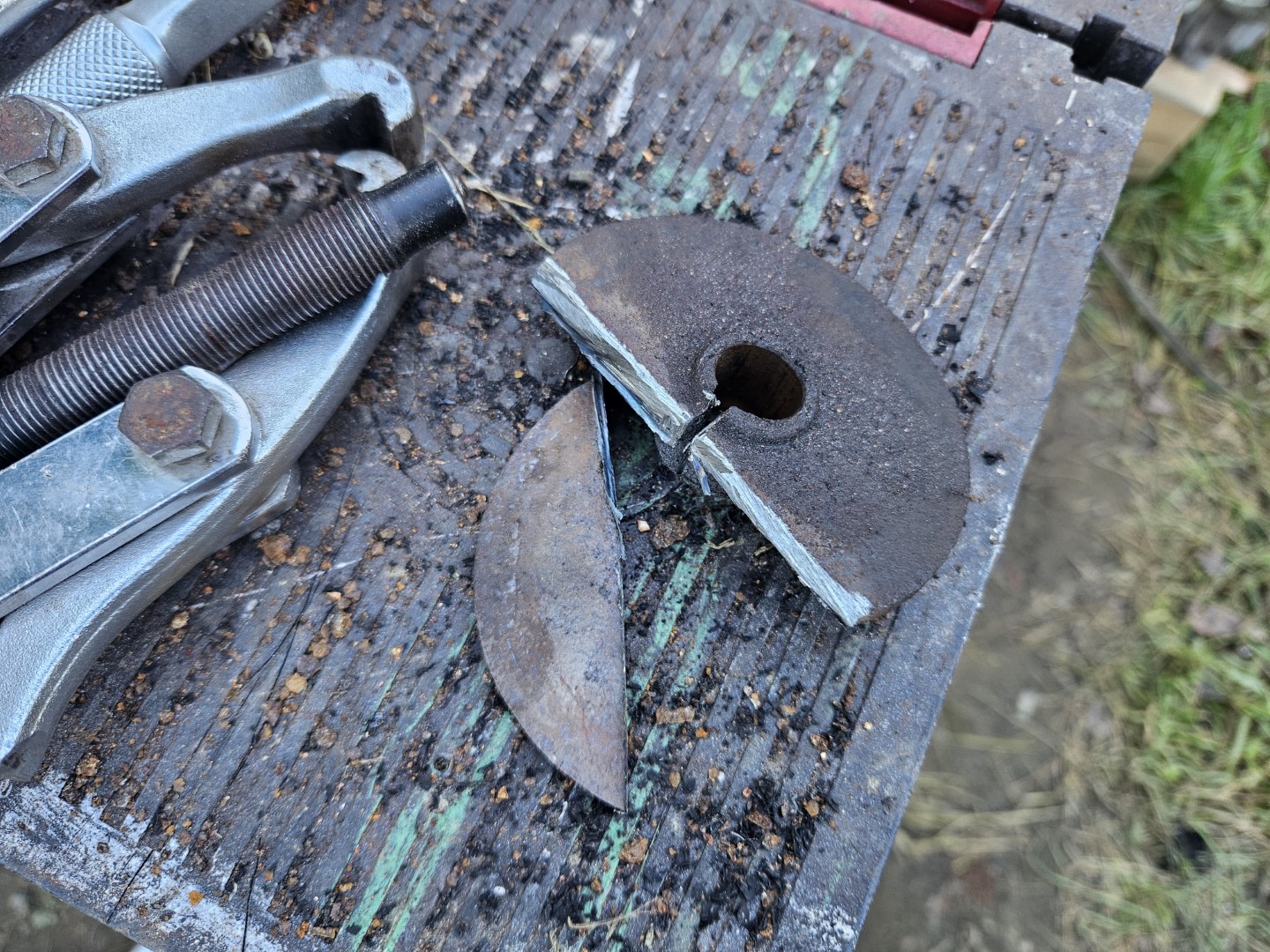

shaggydoink 83 #41 Posted October 9, 2024 I had to head back to my company's HQ for a couple days, but returned this afternoon and got a smidge of work done. The first item was the brake disc which was fused onto the spindle. I drenched it with PB Blaster for several days, tried a couple different pullers, a pickle fork, heat... rinsed, repeated but no go so I finally cut it off and have a replacement on order. I also got the rotted tires and tubes cut free from the front wheels (not quite as bad as the rear ones, but close!), I'll get them cleaned up then do some fiberglass patching next on all four of them. I've also been noticing some junk weeping from the shifter, at first I thought it might just be dirty water as it was sitting outside, but thinking it might be a bad seal? I'll be doing some research on this, but any input would be welcome... and since I'm in the thick of it, I'm feeling like it would make sense for me to drain and put fresh fluid in the transmission? 2 Share this post Link to post Share on other sites

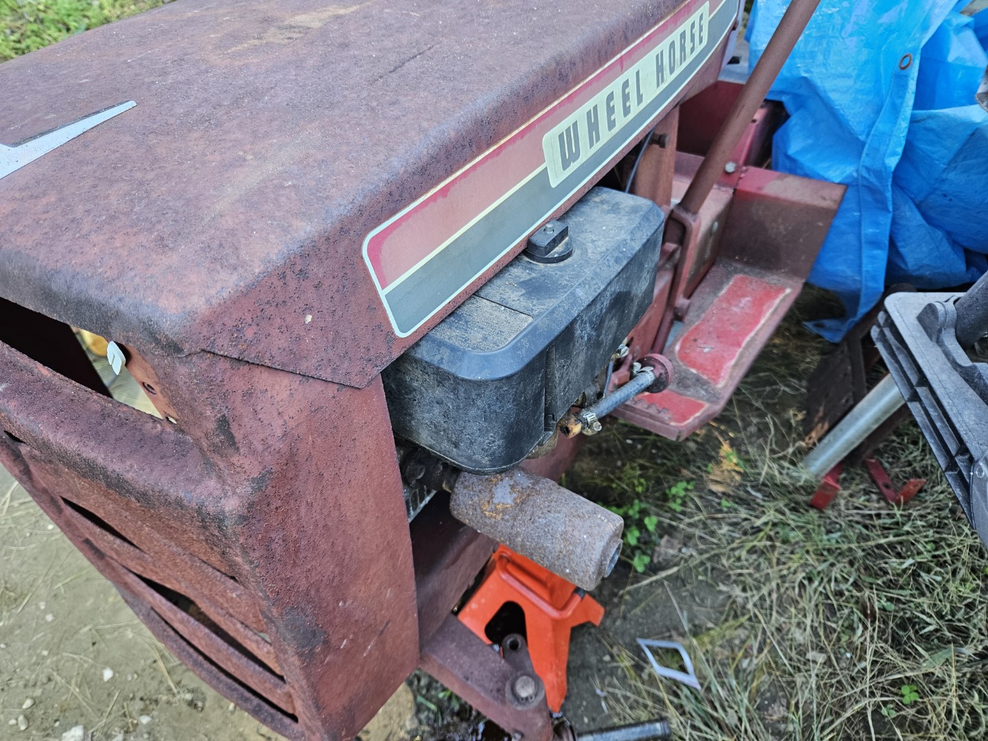

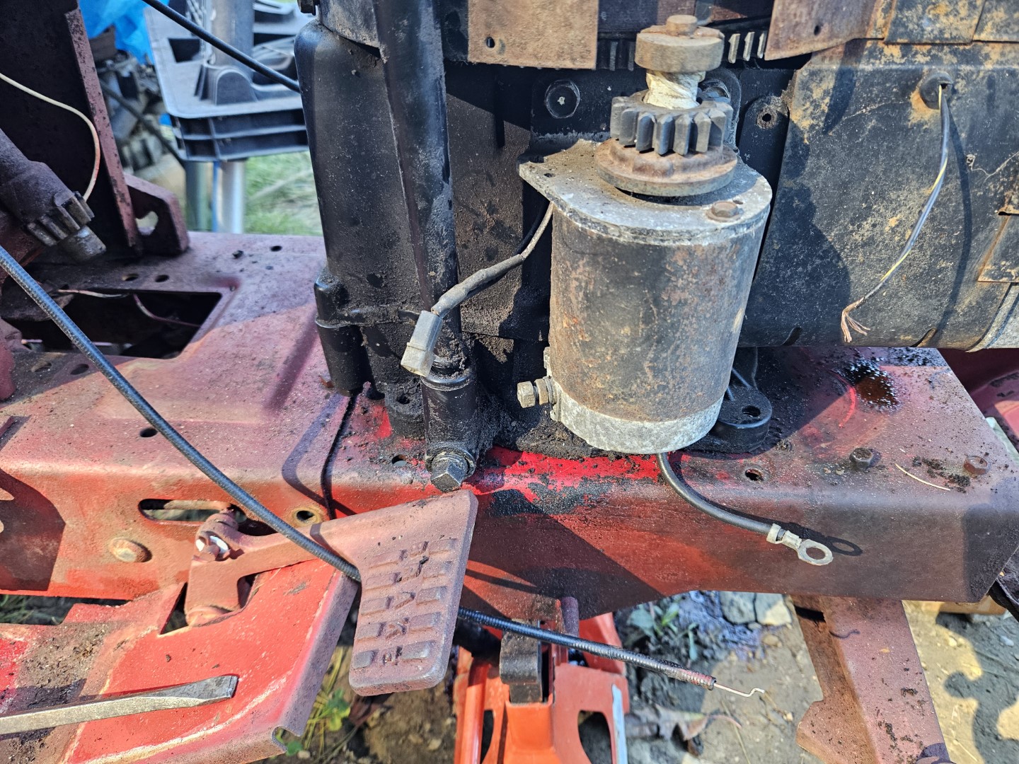

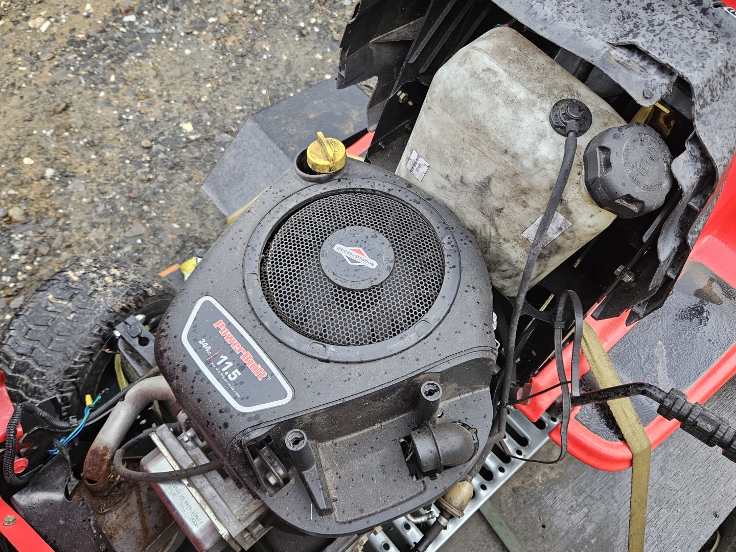

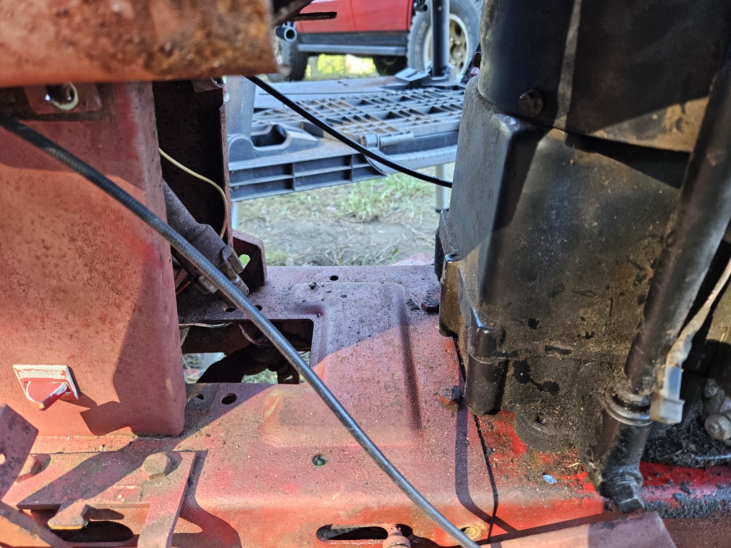

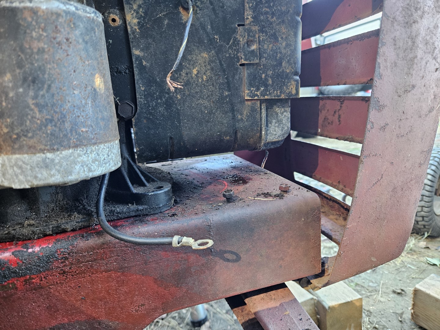

shaggydoink 83 #45 Posted October 10, 2024 (edited) Another mower followed me home today... I'm like a magnet these days! LOL! The price was right at $70. It's got a 12HP Briggs and Stratton I/C engine, I got it placed in the Wheel Horse and was thrilled to see that the bolt pattern was exactly the same as the original Tecumseh from front to back: And I've got good clearance in the front: The air filter looks a little awkward... I may try to relocate or at least do a different cover so it looks a little better: I'll need to do some research to figure out where a battery was supposed to go, but there's a spot where I should be able to house it: The fuel tank? I'll either need to modify the steering console thingy or find something else... The last item is a question... well, two questions. I measured the vertical height of the upper pulley on the driveshaft and it's about 1/4" higher than I need. Question #1, I think this is what y'all meant by adding a spacer... I just need to add something of the proper height to the shaft above the pulley assembly to get the vertical height set right, right? Question #2, I don't have any plans to use this guy as a mower. Is there any reason I couldn't chop off the lower pulley? Jonathan Edited October 10, 2024 by shaggydoink 2 Share this post Link to post Share on other sites

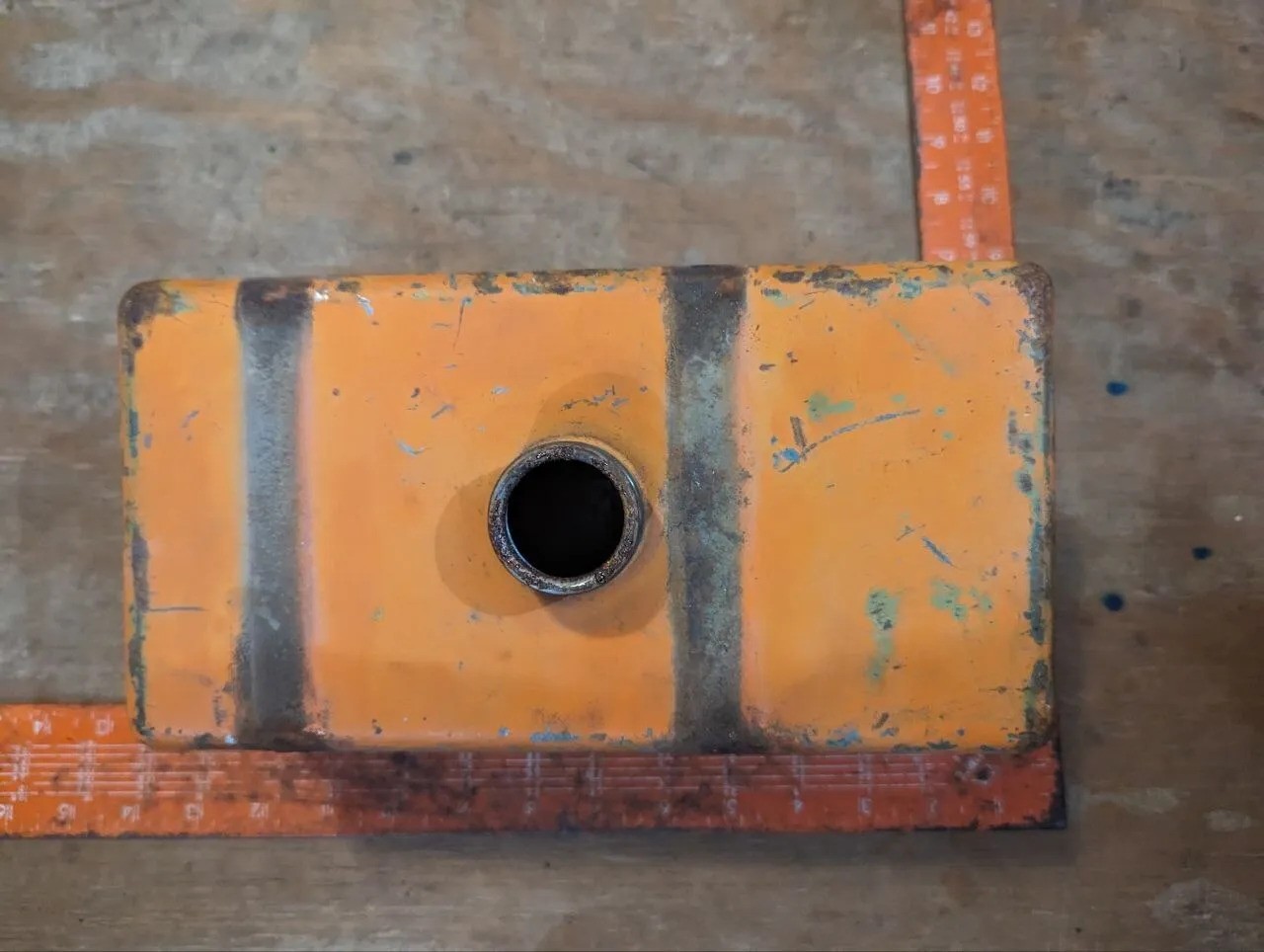

shaggydoink 83 #46 Posted October 11, 2024 I spent a bunch of time early this morning looking for a fuel tank solution, right before giving up I bumped into a listing on eBay. It'll need a little TLC and cap, but it's 10" x 5" x 4" which is perfect! I love the color and patina too, an old tank for an old tractor... so much to do! 1 2 Share this post Link to post Share on other sites

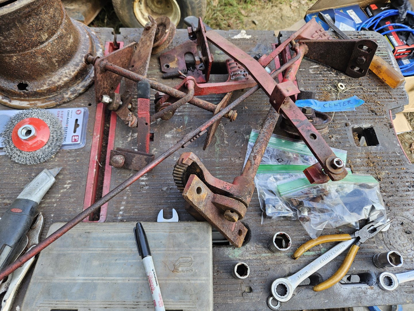

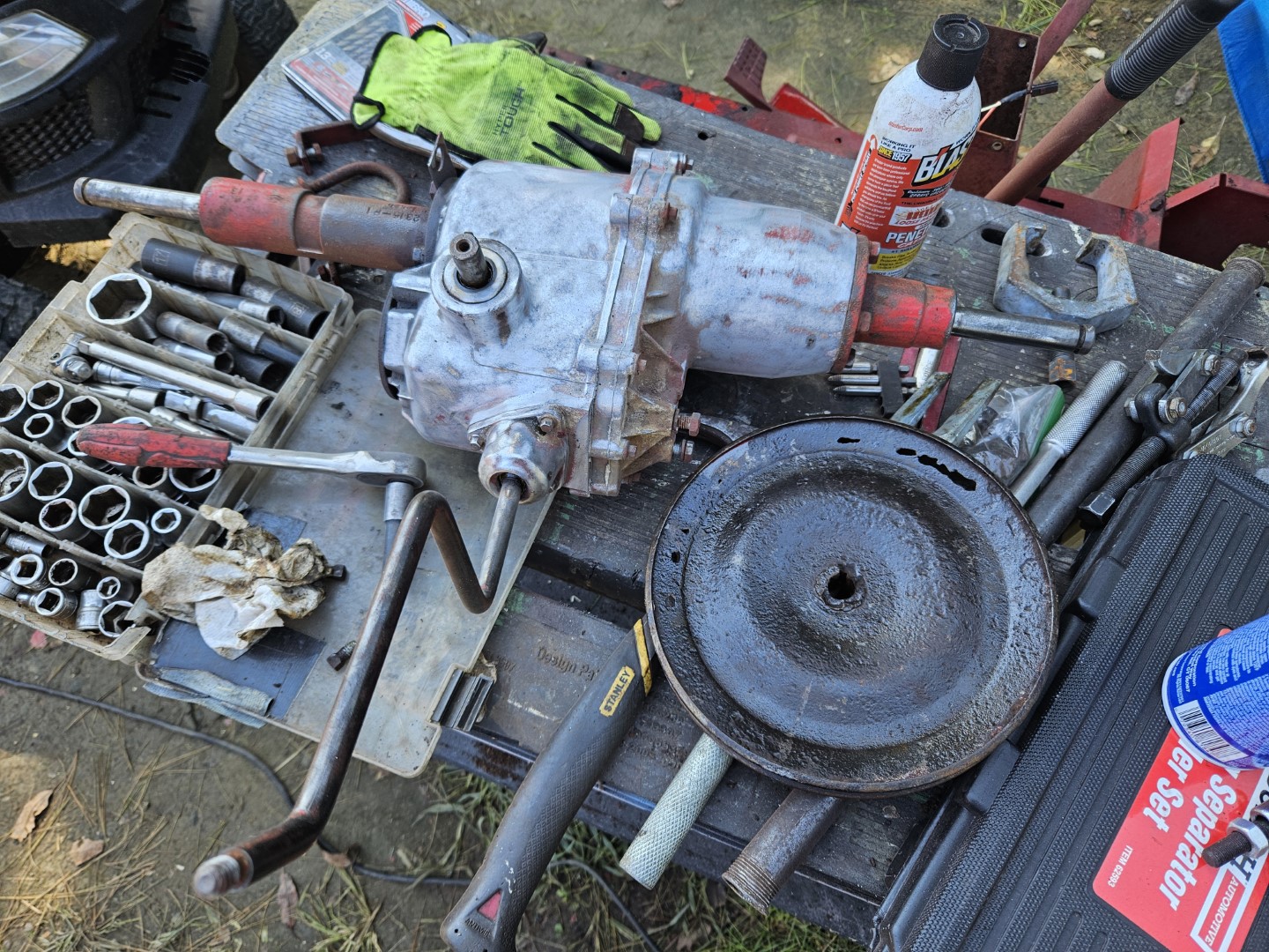

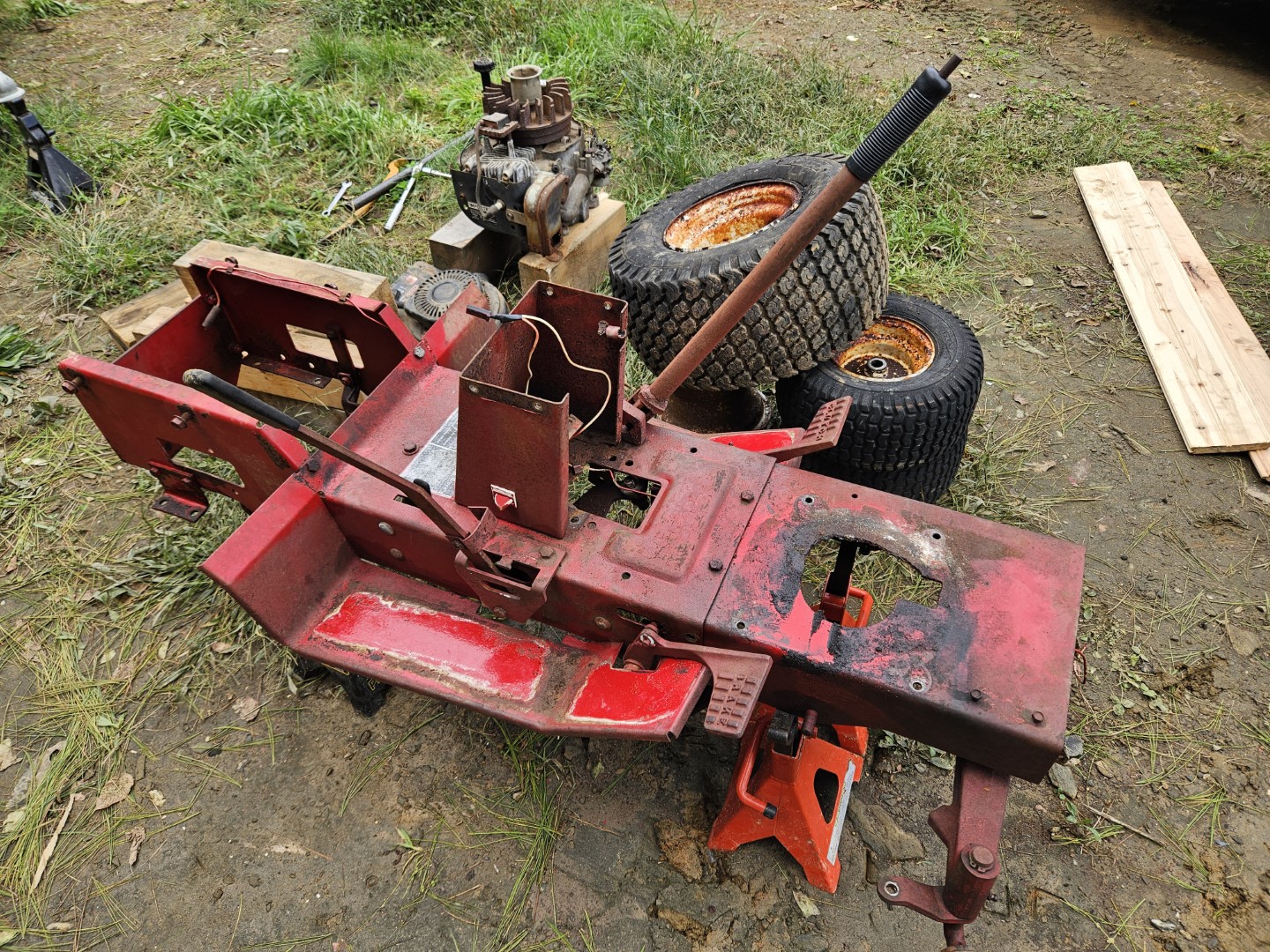

shaggydoink 83 #48 Posted October 13, 2024 (edited) Several of the nearby communities in my area got ravaged by the hurricane so I've been spending most of my free time volunteering the past little bit, I was finally able to get back to wrenching on the A-100 today... or perhaps I should say dismantling it. I've been taking lots of pictures, tagging pieces and storing bolts and various pieces in marked Zip Lock bags - just my way of doing projects, especially in cases where I'm in uncharted waters like this one. I'm about 75% done, next step will be to start cleaning things up and getting into painting which I'm excited for! Jonathan Edited October 13, 2024 by shaggydoink 1 1 Share this post Link to post Share on other sites

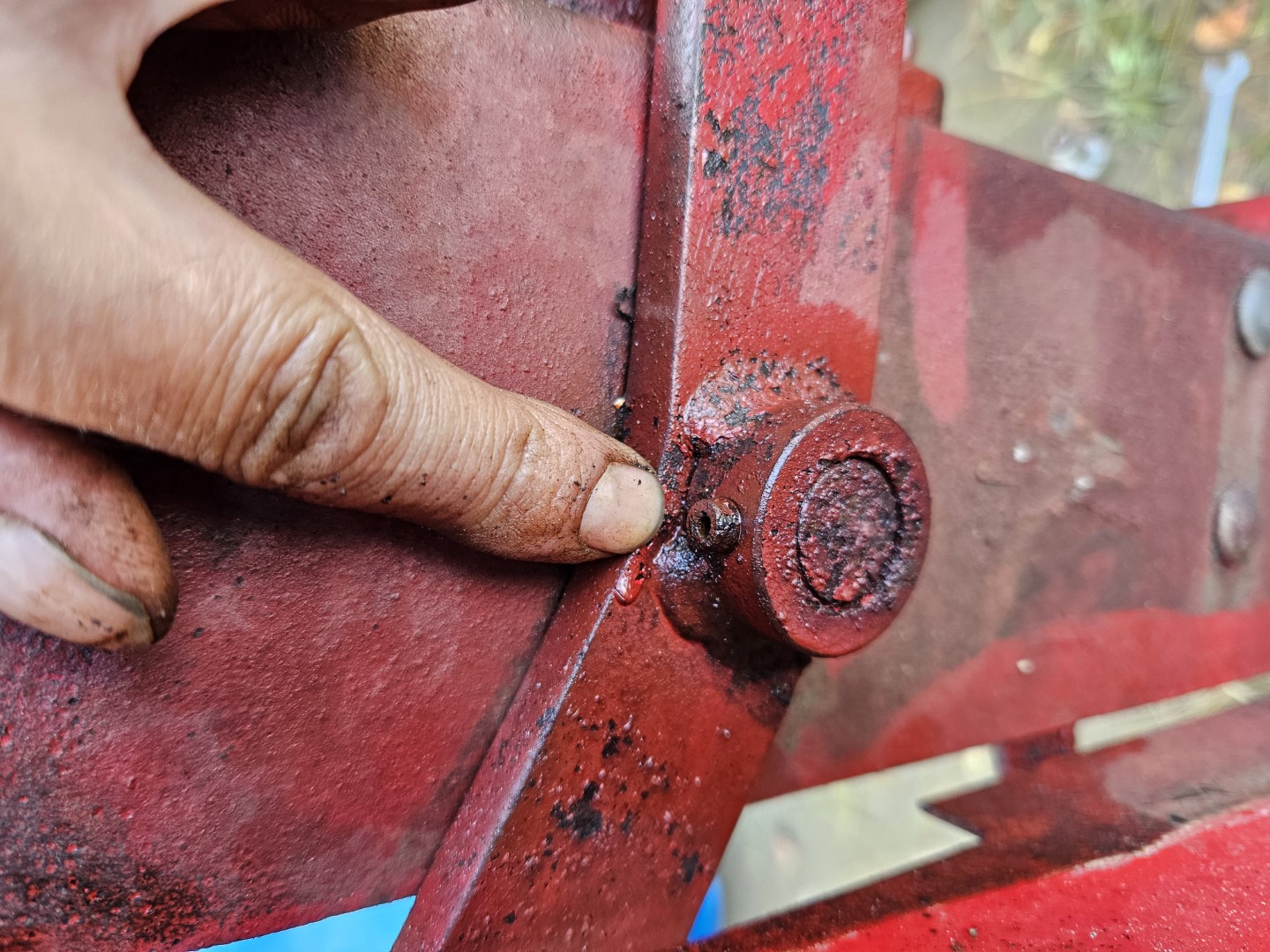

shaggydoink 83 #49 Posted October 13, 2024 Still at 75%, this little demon was the blocker... the roll pin on the lift lever: I sprayed its evil, rusty self with PB Blaster and will try again with a better set of pin punches tomorrow... funny how such little things can wreak such havoc. Jonathan 1 Share this post Link to post Share on other sites
ebinmaine 80,087 #50 Posted October 13, 2024 1. Try a different penetrating oil. 2. Heat it. 3. Try to "back up" the whole machine. Get a board or pipe etc to go from that point to a solid item. Wall. Vehicle hitch or bumper. This takes the flexibility and ability of the tractor to move, out of the equation. 1 Share this post Link to post Share on other sites
