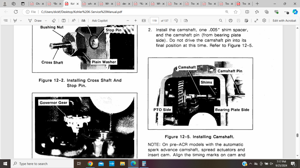

Mike_eash 59 #1 Posted September 25, 2024 Hello guys I am rebuilding a Kohler k241 motor. I have almost everything put back together however I forgot to check my camshaft endplay until now. Manual says .003 -.010 I am at .019 Is that to excessive? Any input is much appreciated Thanks in advance Share this post Link to post Share on other sites
953 nut 64,114 #2 Posted September 25, 2024 (edited) Did you measure the cam endplay before the rebuild? Did you install the shim washed on the camshaft? Edited September 25, 2024 by 953 nut Share this post Link to post Share on other sites
Mike_eash 59 #3 Posted September 25, 2024 I did not measure before the rebuild assuming it's the same as now since nothing changed on the camshaft And yes I did put the shim that was already there back in 1 Share this post Link to post Share on other sites
