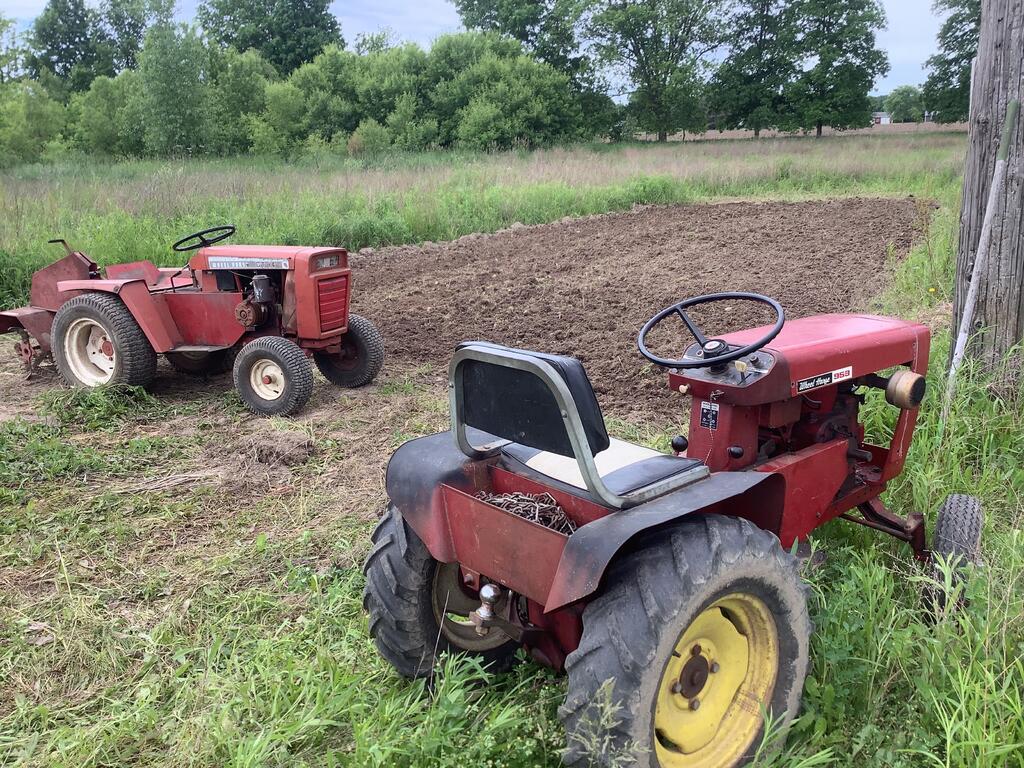

Pullstart 68,767 #4 Posted September 19, 2024 If you’ve ever seen a 953 or 1054 model, they are very close to that size. Pictured here is one of my GT14s and one of my 953s 3 Share this post Link to post Share on other sites
Skwerl58 783 #5 Posted September 19, 2024 That air filter has a neck that attaches to the carb because of limited space because the fuel tank is behind the grille. Look close at Pullstart's picture and you can see the tank. One thing that I like about these old tractors is that when you see and sit on one you realize these are not your everyday "lawn mowers" but a real working piece of equipment. I really like the Kohler power plants, they just sound differrent, have plenty of power and are dependable. I really like the "tall tire" look of the GT14, 953 and 1054 models. These machines surprise us at times because of their capabilities. Hope you find one and enjoy it. 1 Share this post Link to post Share on other sites

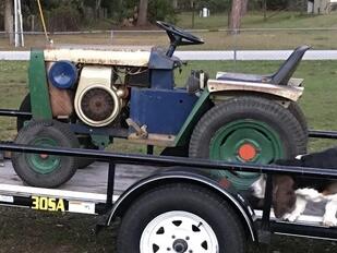

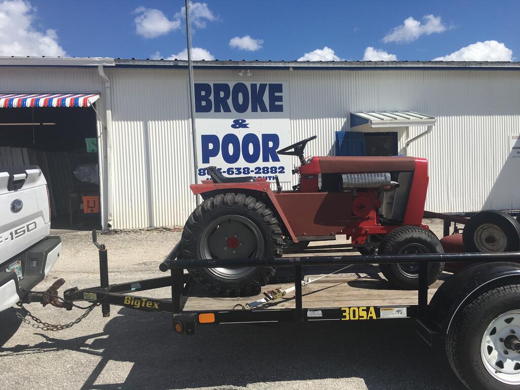

19richie66 17,791 #6 Posted September 19, 2024 (edited) Fell in love with them the first time I saw one. Had to have one. Finally got it and here we are. Same tractor/trailer going back to the show I bought it at. The early models had breakerless ignition while later models had points/coil. Also, make sure you check the fuel tank as it is plastic and known to crack. Edited September 19, 2024 by 19richie66 3 3 Share this post Link to post Share on other sites

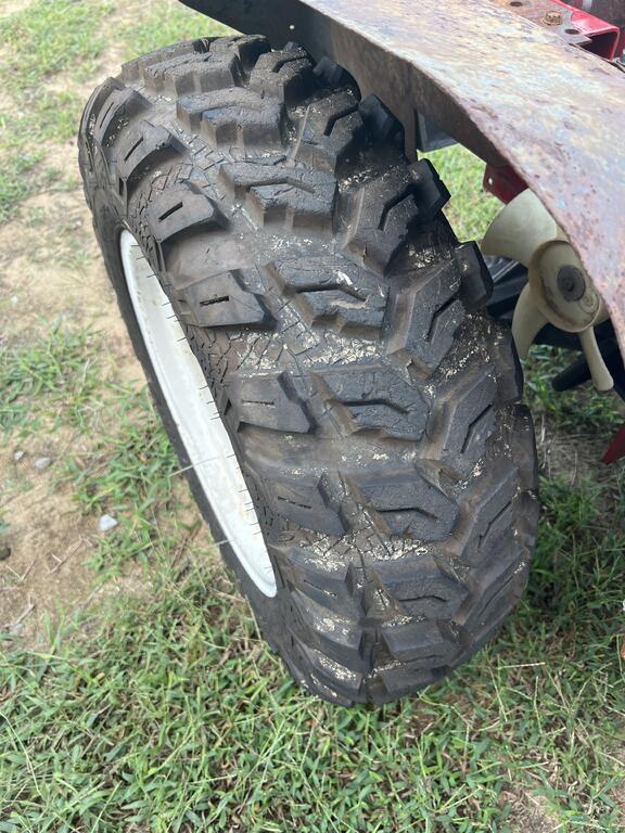

19richie66 17,791 #13 Posted September 22, 2024 (edited) 27-9.0x15 tires on a D series wheel which I believe is the same width as a gt14 wheel. Great traction tire plus good in the sand. Originally on a Can Am UTV. Edited September 22, 2024 by 19richie66 1 Share this post Link to post Share on other sites
