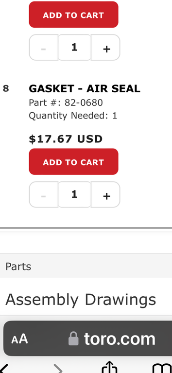

Jose 11 #1 Posted September 12, 2024 Can anybody help me out with how oil filter shroud gasket is installed? Share this post Link to post Share on other sites
lynnmor 8,079 #2 Posted September 13, 2024 Look up Onan 122-0502, I believe that your number is a marked up Toro item. one source The gasket simply pushes in place with the cut out portion at the bottom. If you are experimenting with oil filters other than Onan 122-0800 or Fleetguard LF3339 the gasket may not fit right. It is best to keep the filter clean and dry when installing so there is friction. 1 Share this post Link to post Share on other sites

Jose 11 #4 Posted September 13, 2024 17 hours ago, lynnmor said: Look up Onan 122-0502, I believe that your number is a marked up Toro item. one source The gasket simply pushes in place with the cut out portion at the bottom. If you are experimenting with oil filters other than Onan 122-0800 or Fleetguard LF3339 the gasket may not fit right. It is best to keep the filter clean and dry when installing so there is friction. Thank you, I was not sure what was involved. originally there was not one there, but I had read somewhere that it is good to have because also could cause low pressure to the fuel pump pulse. which I believe I might be having. 520H 73501 1 Share this post Link to post Share on other sites
