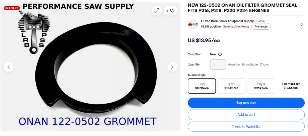

artfull dodger 440 #1 Posted September 4, 2024 Most guys will discuss the pros and cons of the Onan engines till the cows come home. But to keep these happy, four simple things need to be done. The most important is making sure your rubber grommet around the oil filter that seals it to the cooling tin work is in place. Most every Onan I see is missing this on garden tractors. A very simple $6 part, but HIGHLY important to keeping that rear/right side cylinder cool. Without this little rubber part, you loose 30% of your cooling airflow on that side. And that figure is from Onan themselves and does not take into account the belt guard helping restrict cooling air flow on our Horses. Second thing is to do your valve lash adjustment sooner than the book says. In Onan factory schooling they taught us every 250ish hours vs the 600 in the book was the best practice. Valves being held slightly open is one the huge reasons we see popped valve seats on engines. Add in the missing grommet on the oil filter and we have a perfect storm to overheat the engine and superheat the valve seat=popped seat or thrown rods. Three...keep it clean, when you change the oil, clean up your mess, wipe it all down in there, shine a flashlight in there and look, is the seal under the flywheel seeping, or is the jug oil/grime free and dry? Pulling the left/front side cylinder head tin every spring or every oil change is good practice to check for the same along with rodent nests. And finally, run them at full throttle at all times after starting and till just prior to shutting them down. Onans do not tolerate overheating from extended RPM use like a Kohler can. Just nature of the beast and the design of the engine coming from the generator world. Once she is running, throttle up before driving off, drop back to 1/2 to 3/4 to engage PTO, then right back to full power 3600rpm + or - 50rpm with the PTO engaged. Nothing in the small engine world can match the snarl and power of an Onan B or P series, they just take a bit more upkeep to keep them happy. Mike 1 2 2 Share this post Link to post Share on other sites
