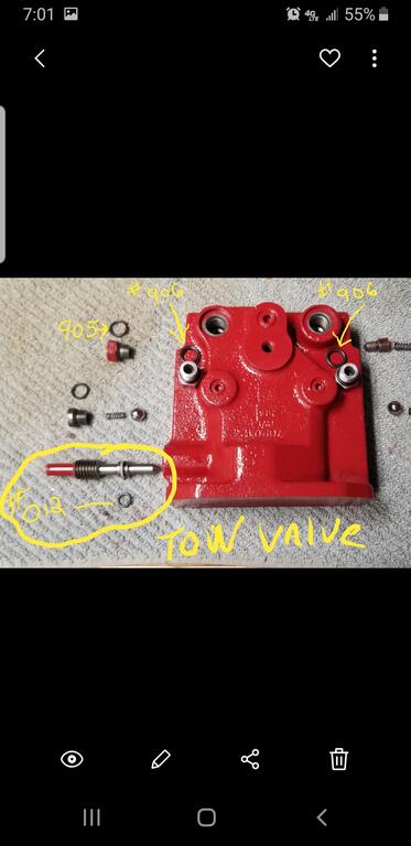

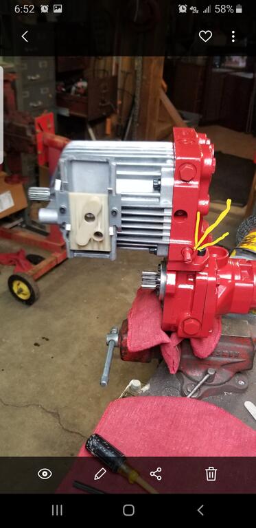

Ed Kennell 47,558 #2 Posted September 2, 2024 The Sundstrands had three different bypass valve locations. 1. a screwdriver slotted stem in front of the left fender. 2. a petcock type valve on the top left of the tranny. 3. a 9/16 hex head bolt on the upper left rear of the tranny. to the 3 Share this post Link to post Share on other sites
gt14rider 1,281 #3 Posted September 2, 2024 This is off my 73 no name 12 auto, like Ed said front left near front of left fender. Screwdriver slot Share this post Link to post Share on other sites

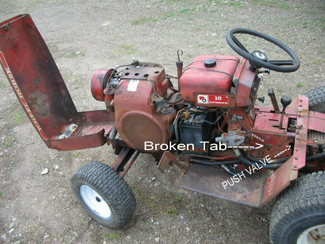

daveoman1966 3,884 #4 Posted September 2, 2024 By your left knee.... hidden in the hoodstand. Marked here as the 'Push Valve'. Share this post Link to post Share on other sites
