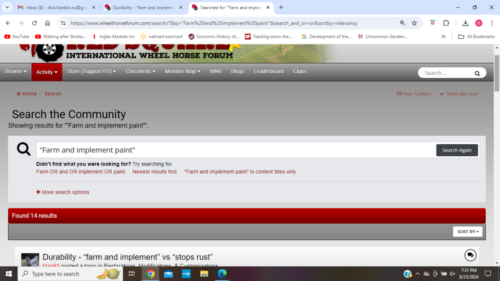

953 nut 64,405 #5 Posted August 23, 2024 6 hours ago, Maz91 said: I’m having a hard time searching it because every post with the word “and” comes up. If you do your search as a phrase in Quotation marks you come up with what you are looking for. https://www.wheelhorseforum.com/search/?&q="Farm and implement paint"&search_and_or=or&sortby=relevancy 2 Share this post Link to post Share on other sites
