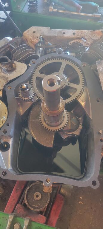

RED-Z06 2,716 #1 Posted August 16, 2024 Ignoring what its in...its a 27hp 44Q977 twin, vertical shaft. 490hrs, no smoke or noises. I got it about a month ago on a trade, it ran "okay" but when put under a load it lost power, like it dropped a lung...1 plug seemed lighter, i ordered an aftermarket carb, immediately ran with power..but, different problem, under load it surged. Not like a lean surge though. I had a customers mower in for a new carb..i put my new carb on his mower and it ran perfectly. I ordered another new aftermarket carb..and same deal. I tried a static governor reset which made no difference. Governor appeared to be working correctly..it compensated and reacted..but it seemed to compensate too quickly. I sucked it up, ordered the $$ oem carb, new gaskets...put it all on, no change. Only thing left is the governor, i had a buddy with 10 years more experience in the industry look at it, he said its probably not the governor. The only thing that im feeling hopeful about, is, if i am running it at 3600...and manually override the governor with my finger, usually the force you feel gets progressively and rapidly stronger pushing back..but this one it gets weaker. Ive never experienced a governor bounce on load, <not> related to a fuel mixture problem, when the problem wasnt an overspeeding engine. Share this post Link to post Share on other sites

RED-Z06 2,716 #13 Posted August 17, 2024 Governor was intact, I replaced it anyways, no slop on the gear shaft, no play in the cross shaft, literally couldn't find a single flaw in anything. Verified its not supposed to have any additional springs anywhere beyond the 2 in place. About to button it back up, not sure what to do that isn't "rigging". Share this post Link to post Share on other sites
RED-Z06 2,716 #14 Posted August 17, 2024 Update: got it all back together and its not surging at all, runs completely different as far as governor response. Had to be a problem there that was so slight that i couldn't detect it visually. 2 Share this post Link to post Share on other sites
