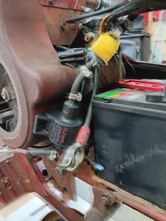

pfrederi 19,878 #19 Posted August 7, 2024 11 minutes ago, Retired Wrencher said: Where did you get your pump. How does this mount up? On the old pump hole? All my electric pumps are under the seat fuel tanks. Pumps push better than suck so I mount them next to the tank. I use Facet posiflo pumps now ..had a 50% failure rate on the cheapie China pumps../ You can leave the old pump in place cap the fuel line fittings... 4 Share this post Link to post Share on other sites
Retired Wrencher 6,449 #20 Posted August 7, 2024 (edited) 16 minutes ago, pfrederi said: All my electric pumps are under the seat fuel tanks. Pumps push better than suck so I mount them next to the tank. I use Facet posiflo pumps now ..had a 50% failure rate on the cheapie China pumps../ You can leave the old pump in place cap the fuel line fittings... So I guess I just tape in to the existing fuel line but with the 856 it will have to be a forward mount. Maybe off the coil bracket. Thanks for all your help. I will get this done. Eventually they will all have these as the old pumps wear out. Did you get this at EBay or other site. OHH Also is there a model number you use and good for 8hp to 12 hp that is what I have. Edited August 7, 2024 by Retired Wrencher Share this post Link to post Share on other sites
pfrederi 19,878 #21 Posted August 7, 2024 (edited) I have used Aircraft spruce as a source also you can use Amazon. I have been using the 1.5 - 4.0 PSI others prefer the 1-2 psi (since your tank is higher and closer 1-2psi should work fine) Facet pumps are made in USA Elmira NY Edited August 7, 2024 by pfrederi 1 1 Share this post Link to post Share on other sites
