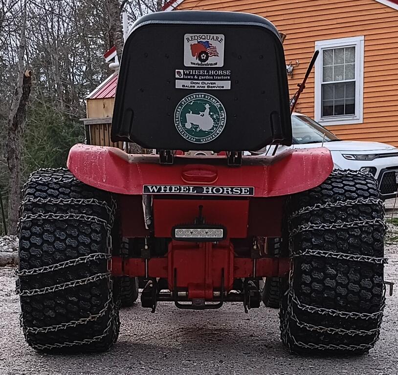

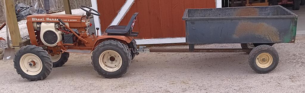

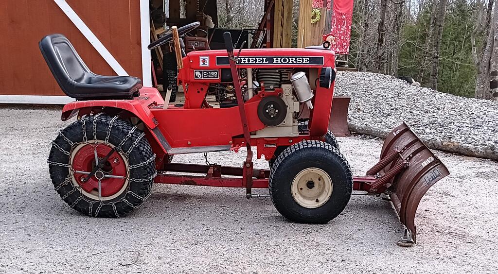

ebinmaine 78,032 #2 Posted August 4, 2024 (edited) I've absolutely done whatever it takes to move my seats back 2 or 3 inches. I am..... "Not small". I've drilled the fender on ones that were already pretty rough. I've use 1.5" to 2" square drilled stock to mount to the fender then bolt the seat to that. These pics show what I've done on two different tractors. Note that the front of the seat is several inches back from the front of the fender pan. Edited August 4, 2024 by ebinmaine Added pics and more info 4 1 Share this post Link to post Share on other sites
