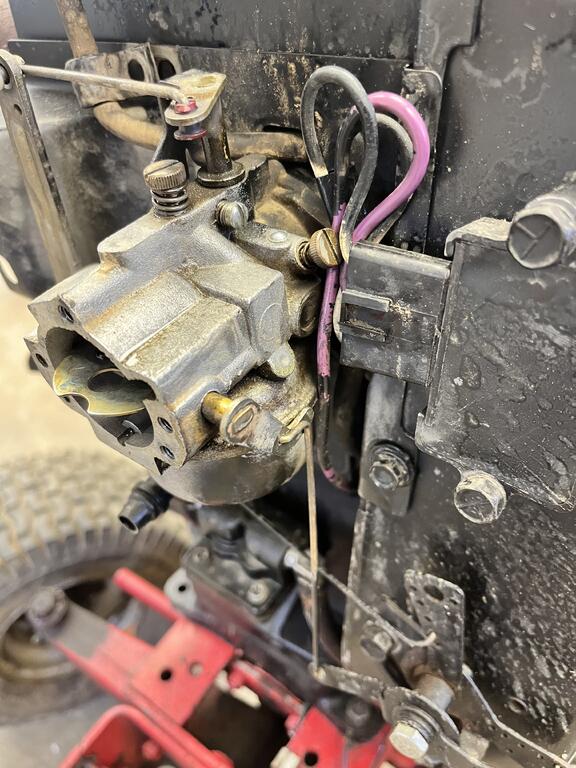

Wvtroutbum81 304 #1 Posted August 1, 2024 Can anyone tell me what model carb this is and rebuild kit part# i have ordered 3 and none are correct number on carb is 4705362 Share this post Link to post Share on other sites
ebinmaine 77,334 #2 Posted August 1, 2024 Looks like that's on a Magnum engine so if anything it should be a Walbro. 1 Share this post Link to post Share on other sites
ebinmaine 77,334 #3 Posted August 1, 2024 Disconnect that upper throttle link from the governor and take a close look at the movement of the throttle shaft. If the bottom bore that holds that throttle shaft is too loose, it's not worth rebuilding. Share this post Link to post Share on other sites
Bill D 2,596 #4 Posted August 1, 2024 2 minutes ago, ebinmaine said: Looks like that's on a Magnum engine so if anything it should be a Walbro. That's a Kohler carb. 25757-01-S should be the rebuild kit you need. 1 1 1 Share this post Link to post Share on other sites
ebinmaine 77,334 #5 Posted August 1, 2024 16 minutes ago, Wvtroutbum81 said: Can anyone tell me what model carb this is and rebuild kit part# i have ordered 3 and none are correct number on carb is 4705362 Where are you getting the kits from and what's wrong about them? 9 minutes ago, Bill D said: That's a Kohler carb. 25757-01-S should be the rebuild kit you need. Nicely done Bill. 1 Share this post Link to post Share on other sites
