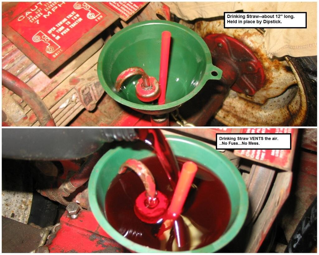

ebinmaine 72,131 #2 Posted August 1, 2024 It helps. We put a long drinking straw in a funnel and that let's air out. 5 Share this post Link to post Share on other sites

daveoman1966 3,839 #5 Posted August 1, 2024 Drink straw in a funnel. I been doing this for years.... No mess. 3 Share this post Link to post Share on other sites
