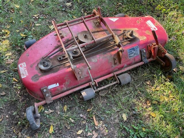

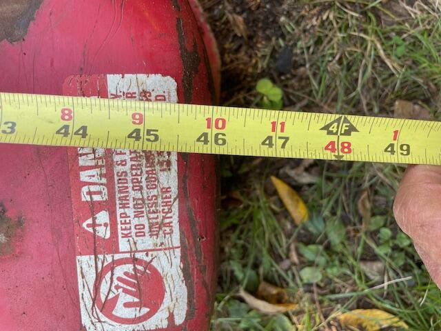

smitty316 25 #106 Posted October 10, 2024 Hi, The tractor's working well and I have it cleaned up. I just drug the deck outside today to dump all the junk out of it. It's been sitting outside for a long time so the pulleys look pretty rough. I can't find any numbers on it anywhere, but maybe these two pictures will give someone enough information to help me out. I haven't taken one off yet. The tractor is a 31-16K802 Thanks, Smitty Share this post Link to post Share on other sites
953 nut 69,357 #107 Posted October 10, 2024 Since your tractor is a 1986 model it is very likely that this is your mower deck. 1 Share this post Link to post Share on other sites
smitty316 25 #108 Posted October 11, 2024 Thank you!! 1 Share this post Link to post Share on other sites

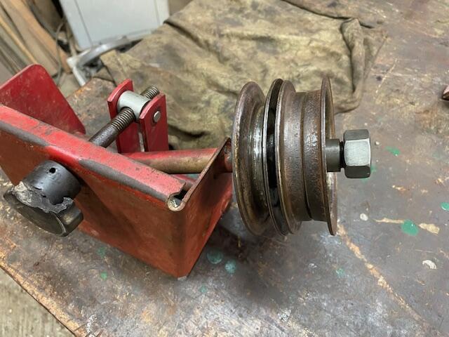

smitty316 25 #109 Posted October 13, 2024 (edited) Hi Guys, I've been working on my deck for this 31-16k802. I need to replace one of the side pulleys. It's listed as 110146. What I've found on line is 5/8" I.D. X 4 3/4" O.D. The side pulleys on mine are 3 3/8" O.D. Did someone change them or am I looking at the wrong part? I could use some help finding the correct pulley. I believe it's the 42" deck. The belt was super tight so I don't know if it's the correct belt either. Thanks, Smitty Edited October 15, 2024 by smitty316 Share this post Link to post Share on other sites
smitty316 25 #110 Posted October 26, 2024 Hi, Is it possible to press the bearings out of these pulleys? It looks like the pulleys are sold with the bearing already in them. Thanks, Smitty Share this post Link to post Share on other sites
oliver2-44 11,753 #111 Posted October 27, 2024 (edited) On 10/26/2024 at 5:22 PM, smitty316 said: Hi, Is it possible to press the bearings out of these pulleys? It looks like the pulleys are sold with the bearing already in them. Thanks, Smitty You can drill the spot weld out on the stamped sheet metal pulleys and replace the bearing. Then bolt it back together with little Allen head screws with lock nuts or locktite. There are some older cast iron mule drive pulleys that you can press the pulley out off Edited October 28, 2024 by oliver2-44 1 Share this post Link to post Share on other sites

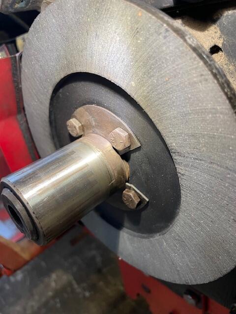

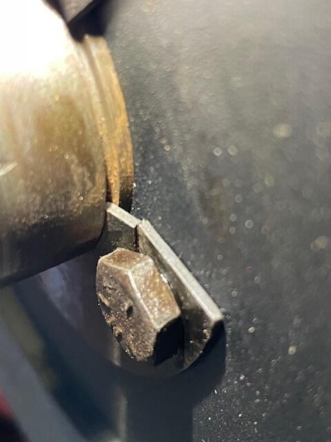

smitty316 25 #112 Posted October 27, 2024 I put on my new PTO clutch disk today. When I started to snug it down the half moon pieces cracked. What did I do wrong here? Thanks, Smitty Share this post Link to post Share on other sites
smitty316 25 #113 Posted October 27, 2024 Should I put washers behind the retainers to get them out closer to the groove so they don't distort this way? Share this post Link to post Share on other sites
Wayne0 1,634 #114 Posted October 28, 2024 On 10/26/2024 at 10:41 PM, oliver2-44 said: You can drill the spot weld out on the stamped sheet metal pulleys and replace the bearing. Then bolt it back together with little Allen head screws with lock nuts or locktite. There are some older cast iron mule drive pulleys that you can press the pulley out off b Pulleys can be had pretty cheap from the bay. Share this post Link to post Share on other sites
