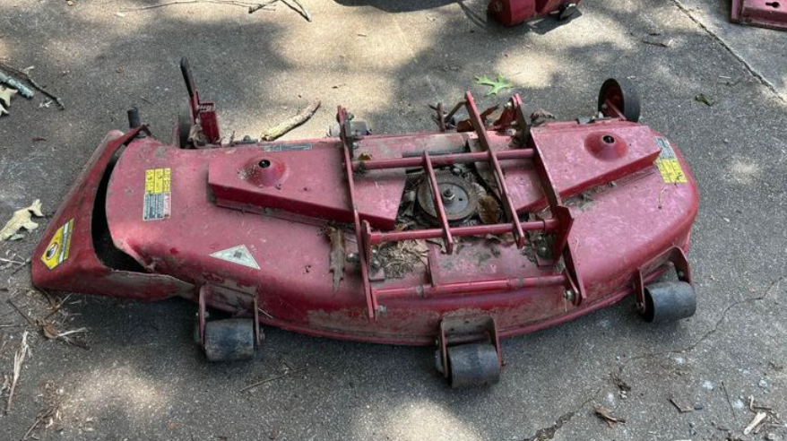

I found this locally (Georgia), will this work?  42"     image.png.52c4d1fc44f3695024531f718a3ad74c.png

cleat
Yes it will.

peter lena
@Ozz  agree that the deck will work , its all the related , movement  functions that are critical . first bottom side look , is it crusty / rusty ?  baffling  loaded with build up ? blade condition ? how easily do the spindles . blades move ? deck looks complete , could still need a refresh , rotational movement issue , rough , usually indicates bearing issues , if deck belt is frayed , heavily  worn , probably related bearing issues . then again you might luck out , not as much as possible , for use . let us know . pete
