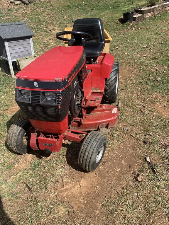

Mike in NC 342 #5 Posted July 29, 2024 Here is my 312-Hydro. I put V-61's on the front and Deestone 23 10.50/12's on the rear. The Deestone 10.50's are about the same weigth of the original 9.50's. All tires are fluid filled. I use this as mt weekly lawn mowing unit. I also use it to put my yard cart around with. 2 1 Share this post Link to post Share on other sites
