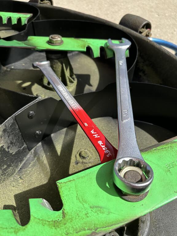

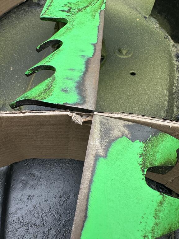

Handy Don 17,735 #26 Posted August 9, 2024 2 hours ago, Steve Janninck said: Looking at the blade tip to tip distance Remember that the closest distance is NOT end to end but corner to corner! Share this post Link to post Share on other sites
Steve Janninck 172 #27 Posted August 9, 2024 51 minutes ago, Handy Don said: Remember that the closest distance is NOT end to end but corner to corner! You are correct sir! That’s not going to be enough space. Will make a small clearance cut out. Thanks Don 2 Share this post Link to post Share on other sites

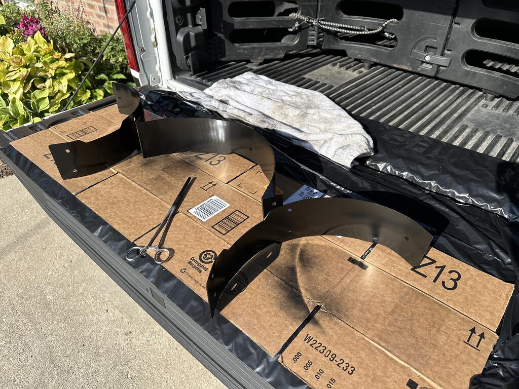

Steve Janninck 172 #28 Posted August 10, 2024 Rev1 Parts All of the parts that make up the “W” are complete. Blade notches included. Everything is bolted in for easy removal. No welded parts on this modification. Steve 1 Share this post Link to post Share on other sites

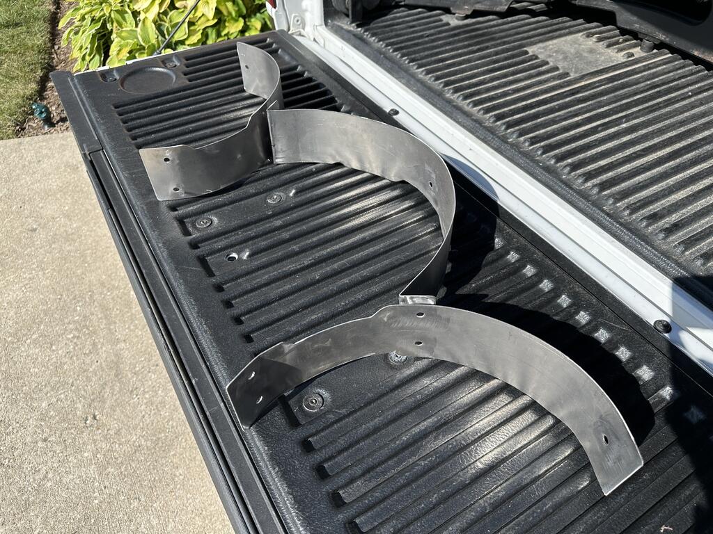

Steve Janninck 172 #30 Posted August 10, 2024 All etch primed and painted! Letting them bake in the sun! I’ll take a couple pictures once everything is back together. Steve 4 Share this post Link to post Share on other sites

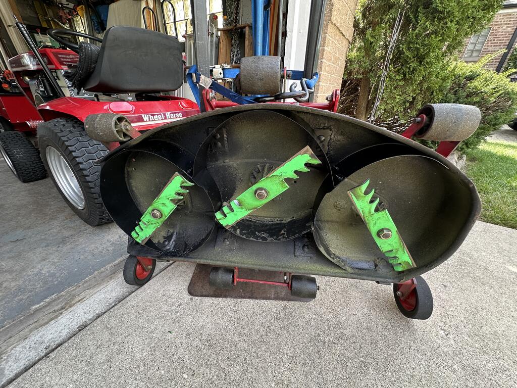

Steve Janninck 172 #32 Posted August 11, 2024 Here is the completed project with all the pieces bolted in place. Tip clearance blade notches provide the perfect window for the blade to pass through. Secondly the notches provide clearance for the spindle nut tool. I will report on the grass mulching performance. Thanks for following along! Steve IMG_2173.mov 4 Share this post Link to post Share on other sites

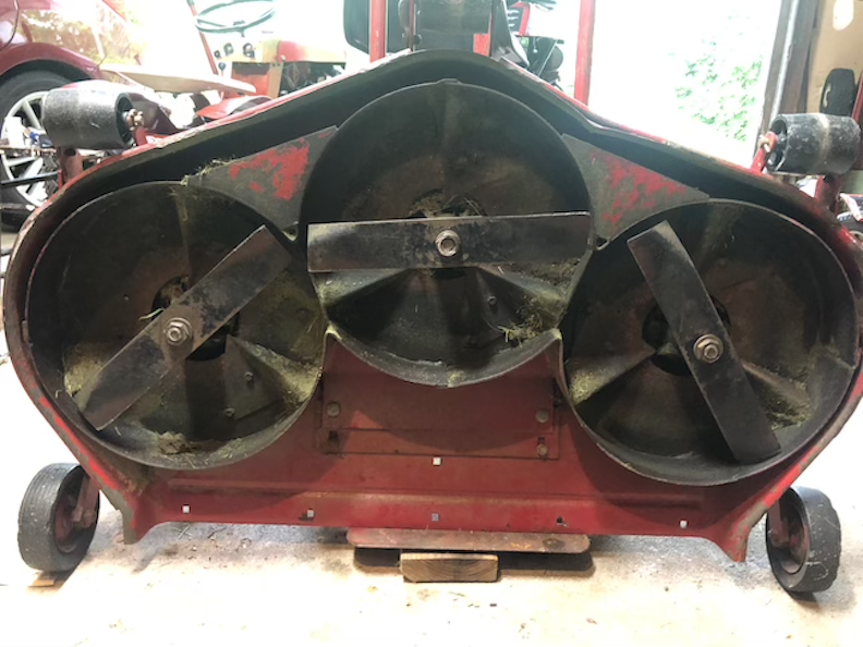

Handy Don 17,735 #33 Posted August 11, 2024 43 minutes ago, Steve Janninck said: Here is the completed project with all the pieces bolted in place Looks remarkably like the WH recycler setup my son has on his 312-H. WH enclosed above the blades (with cutouts for the spindles) and the “wedges” between the curved baffles. This was is a single assembly that bolts under the 42 RD. You can see this one had not had a lot of use before it came to me. When I had the recycler shell out, there was clean original paint on the underside of the shell. Now that I’m looking at it, I’m thinking that removing those flow disrupter baffles might leave room for Gator mulching blades. Hmmmmm 1 1 Share this post Link to post Share on other sites
Steve Janninck 172 #34 Posted August 11, 2024 10 minutes ago, Handy Don said: Looks remarkably like the WH recycler setup my son has on his 312-H. WH enclosed above the blades (with cutouts for the spindles) and the “wedges” between the curved baffles. This was is a single assembly that bolts under the 42 RD. You can see this one had not had a lot of use before it came to me. When I had the recycler shell out, there was clean original paint on the underside of the shell. Now that I’m looking at it, I’m thinking that removing those flow disrupter baffles might leave room for Gator mulching blades. Hmmmmm @Handy Don Don, I really think in concept that what I put together will definitely mulch perfectly. I do think that speed needs to controlled, obviously depending on grass length and leaf cover. Thanks for sharing the picture of your son's real WH accessory. It is so interesting to see the similarities! I have a mulching Honda Push Mower that really does a great job of chopping all so fine. They use a dual blade design that I want to try to duplicate for this deck. Have to exercise my brain muscle to see how to create something similar. Those flow disrupters must be there to knock the trimmings back down into the single cutting edge blade. Very interesting. Thanks Don! Steve 1 Share this post Link to post Share on other sites

Steve Janninck 172 #36 Posted August 18, 2024 Today things finally dried out enough to run the mower around for a couple hours Well I have to say to my surprise the performance on Rev 1 of the mulching deck is great! Chambering all of the blades did the trick for sure. The clippings are even finer than before and I believe this is due to the sustained lift in each chamber. If I run a row of grass at a good clip and run out over the driveway the fine clippings fall out over about 3 to 6 feet onto the pavement. The lift is definitely acting like vacuum cleaner. I can’t speak for leaf mulching yet, but I think the results and testing are right around the corner. Stay tuned, Steve 1 2 Share this post Link to post Share on other sites
