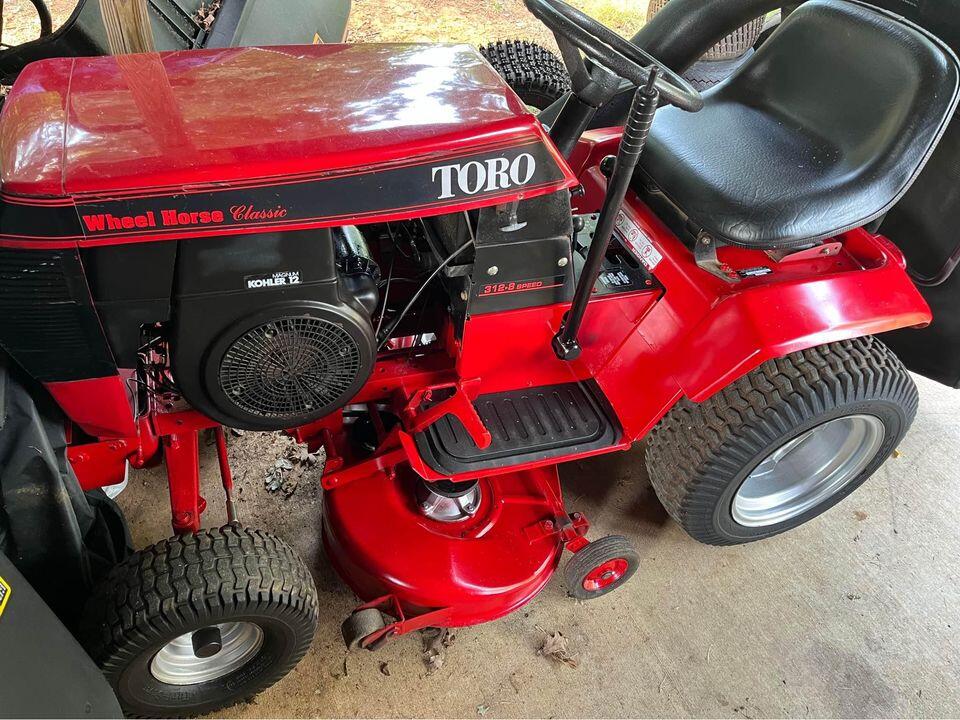

JCD 80 #1 Posted July 24, 2024 I've never messed with tractor tires and I'm a bit confused, none of my tires front or back have a valve stem. Does that mean they are solid tires? All my tires have cracks in them not sure if they need to be replaced or not. They look great in the pic but have small cracks everywhere, sidewalls, tread Tire size is front 15x6.00x6, rear 22x7.50x12 Thanks, Jim Share this post Link to post Share on other sites

8ntruck 8,097 #8 Posted July 24, 2024 Typically, wheel weights are mounted to the outside of the wheels. The typical wheel wheel weight does not have access for a valve stem, making the inside of the wheel the logical place for the valve stem. The cracks that you see in your tires are called ozone checking. These cracks develop in old tires due to exposure to the elements over time. Eventually, the tires will start leaking. Are they a problem? As long as the tires are holding air, they will be useable, since a Wheel Horse is a low speed, relatively low load application. Ozone checked tires on a car are a different story. They are much more likely to fail when used - especially at higher speeds where heat builds up in tires. 2 1 Share this post Link to post Share on other sites
