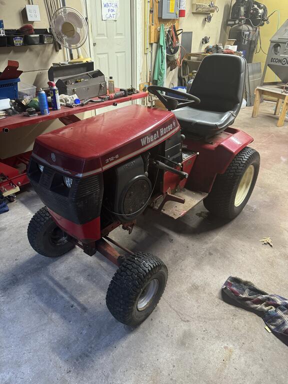

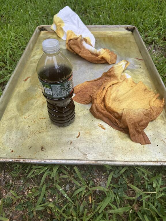

PWL216 1,148 #1 Posted July 24, 2024 I bought a 312–8 a while back that came with no deck and a snowblower, for $250. It has almost 3000 hours on it. The guy I got it from got it from his father - but he never used it. It sat in his garage for 20 years. I pulled it into the garage tonight to tinker with it a bit. I drained the gas, which was disgusting. It smelled like pure lacquer. I cleaned the gas tank and dropped the carb bowl, which wasn’t actually that bad and cleaned it as well. I put fresh gas in it and a new battery. One crank of the key and it started right up. Couple minutes later I was driving it around my yard. I needed that win because I’ve had a couple of tough tractor issues lately! I’ll change the fuel line and add a filter and primer bulb as well as change the fluids. I have a 42” RD deck I picked up at the BS that will go on it. From there it’s going to my nephew who just bought a house on Cape Cod. 9 9 Share this post Link to post Share on other sites

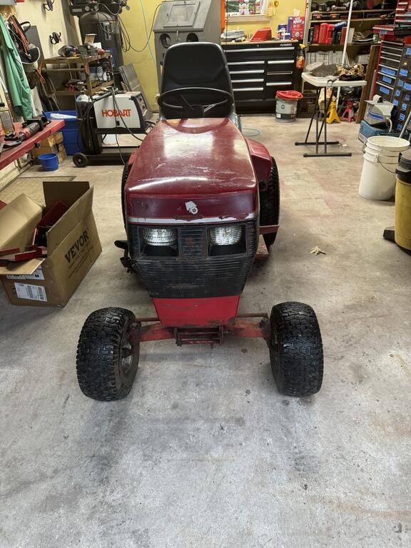

Lee1977 7,631 #10 Posted July 25, 2024 It's a 1985 model they are the only 312-8 with narrow rims front and rear. I got mine free but lost a good friend to cancer. It also has a 3 amp. battery charging alternator The light only work with the engine running. Here is a picture of mine, I changed to different wheels and tires. 2 1 Share this post Link to post Share on other sites
