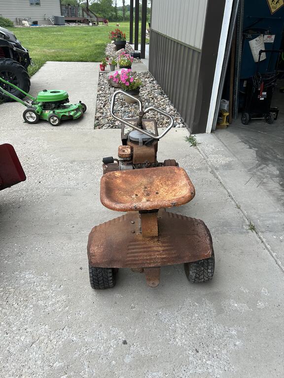

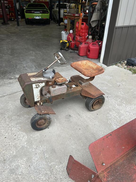

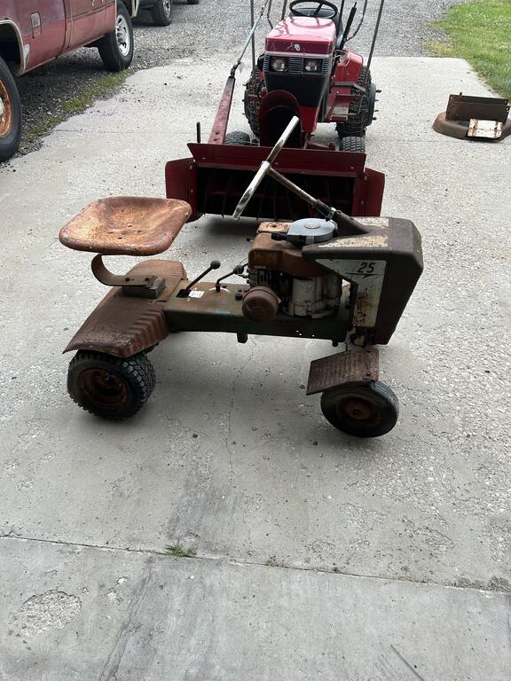

Keaton 466 #1 Posted July 20, 2024 (edited) I got this Springfield with my 310-8 and I need help on the engine, year and model, it says Springfield 25 on the hood, Wich is for the 25 inch deck, it is a nice teal blue, transmission shifts good I think it is a peerless, because of the look and shifter cup, no idea about year or engine except it is a Briggs and no idea on the tranny- Thanks, Keaton. Edited July 20, 2024 by Keaton Photos 1 Share this post Link to post Share on other sites

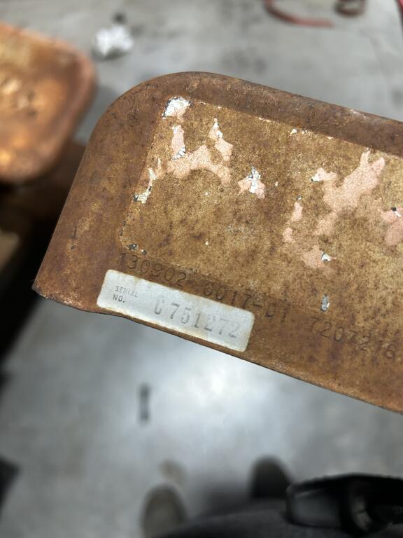

Keaton 466 #2 Posted July 20, 2024 And the engine serial number might help… the serial is c751272 Share this post Link to post Share on other sites
Achto 31,244 #3 Posted July 20, 2024 (edited) The B&S 130000 series are a 5hp engine. Your engine was made on July 21 of 1972, according to this year date it may be a replacement engine. Edited July 20, 2024 by Achto 2 1 Share this post Link to post Share on other sites

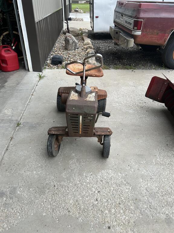

Achto 31,244 #4 Posted July 20, 2024 (edited) This might help ID the tractor. https://www.tractordata.com/lawn-tractors/tractor-brands/springfield/springfield-lawn-tractors.html Most of the Spingfield 25" mowers I see have a swing handle for steering, yours has an actual steering wheel. I think it may be a late '65 or '66 model?? Edited July 20, 2024 by Achto 1 Share this post Link to post Share on other sites
Keaton 466 #5 Posted July 20, 2024 I see the 25 but all of them have a tiller type steering and thank you @Achto 1 Share this post Link to post Share on other sites
Keaton 466 #6 Posted July 20, 2024 I found the tractor it s a springfeild 1964 model 64a 2 Share this post Link to post Share on other sites

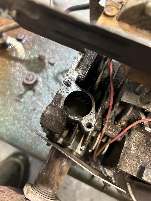

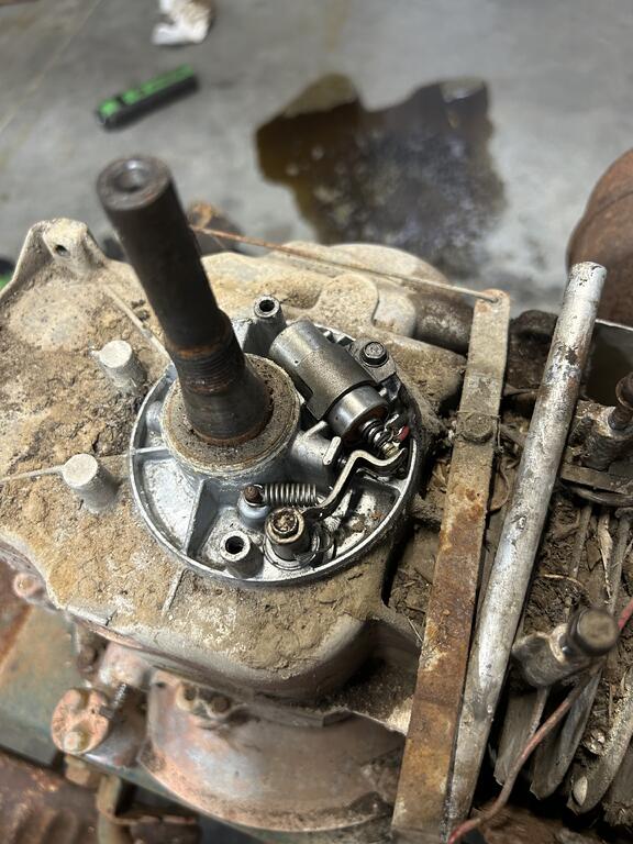

Keaton 466 #7 Posted July 20, 2024 (edited) And the engine is now unstuck, and I got a points kit Edited July 20, 2024 by Keaton 1 Share this post Link to post Share on other sites

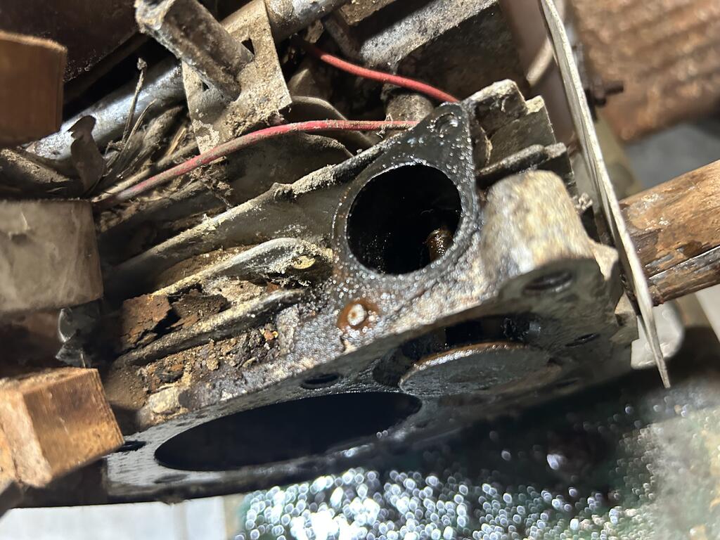

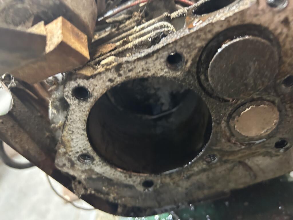

Keaton 466 #8 Posted July 21, 2024 It has spark now and compression I think I fixed the sticky valuve letting it soak in pennatrating oil over night, and that’s abad picture of the spark but it’s there and the intake valuve filled with pennatrating oil Share this post Link to post Share on other sites
