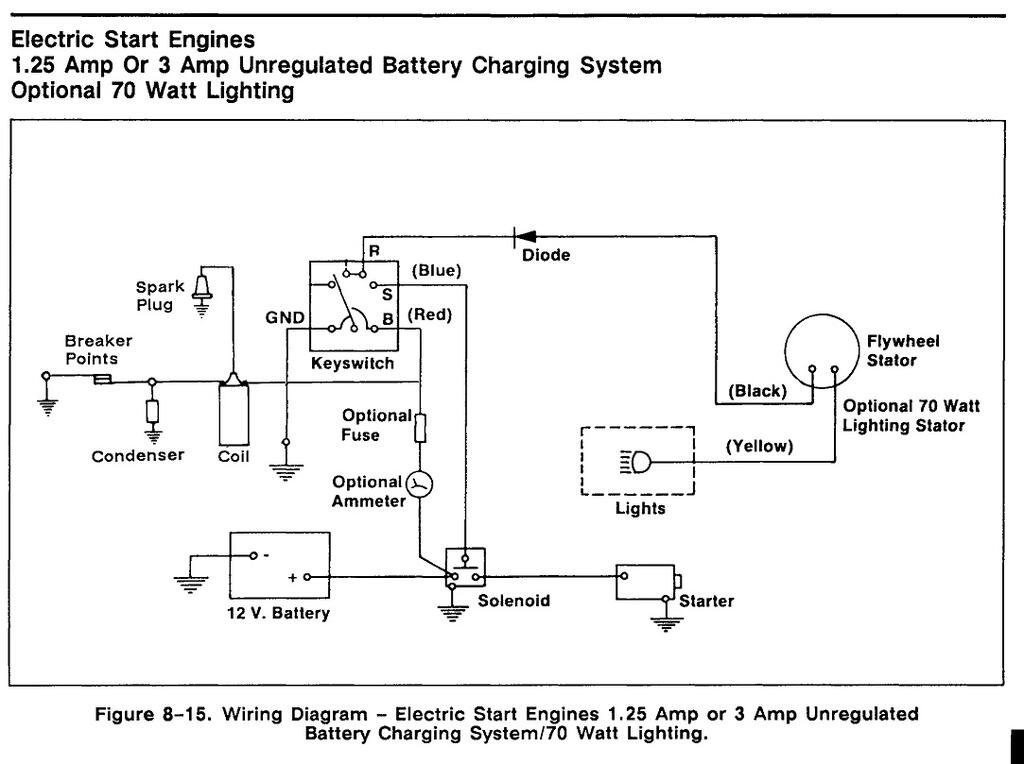

snowhound 106 #1 Posted July 18, 2024 (edited) Looking for a wiring diagram that shows the details of the diode on the white wire of the mag on a 1997 418-8. Edited July 18, 2024 by snowhound Share this post Link to post Share on other sites
gwest_ca-(File Mod) 11,848 #2 Posted July 18, 2024 From the Kohler service manual 1 1 Share this post Link to post Share on other sites
