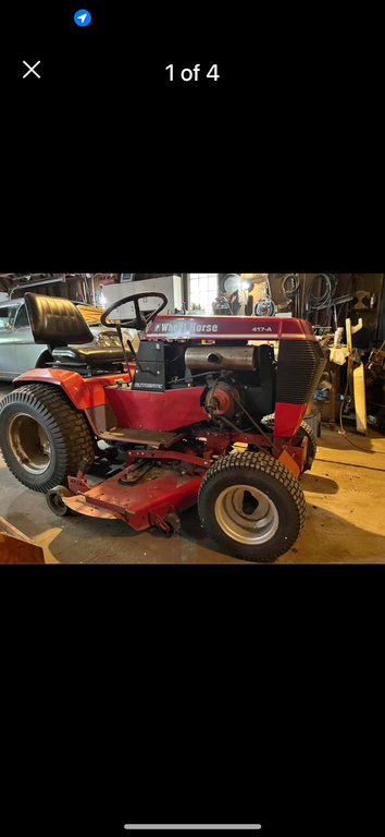

stevebo-(Moderator) 8,604 #1 Posted July 12, 2024 All- I am picking up a 417 A tomorrow. Older seller said he was driving it and tranny locked up. He can roll back a little and when going forward he goes about 5’ and it locks up. It has only 800 hours and looks to me in good cosmetic condition. My question is has anyone had this type of issue with a 417 or any hydro with Eaton 1100? Lastly if tranny is freely broke I have a low hour tranny out of a 520. That too is an 1100. I guess I can swap that in but want to check with all if anyone has this issue before and anything simple to check for? 1 Share this post Link to post Share on other sites

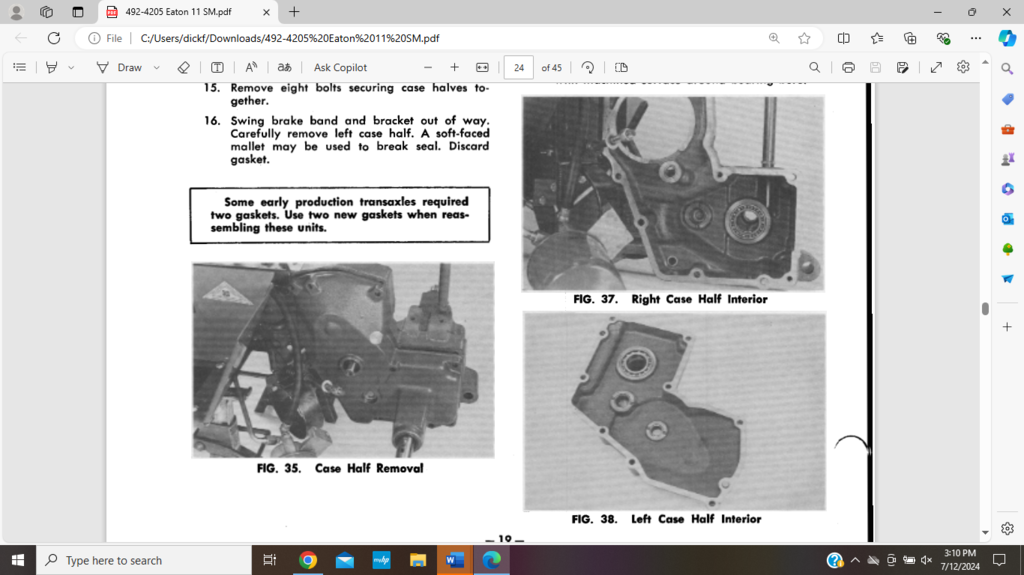

953 nut 64,261 #7 Posted July 12, 2024 7 hours ago, squonk said: The small half is the pump. If it's the differential the whole ball of wax has to come out. Swap the 520 trans in and then if you feel like it tear down the other and find the issue. Mike, the Right Half (transaxle half that bolts to the frame) is the half that has the pump. Some of the bolts through the pump will be removed but not all of them. See page 18 steps 10 to 17 of the manual. Share this post Link to post Share on other sites

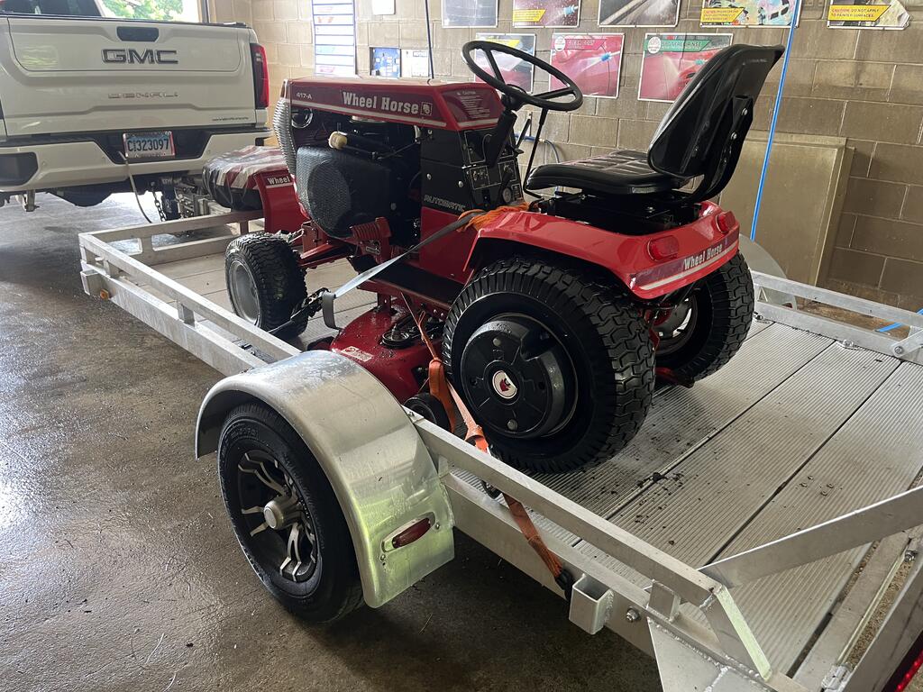

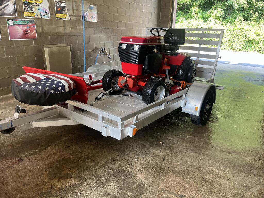

stevebo-(Moderator) 8,604 #12 Posted July 13, 2024 Picked this up yesterday in Albany area off second owner. Once I figure out the tranny issue it will be a great machine. Got plow and deck with wheel weights with it. Added new battery and fresh fuel and she fired up perfect 1 5 Share this post Link to post Share on other sites
