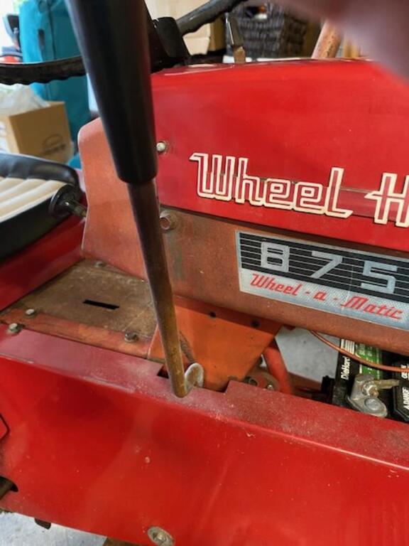

Pogo 57 10 #1 Posted July 11, 2024 Just bought back my 875. The speed adjustment lever is very loose, not staying in selected speed. Is there an adjustment to tighten it up? Tractor also creeps when pedal is depressed. Thanks Share this post Link to post Share on other sites
rmaynard 16,658 #2 Posted July 11, 2024 (edited) The adjustment is explained in the owners manual. If you don't have one, you can download one from the manuals section. Edited July 11, 2024 by rmaynard Share this post Link to post Share on other sites
pfrederi 19,131 #4 Posted July 11, 2024 Look at this manual also. Clearer pictures The wheel a matics used two small springs to put tension on the plastic slider and thus try to hold the control lever. Not a great moment in WH design. Later hydros used a much better cone/spring design to keep the control lever from moving. Share this post Link to post Share on other sites
Mike'sHorseBarn 3,364 #5 Posted July 11, 2024 Keith, if you can't get it figured out I can adjust it for you at the centre hall show this fall. Share this post Link to post Share on other sites
squonk 44,813 #6 Posted July 11, 2024 I replaced the slotted screws that hold the tension plates on my 1075 with slightly longer Allen head screws with small flat washers to get a little more tension. 2 Share this post Link to post Share on other sites
