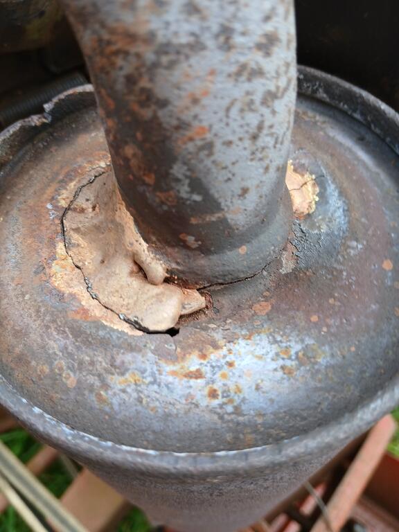

goldeagle 31 #1 Posted July 5, 2024 With the ongoing issues on my K341 engine I have been concerned it is overheating. Finally got around to taking a temp reading (using one of those non-contact IR sensors) and after running the tractor for 3 or 4 minutes (with PTO on) the hottest part of the engine was the exahust/muffler (if that's the right term) which is hitting about 600 Degrees C (1112 Deg. F). Is that an acceptable temperature or does it suggest there is an issue with overheating? Whether or not i makes any difference but the exhaust/muffler has a crack in it which appeared recently and fairly certain it has something to do with the heat, but could be wrong Share this post Link to post Share on other sites

goldeagle 31 #5 Posted July 5, 2024 1 hour ago, ri702bill said: There have been posts here in the past that show the muffler inlet (tube, not pipe) glowing red at night. Richening up the mix helps. Too lean can cause ehhaust valve damage. As can having the exhaust valve clearance to the tappet too tight - the valve cannot shed the heat to the seat... A chunk of unburned carbon caught on the seat under the valve will do that too. Ever had the head off to de-carbon it per the Kohler schedule???? I had the head off a while back when I had to replace the exhaust valve (previous one bent after screw came lose and ended up in the head), so it is a new valve, and checked tappet clearance at the time. Will spend some time working on the card adjustments and see if that helps. Muffler has got a big old crack that appeard recently which I will have to repair 1 Share this post Link to post Share on other sites
8ntruck 8,376 #6 Posted July 5, 2024 That crack looks like it started in an area of rust. The rust thinned the metal and operational vibration probably opened the crack. Exhaust heat helps accelerate the rust formation. 2 Share this post Link to post Share on other sites
oliver2-44 11,076 #7 Posted July 5, 2024 Looks like someone has done a braze repair around part of that in the past. brass and steel don't mix, so you may have to continue using braze for at leas part of the repair. The rust on the inside of that will make it a challenging repair no matter what type weld you use. if you have access to metal forming equipment fashioning a large cone shaped washer to go from the pipe (over the crack) maybe all the way to the outer crimp area. 1 Share this post Link to post Share on other sites
