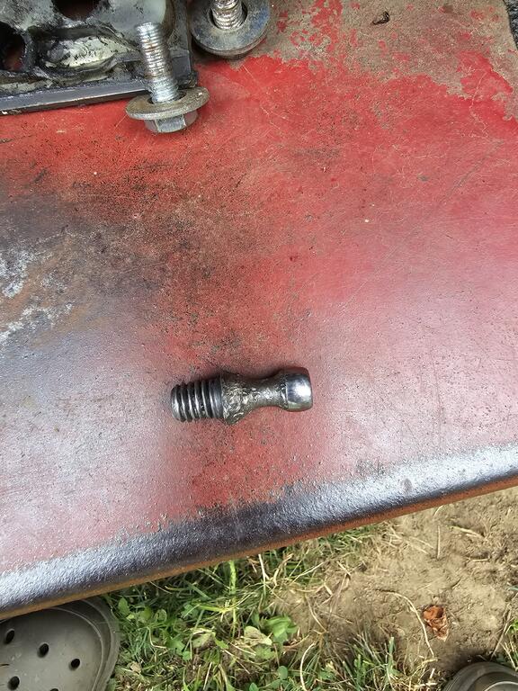

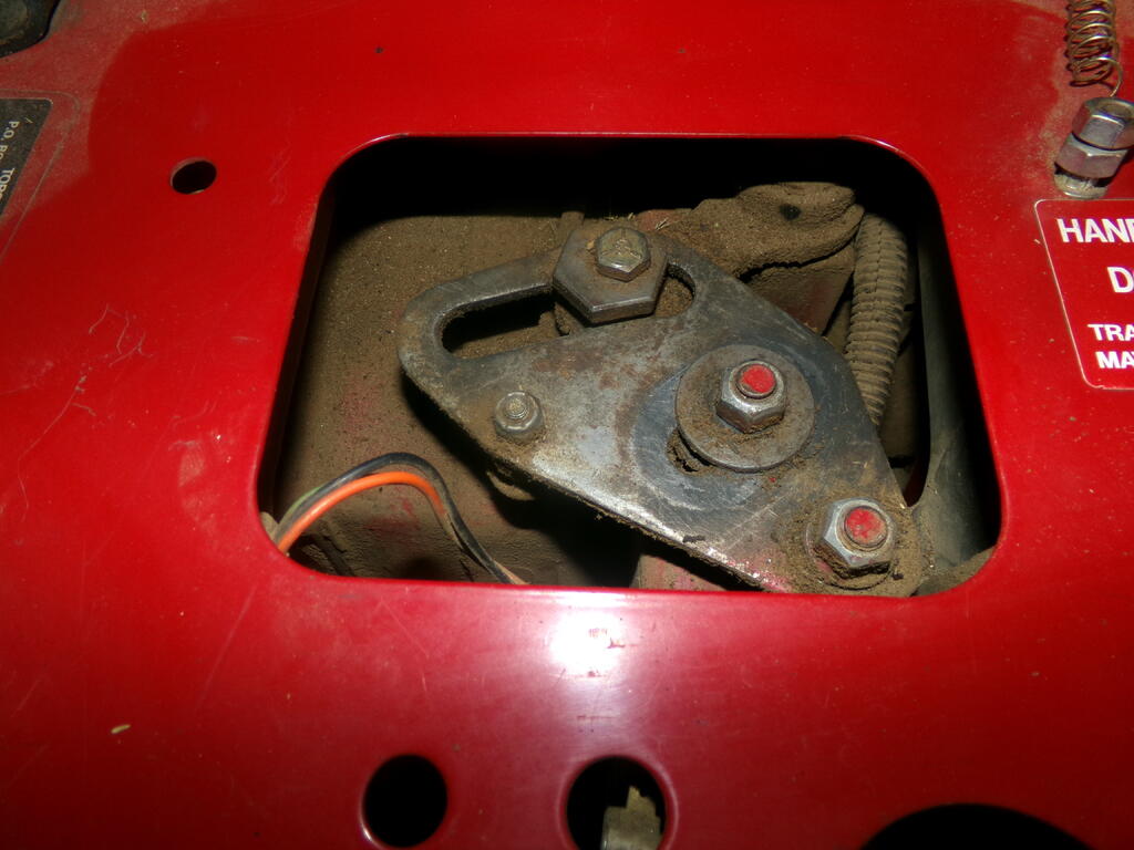

osubrutus1 3 #1 Posted June 28, 2024 I have a C-175 and have had to replace the cam plate several times over the years. I especially have issues when the tractor is on a hill with a bit of a twist to it, the lever jams because the cam block pin pulls out of the cam block then it is stuck in reverse. the only thing I can do at that point is turn off the tractor. I would appreciate any advice or modifications that would help. Share this post Link to post Share on other sites

Ed Kennell 44,986 #5 Posted June 29, 2024 (edited) 20 hours ago, osubrutus1 said: the cam block pin pulls out of the cam block Can you post a picture of this pin ? This is one of my Eaton 1100 cam plates. I don't see how it would be possible for a pin to pull thru the cam plate. Edited June 29, 2024 by Ed Kennell 1 Share this post Link to post Share on other sites
peter lena 9,778 #6 Posted June 29, 2024 @osubrutus1 only a suggestion , take advantage of the failure point , get a helper to visibly look things over at that point. would also like to see a related picture to hang up . have seen so many , rusty / crusty . cracked / binding areas . think your twist frame / linkage related set up is your answer. that pin pull out is your lead, sheared bolt / related to twist . another set of eyes , always helps , pete 1 Share this post Link to post Share on other sites

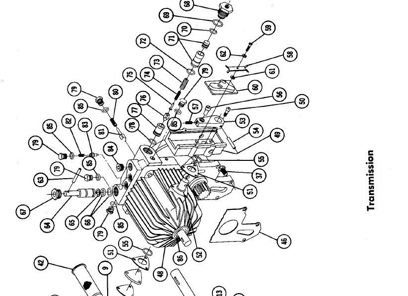

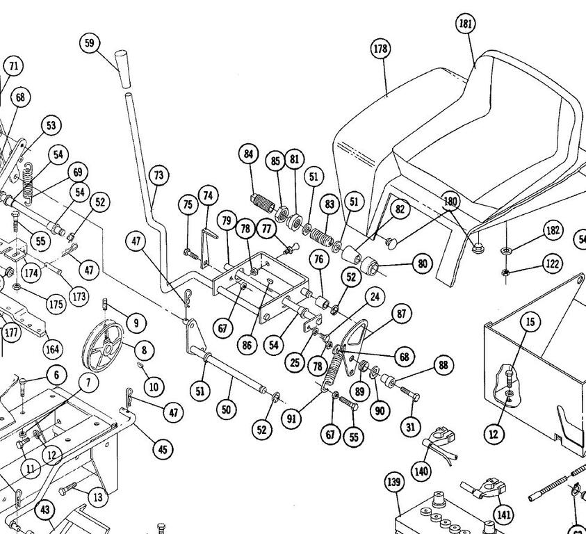

pfrederi 19,940 #8 Posted June 30, 2024 Some early C-175 had Sunstrands. Is that what you have (Tranny filter on right side of transaxle??) If so check for any wiggle in the cross shaft #79 the bushing # 54 maybe worn out. The pic you posted is #77. Any cracks in the plastic slider #60 pic 2 4 Share this post Link to post Share on other sites
