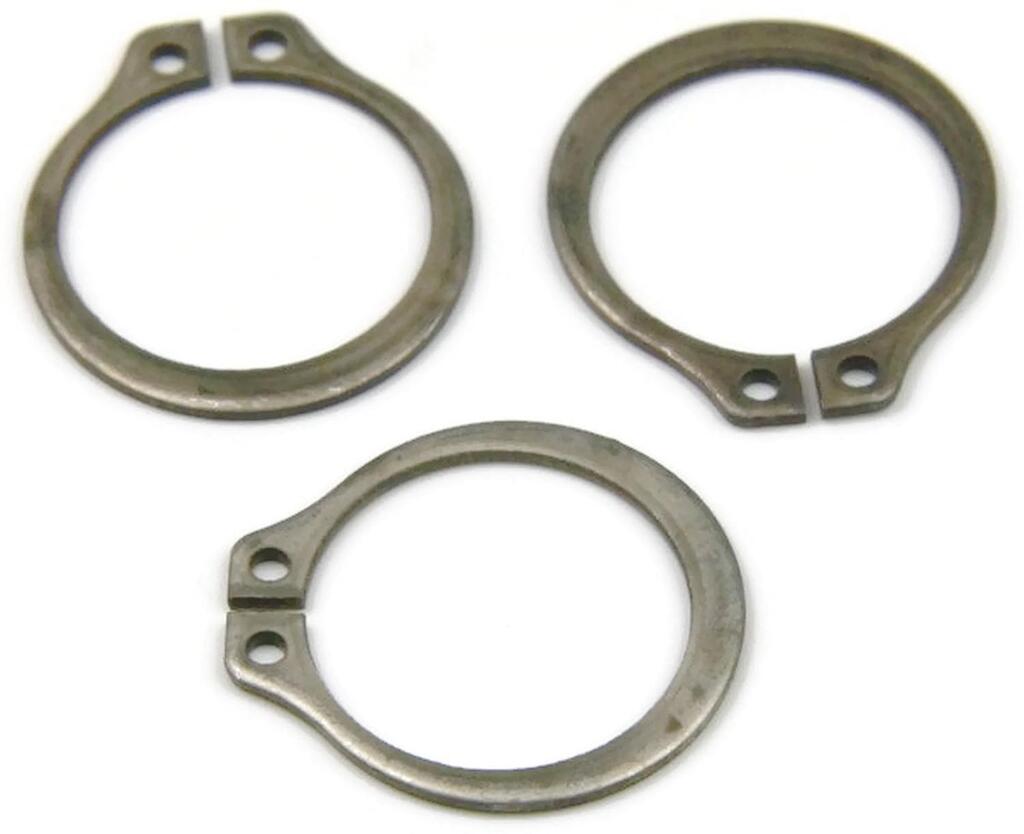

Kelsey 91 #1 Posted June 26, 2024 Greetings, What size do I need from the local hardware store for a Toro 5618 E-ring? Holds the front axle in place for my C-100. Thanks, Kelsey Share this post Link to post Share on other sites
ebinmaine 77,075 #2 Posted June 26, 2024 That should be a 3/4 or .750 inch diameter pin. 1 Share this post Link to post Share on other sites
Kelsey 91 #3 Posted June 26, 2024 7 minutes ago, Kelsey said: Greetings, What size do I need from the local hardware store for a Toro 5618 E-ring? Holds the front axle in place for my C-100. Thanks, Kelsey 24 minutes ago, ebinmaine said: That should be a 3/4 or .750 inch diameter pin. Thank you! 1 Share this post Link to post Share on other sites
Handy Don 15,755 #4 Posted June 26, 2024 55 minutes ago, Kelsey said: 1 hour ago, ebinmaine said: That should be a 3/4 or .750 inch diameter pin. Thank you! Get the heavy duty one, if you can. Wider flanges. 4 Share this post Link to post Share on other sites
953 nut 63,957 #5 Posted June 27, 2024 Also, the ring is stamped, one edge is sharp and the other edge is somewhat rounded, put the rounded side toward the axle so the sharp edge will bite into the shaft when pressure is applied by axle movement. 1 Share this post Link to post Share on other sites
Kelsey 91 #6 Posted June 27, 2024 Any installation tips for the clip? Share this post Link to post Share on other sites
rmaynard 16,840 #7 Posted June 27, 2024 (edited) If you use an e-clip, just snap it in place, but I recommend a retaining ring. and install it with these pliers Edited June 27, 2024 by rmaynard 2 Share this post Link to post Share on other sites
