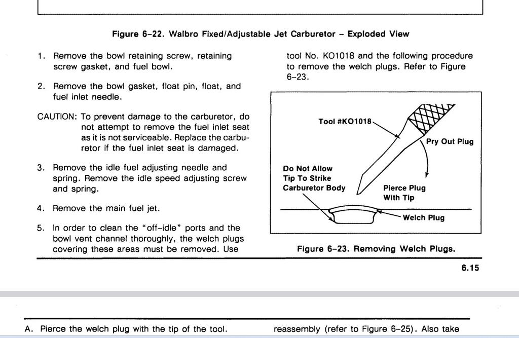

pfrederi 21,046 #26 Posted June 30, 2024 Off idle port and Bowl vent. Look a the Kohler K series manual it covers Walbros 1 Share this post Link to post Share on other sites
Racinbob 13,111 #27 Posted June 30, 2024 I see the K-Series manual covers Walbros better than the Magnum manual. I'm at a complete loss at what else to do so I just ordered the correct (I hope) kit with new plugs. I go ahead and do another cleaning with those removed and see what happens. I know I said I'd try a Kohler K-341 carb on it but I keep telling myself that this Walbro CAN be fixed. I would rather do that than a carb swap. Subject to change................................ Share this post Link to post Share on other sites
Handy Don 17,316 #28 Posted June 30, 2024 Cavities and channels covered by Welch plugs can, and often do, harbor crud. My Onan P218 underwent three cleanings (two with ultrasonic) without success before I relented and removed the Welch plug. Yep, crud. Fourth time and it purrs. 2 Share this post Link to post Share on other sites

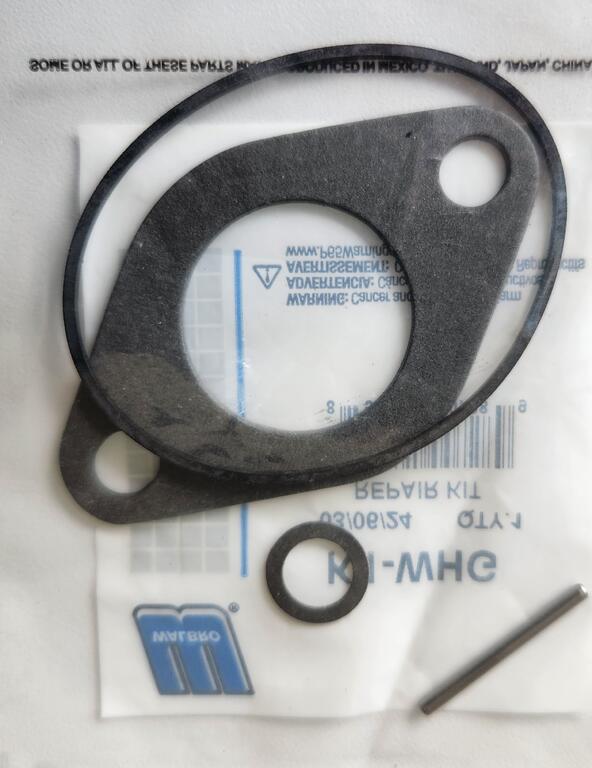

Racinbob 13,111 #37 Posted July 5, 2024 Well guys, the carb kit came today. What's wrong with this picture? Share this post Link to post Share on other sites
ebinmaine 80,279 #38 Posted July 5, 2024 42 minutes ago, Racinbob said: Well guys, the carb kit came today. What's wrong with this picture? Did you want a needle n seat? Share this post Link to post Share on other sites
Racinbob 13,111 #39 Posted July 5, 2024 8 minutes ago, ebinmaine said: Did you want a needle n seat? Thanks Eric but I should be fine. I sent the guy a message and within 10 minutes he got back to me with an apology and assurance a FULL kit will be on its way. Since I have the tractor apart I'm doing everything including a Mr Gasket fuel pump like I use on my 2005 Classic. In the meantime I get to play with the B80 to B160 to B80 tractor. I won't complain about the seat time tomorrow either. I need to mow and this time with only with one tractor. 1 Share this post Link to post Share on other sites

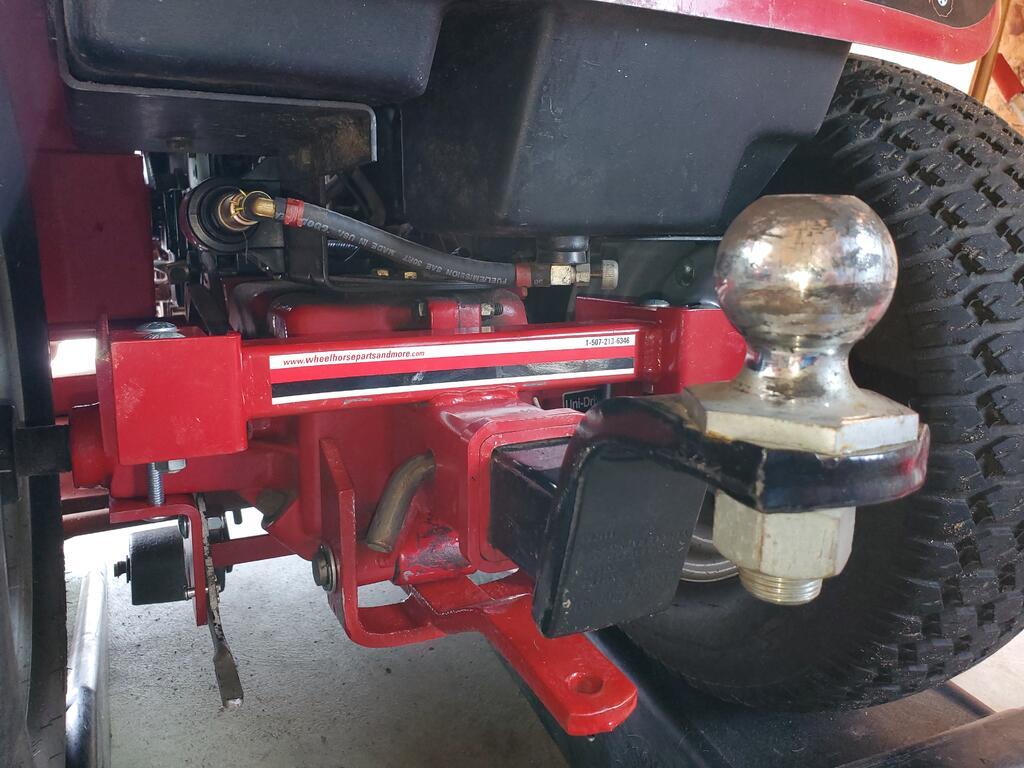

Racinbob 13,111 #40 Posted July 12, 2024 The seller was quick to send me another (and complete) kit. I had another semi emergency to take care of so I couldn't get right back on the Walbro. I finally did this morning. Removed the two welsh plugs and did another complete cleaning. Put it all back together and I picked up another Mr. Gasket 42s electric pump like the one on my 2005. I really like where I located it on the 8 speed but obviously that's a no go on the hydro. It looks like just behind the engine is the hot ticket on this one. I found a bracket at Menards yesterday that looks like it was made for it. 4 Share this post Link to post Share on other sites
