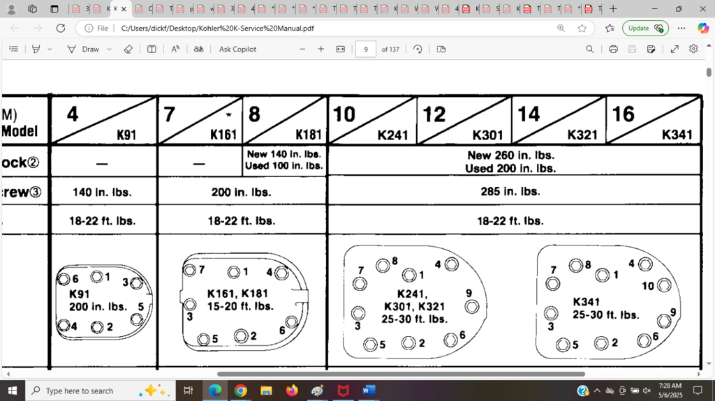

squonk 46,074 #26 Posted May 6, 2025 12 and 14 HP heads will not work. Not enough bolt holes like Eric said. 1 Share this post Link to post Share on other sites
953 nut 65,157 #27 Posted May 6, 2025 Clean and lubricate the head bolts and the threads in the block to obtain a true torque reading. When you torque the head bolts follow the sequence shown below. After the engine has been run up to normal operating temperature let it cool down and then retorque the head bolts using the same sequence. 2 Share this post Link to post Share on other sites
John2189 587 #28 Posted May 8, 2025 On 5/6/2025 at 7:34 AM, 953 nut said: Clean and lubricate the head bolts and the threads in the block to obtain a true torque reading. When you torque the head bolts follow the sequence shown below. After the engine has been run up to normal operating temperature let it cool down and then retorque the head bolts using the same sequence. Thanks for the diagram 1 Share this post Link to post Share on other sites
