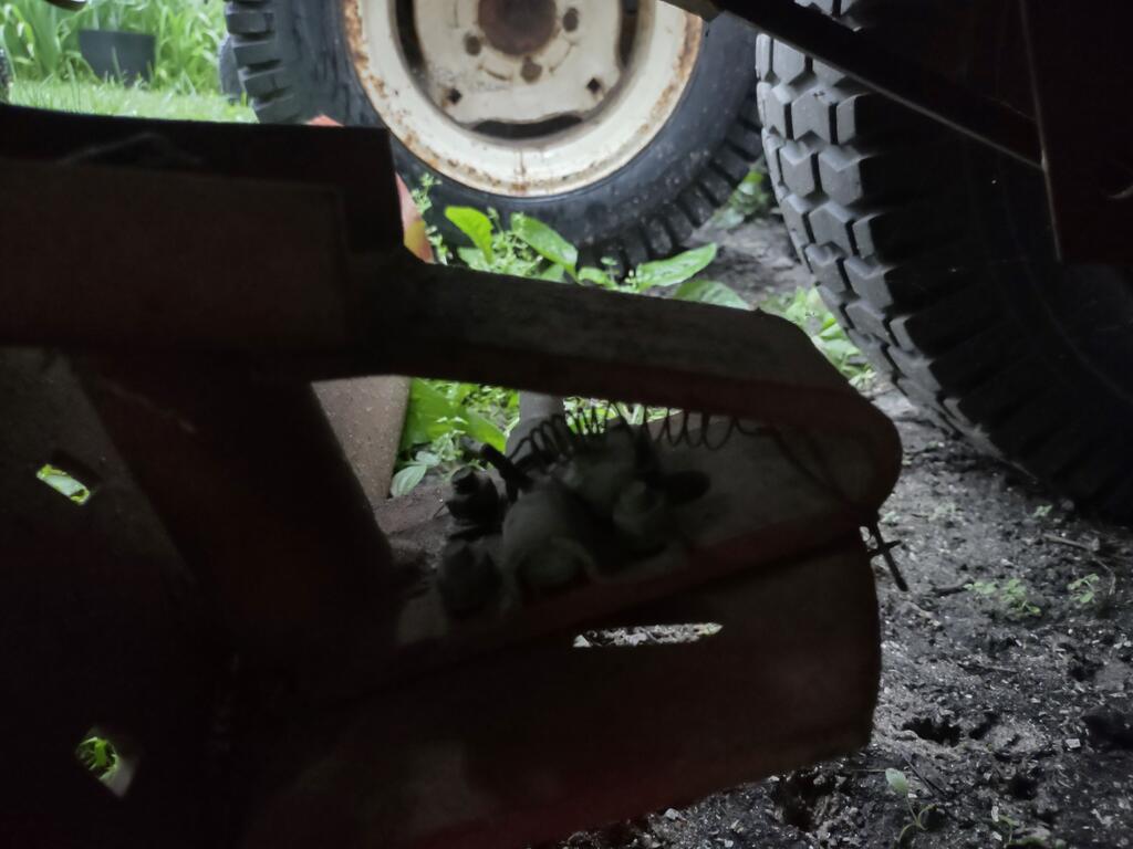

Brockport Bill 2,232 #1 Posted June 22, 2024 Can someone with a WH Grader belly blade measure the spring it has and send me the approximate length and width so I can go try to locally buy a replacement spring?? Grader blade is model # 07-50bm02 - the spring is part # 102572. Just trying to best match its length and tension ---- Thanks, Bill Share this post Link to post Share on other sites
8ntruck 8,634 #2 Posted June 22, 2024 Probably should get the wire diameter of the spring as well. 1 Share this post Link to post Share on other sites
Achto 31,135 #3 Posted June 22, 2024 7 hours ago, Brockport Bill said: Can someone with a WH Grader belly blade measure the spring I assume that you are talking about the spring for the pivot handle. 1 1/2" long by 3/4" o.d. not a real heavy spring, kinda light wire. Don't think that it is real important on the strength, it jut needs to hold the handle up so that it stays locked in. Had to wait for a break in the rain to go take a look at my blade. 5" of rain in the last 3 days & still coming. Share this post Link to post Share on other sites
Handy Don 16,024 #4 Posted June 22, 2024 12 minutes ago, Achto said: 5" of rain in the last 3 days & still coming. Well we show goers had three days at close to 100 with narry a drop of precipitation. Thankfully the humidity was moderate. Springs have so many specifications--fascinating! Tension or compression Number of coils Gauge of wire Wire material ID (or OD) End treatment (ground, open, hook, loop,...) Pounds per inch of displacement For compression: length uncompressed and compressed For tension: length unloaded and at maximum tension 1 Share this post Link to post Share on other sites
Brockport Bill 2,232 #5 Posted June 23, 2024 3 hours ago, Handy Don said: Well we show goers had three days at close to 100 with narry a drop of precipitation. Thankfully the humidity was moderate. Springs have so many specifications--fascinating! Tension or compression Number of coils Gauge of wire Wire material ID (or OD) End treatment (ground, open, hook, loop,...) Pounds per inch of displacement For compression: length uncompressed and compressed For tension: length unloaded and at maximum tension yes Don - - many factors to the best match of a spring to an original WH OEM -- i was hoping a close approximation guess would be enough for me to go to local specialty store and get a variation - that although perhaps not a perfect match but instead would be functional and serve the purpose -- any added insights or specifications anyone could advise would be helpful -- my option is simply spend the $20 at Toro for the proper spring -- was hoping to spend a few dollars less for an imitation bought at a local store??????? thanks, Bill Share this post Link to post Share on other sites

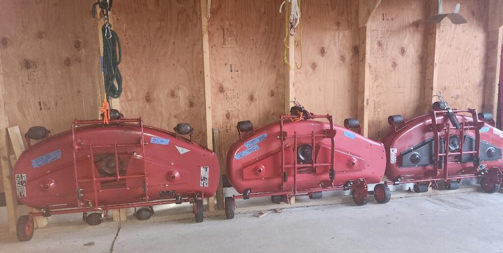

peter lena 9,782 #14 Posted July 12, 2024 @Brockport Bill remember car hood springs ? very easy to adapt , with shackles , used them on a number of issues , incredibly strong for their size , also very good for holding up your cleaned / oiled mower deck up against the wall , over winter , screw in eye bolt , spring , make up an S shaped large hook , easily grabs deck lift linkage , been doing that for years , pete Share this post Link to post Share on other sites
Brockport Bill 2,232 #15 Posted July 12, 2024 2 hours ago, peter lena said: @Brockport Bill remember car hood springs ? very easy to adapt , with shackles , used them on a number of issues , incredibly strong for their size , also very good for holding up your cleaned / oiled mower deck up against the wall , over winter , screw in eye bolt , spring , make up an S shaped large hook , easily grabs deck lift linkage , been doing that for years , pete always enjoy your ideas and suggestions Pete -- i have been using screw hooks to screw into shed wall studs -- then the twisty plastic covered twist ties to secure the mower decks to the shed wall hooks -- work pretty well but auto hood springs makes sense as option -- Bill 1 Share this post Link to post Share on other sites
peter lena 9,782 #16 Posted July 12, 2024 @Brockport Bill looks good to me , storage was always an issue , so gaining / finding a better spot , is always good . like a 5/16 / 1/4" solid round rod bent into a large S shape for easy hook up . pretty scary , sharing an idea . do a similar spring hold to plow / frame , blade on floor , against floor framing , held in place with similar spring set up . makes inspections , improvements , easy , thanks , pete Share this post Link to post Share on other sites
