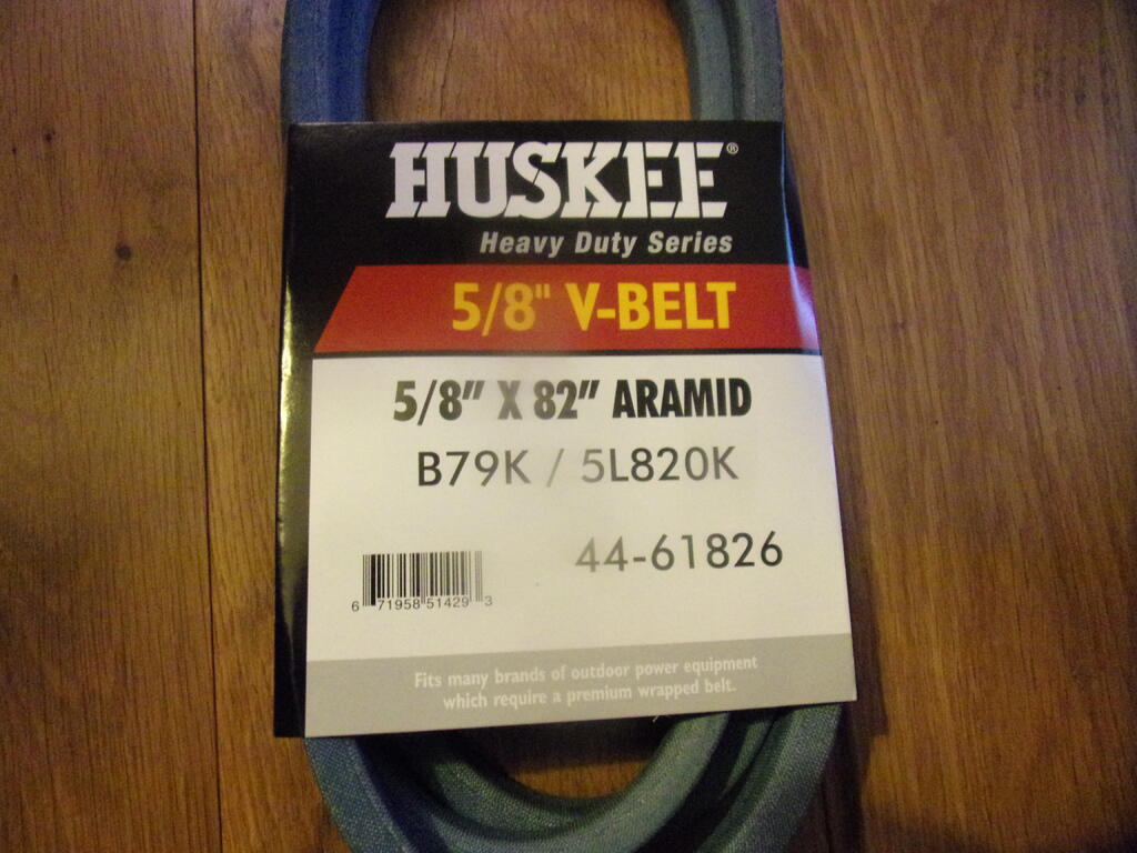

Ed Kennell 43,481 #5 Posted June 22, 2024 Yeah, the belt does vibrate a bit as the engine pulley touches and releases the belt. Should not be a problem for the tractor, just an irritation for the operator. A new kevlar wrapped belt may help. I've had good luck with the TSC belts. 1 Share this post Link to post Share on other sites

JP56 42 #9 Posted June 28, 2024 On 6/22/2024 at 10:54 AM, Ed Kennell said: When the clutch is depressed, the belt should not be moving. Does it grind when you shift gears? Here's a video of a 310-8 belt and pulley arrangement. You can see the belt is locked from moving when the clutch is depressed. Ed, can you read & give me the numbers & make of the belt on your tractor in this video please, or is it the same one shown in 2 posts above this one? That is the belt I have on mine right now & it is really bouncing & slapping around, driving me crazy. Share this post Link to post Share on other sites
Ed Kennell 43,481 #10 Posted June 28, 2024 (edited) 8 hours ago, JP56 said: Ed, can you read & give me the numbers & make of the belt on your tractor in this video please, or is it the same one shown in 2 posts above this one? That is the belt I have on mine right now & it is really bouncing & slapping around, driving me crazy. It is the TSC belt shown in the pic. I suggest you closely inspect all three pulleys in the loop. Look for something stuck deep in the VEE of the engine or transmission pulleys. I have found small stones and twigs imbedded in the pulleys that cause a belt to bounce. Another cause can be a bad bearing in the tension pulley or a worn hole in the frame that supports the idler cross shaft or a weak spring that tensions the idler . I should add that a new belt will slap until it is used and stretched enough to remove the memory of the bends caused by the folds from the long storage in the packaging sleeves. This is especially true with the heavier wrapped 5/8" drive belts. You can see some of this in the belt in my video. This is a brand new belt and after mowing with this tractor, this vibration is gone. Edited June 28, 2024 by Ed Kennell Share this post Link to post Share on other sites
